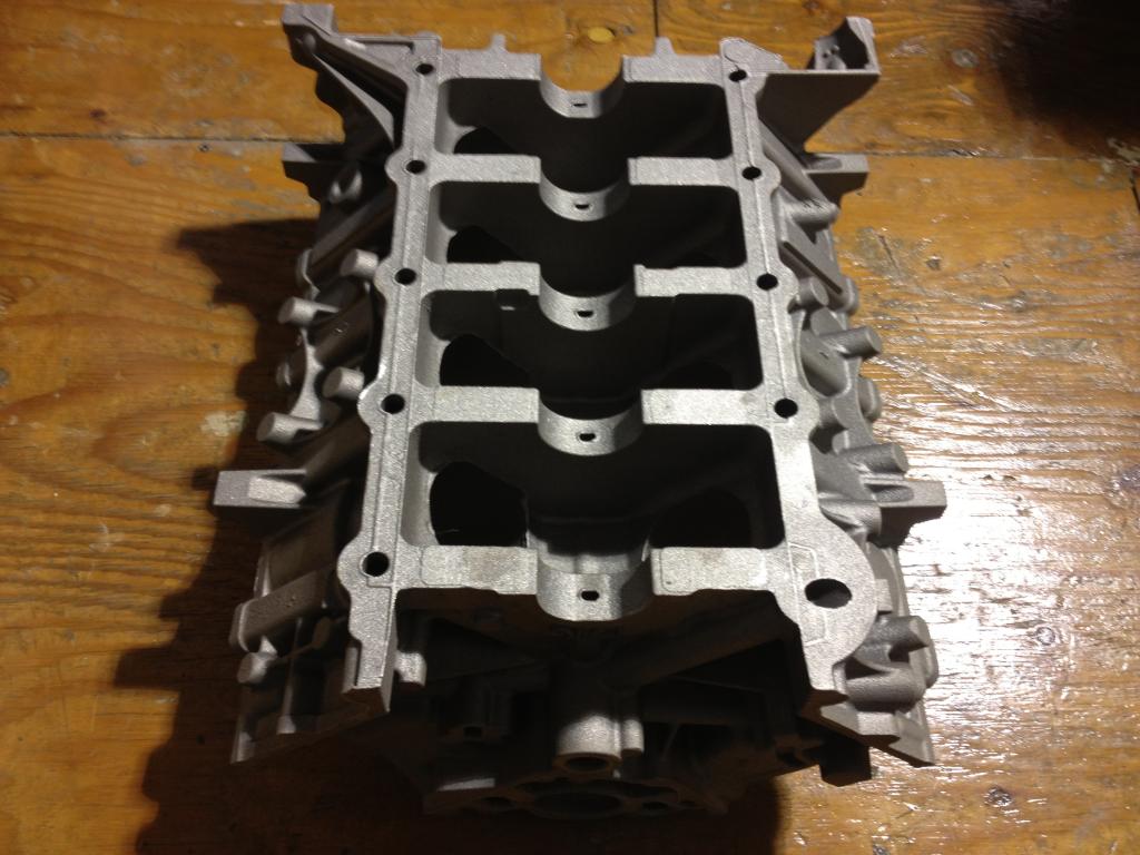

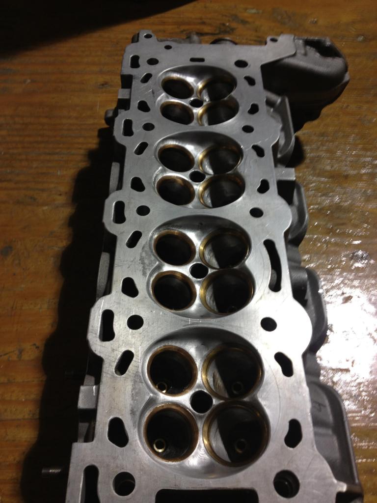

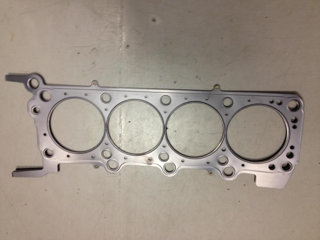

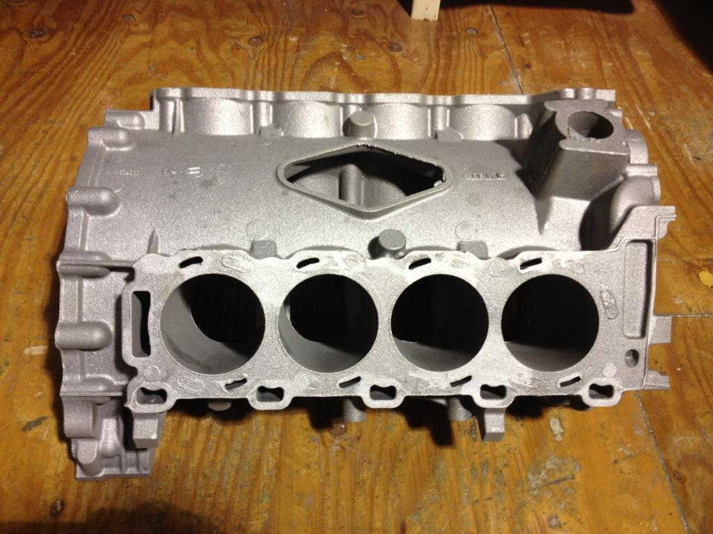

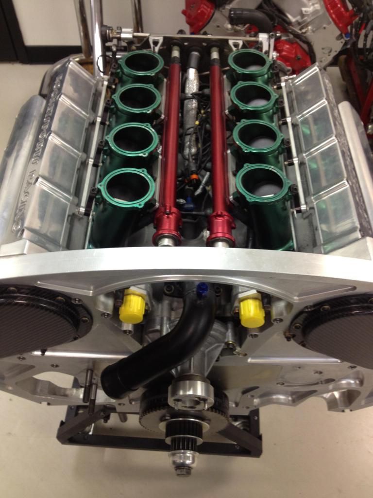

Sounds like it's already sorted, but just for fun:
How to build the best AJ33 possible:
Step #1 - IGNORE CONVENTION!!!
Step #2 - Start with the right parts.....
RSR Performance Casting: 357 T-6 aluminum - HIP'd
Increased Deck and Cylinder Bore wall thickness
Updated Oiling / Cooling path
Billet Aluminum Sump - made from a forged reduction of 6061-T6
Billet Crankshaft
Carrillo Rod / JE piston
CNC Cylinder Head
Steel Head Gasket
Step #3 - build a test engine
Step #4 - Dyno, Dyno, Dyno, and then Dyno some more.
Step #5 - Win Races
Hope this helps.

Anddddd how much is that engine? I am thinking more than what I paid for my car!
Old May 28, 2013 | 10:32 AM
RSR Racing's Avatar
Joined: Apr 2013
Posts: 27
Likes: 39
From: East Lansing, MI

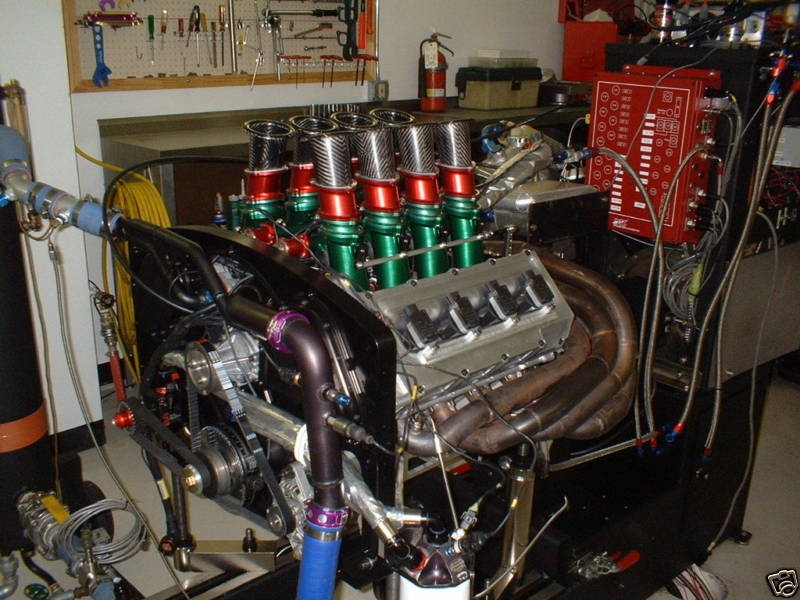

Since all design and machining was done in-house at RSR, its not astronomical.
Full dress engine is around $35k - no electronics
Price comes down substantially without the ITB induction.
And wasn't this the point?
If you were going to build an engine to handle "lots" and lots of boost, say 20 lbs of boost from a KB twin screw, what parts would you use? Crank, rods, pistons, etc. etc. We're talking a "take no prisoners", "there's a new sheriff in town" kind of bottom end.
