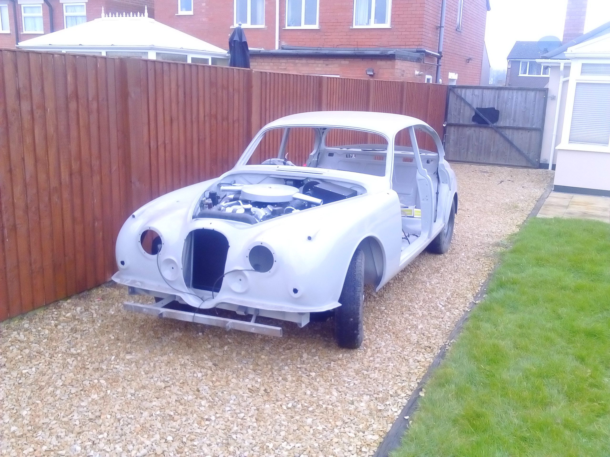

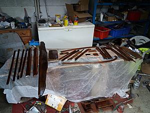

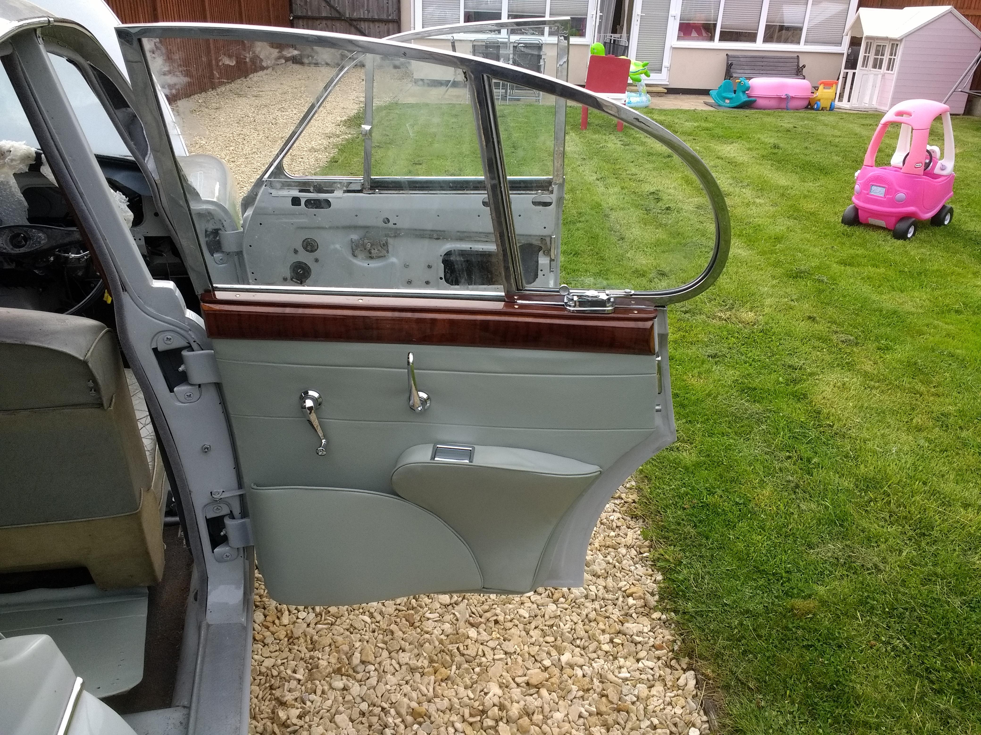

Well its been a while since my last update but things have been proceeding at a pace now and I'm currently working on the interior.
One thing I have found when replacing the headlining is that the tacks need to be on the underside of the tacking strip (I.e. facing the floor) not on the side otherwise the wood won't quite cover them.
I've put a few photos below showing recent progress, still a fair bit to do and I need to find some reasonably priced tyres for it (any suggestions welcome).

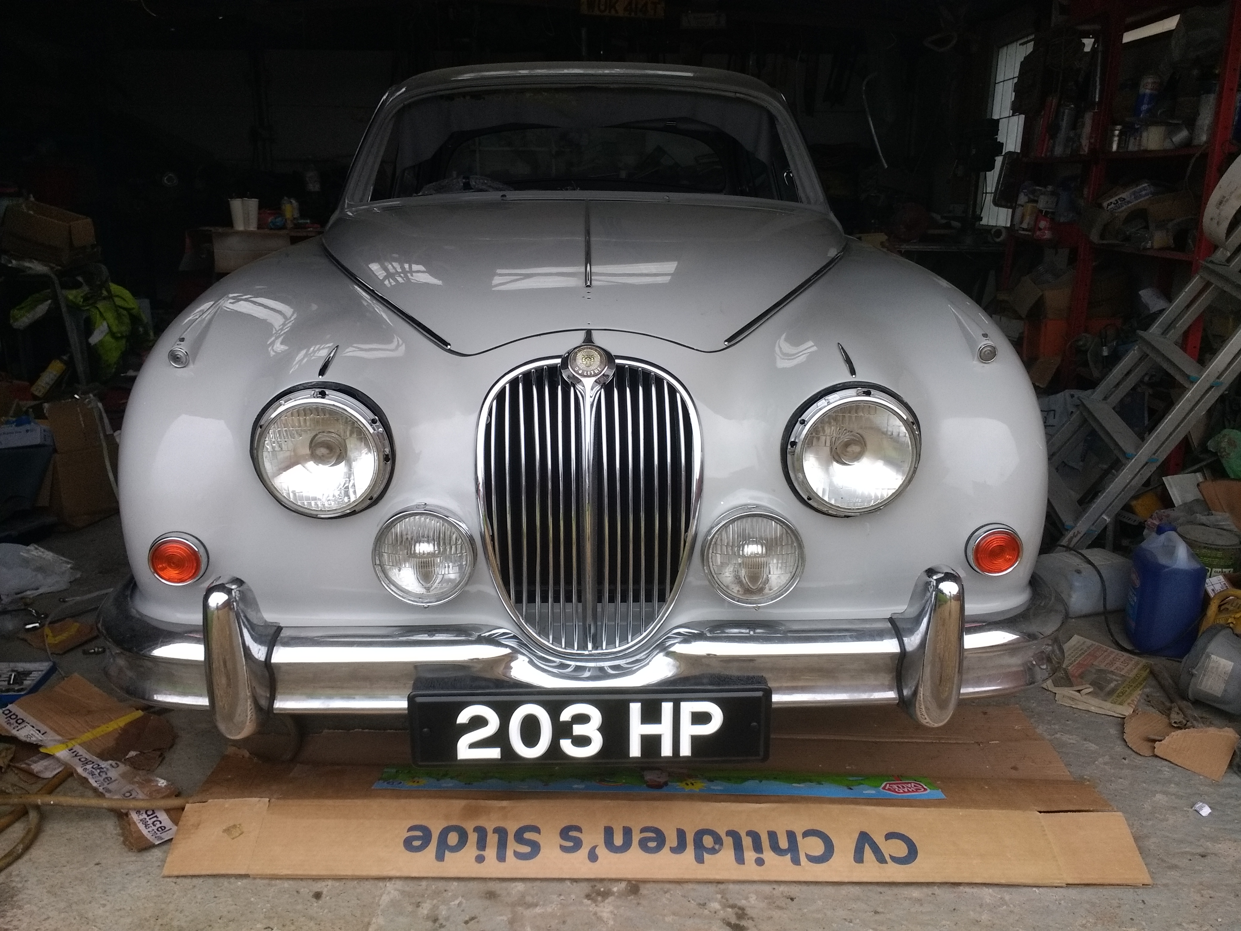

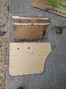

Its been a long time since I last posted, progress has been slow but I have attached a couple of photos of where I am up to at the moment.
Its getting a bit cold for working in the garage now though.

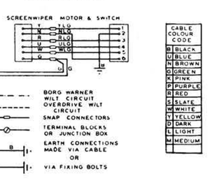

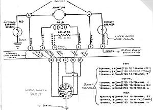

One problem I have been having is wiring up the wiper motor, as the cables into the motor were all old and you couldn't tell the colours I replaced them with the colours in the picture below, I then connected up the motor and switch as per the wiring diagram in the Haynes manual.
Unfortunatly it didn't work so I tested the switch connections to see what they did in each position and then drew out diagrams of how it should work, I found that I needed to swap over terminals 1 and 3 (1 was green and yellow and 3 was red and green) and also terminals 5 and 6 (5 was brown and green and 6 was white and green).
The motor all works now but I would be interested to know whether the diagram I have for the motor colours is wrong or the Haynes manual? Can anyone have a look at their car and wiper motor and let me know?
