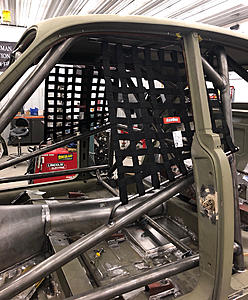

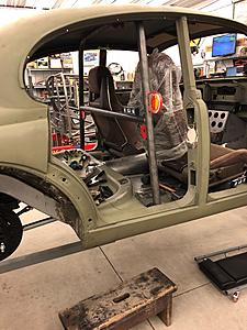

Default Off to the Roll cage shop

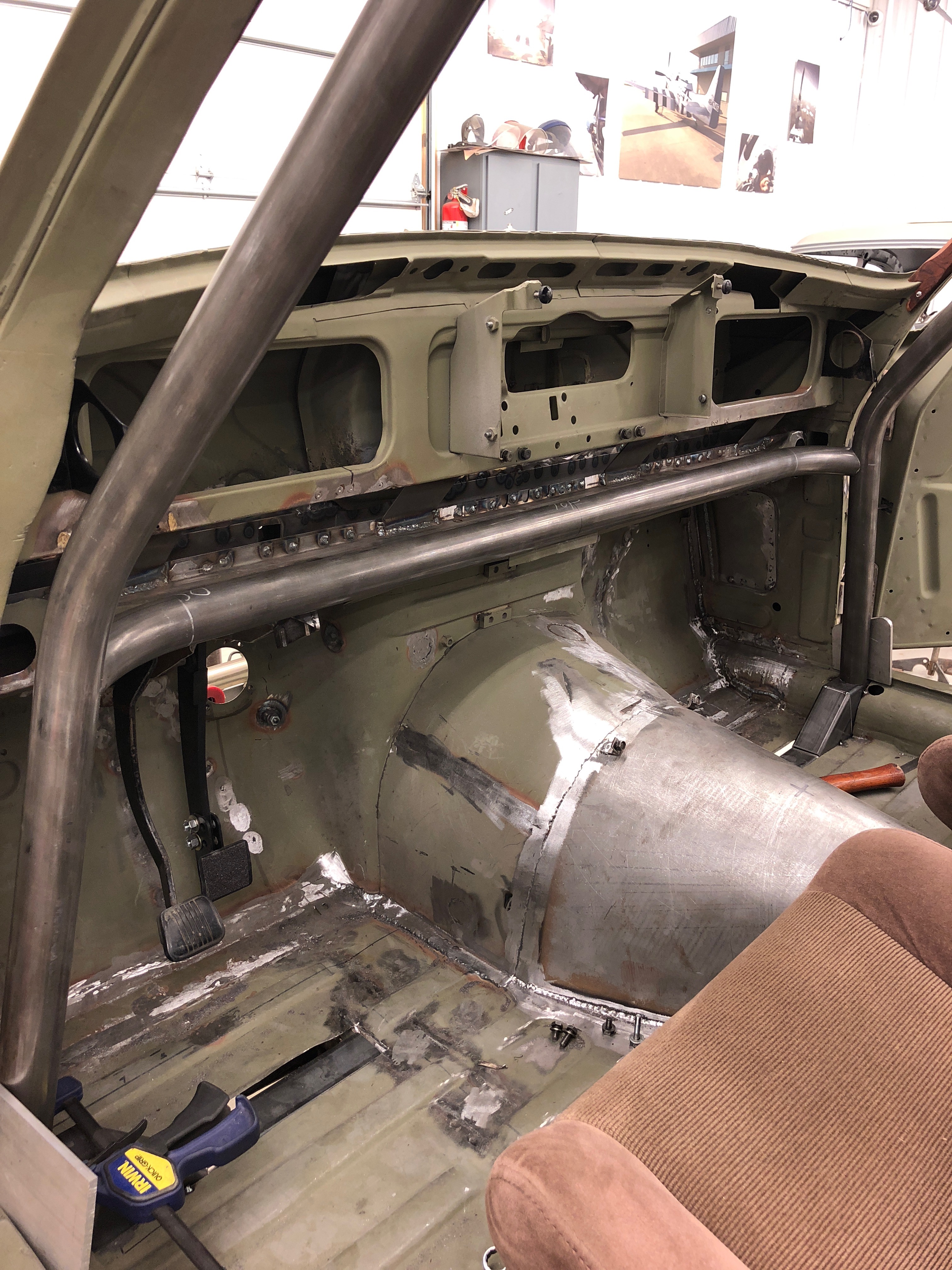

Greetings,

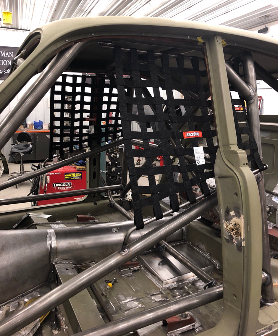

Still in progress. Before the MK2 left for the roll bar shop, the shop owner Gordon, and a friend Mike visited my shop. Mike says " How are you going to get out of this car". I said "what do you mean?". He said "you need a quick disconnect for the steering wheel". I said "Sh&t. I already bought the Moto Lita. Don't know if they make a quick disconnect". Shortened the steering column four inches to make up for the quick disconnect, wheel hub and foot well set back.
Loosing the visors and the visor pockets to move the windscreen bar out of the line of site.
Might be out of the roll bar shop next week.

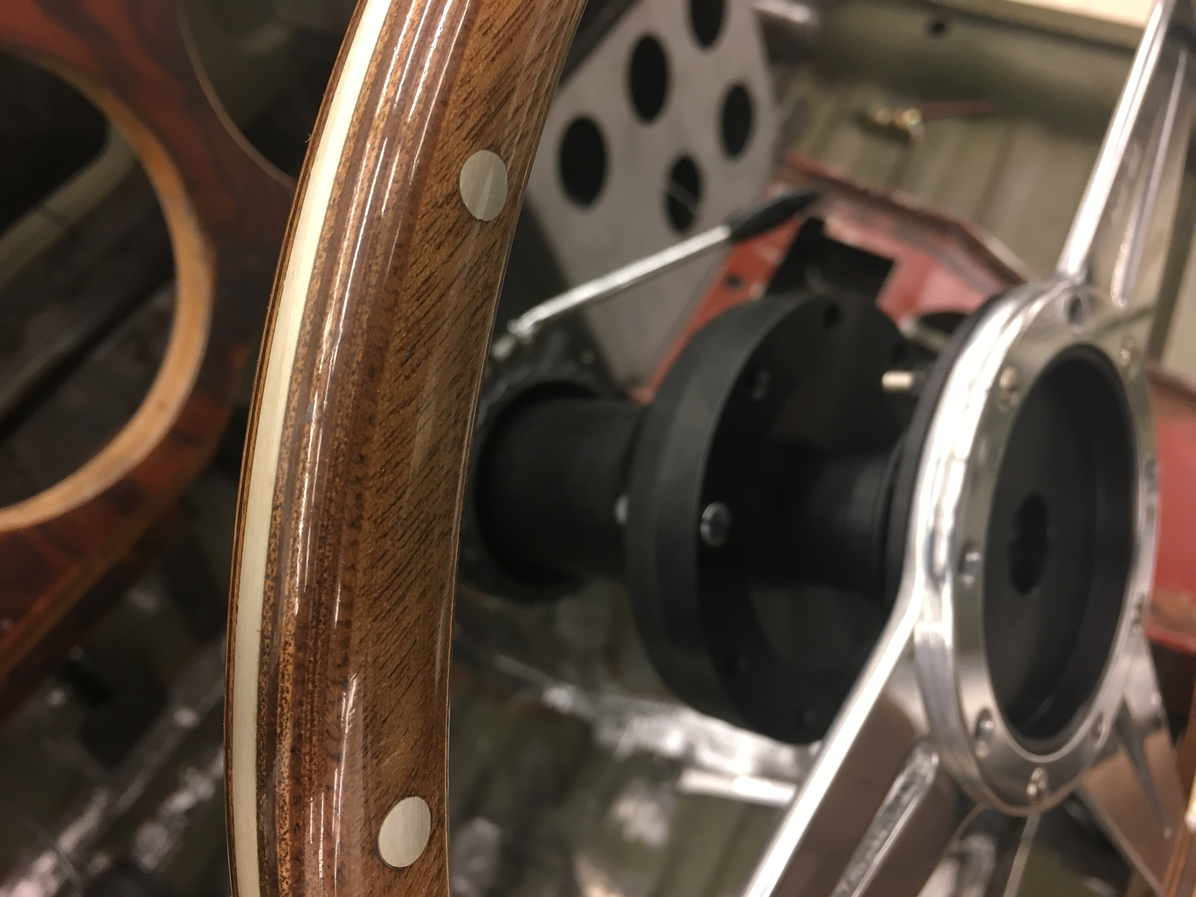

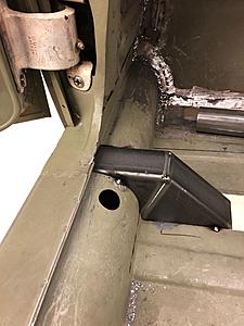

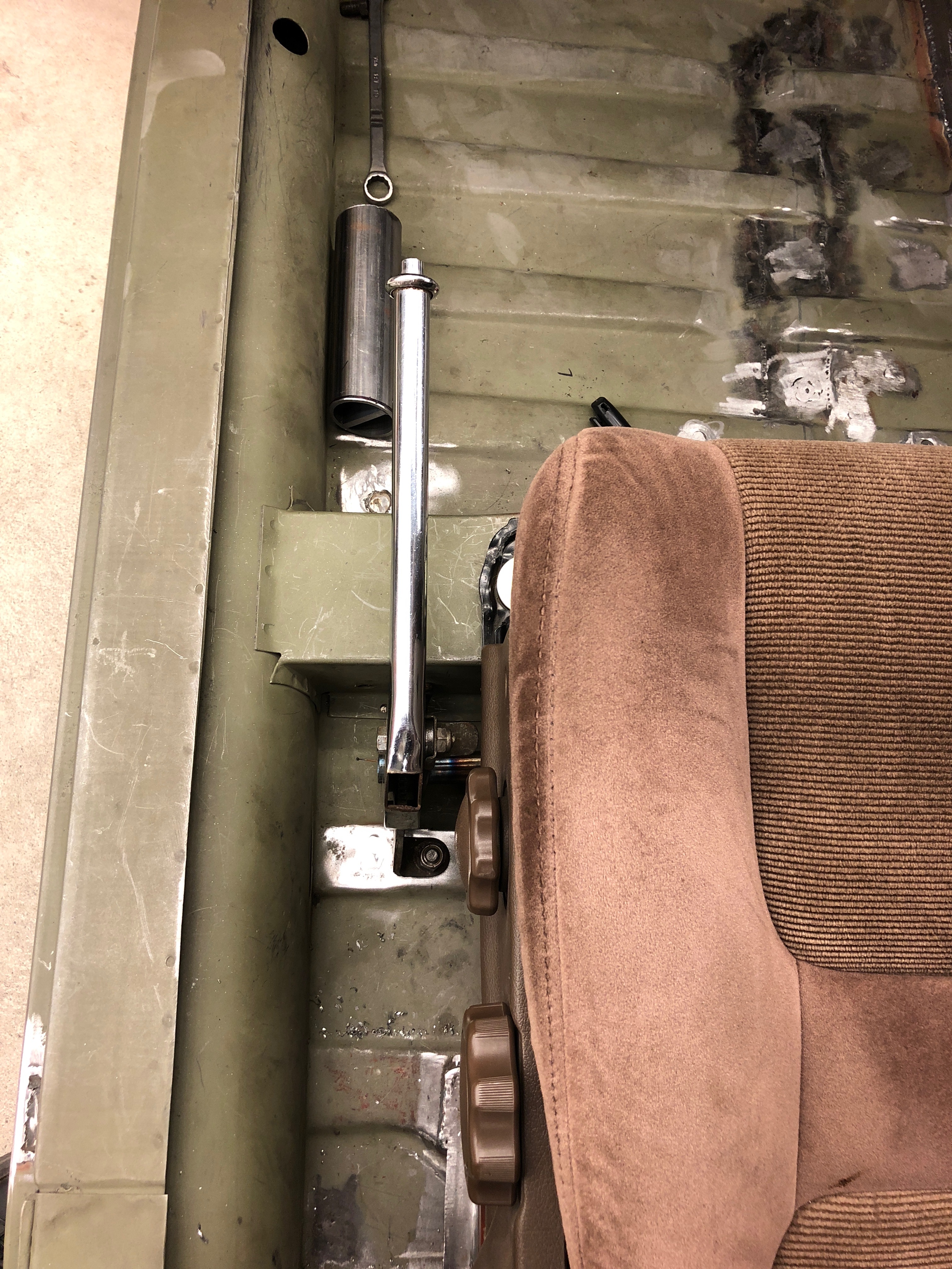

Default Quick Disconnect & E Brake
Greetings,

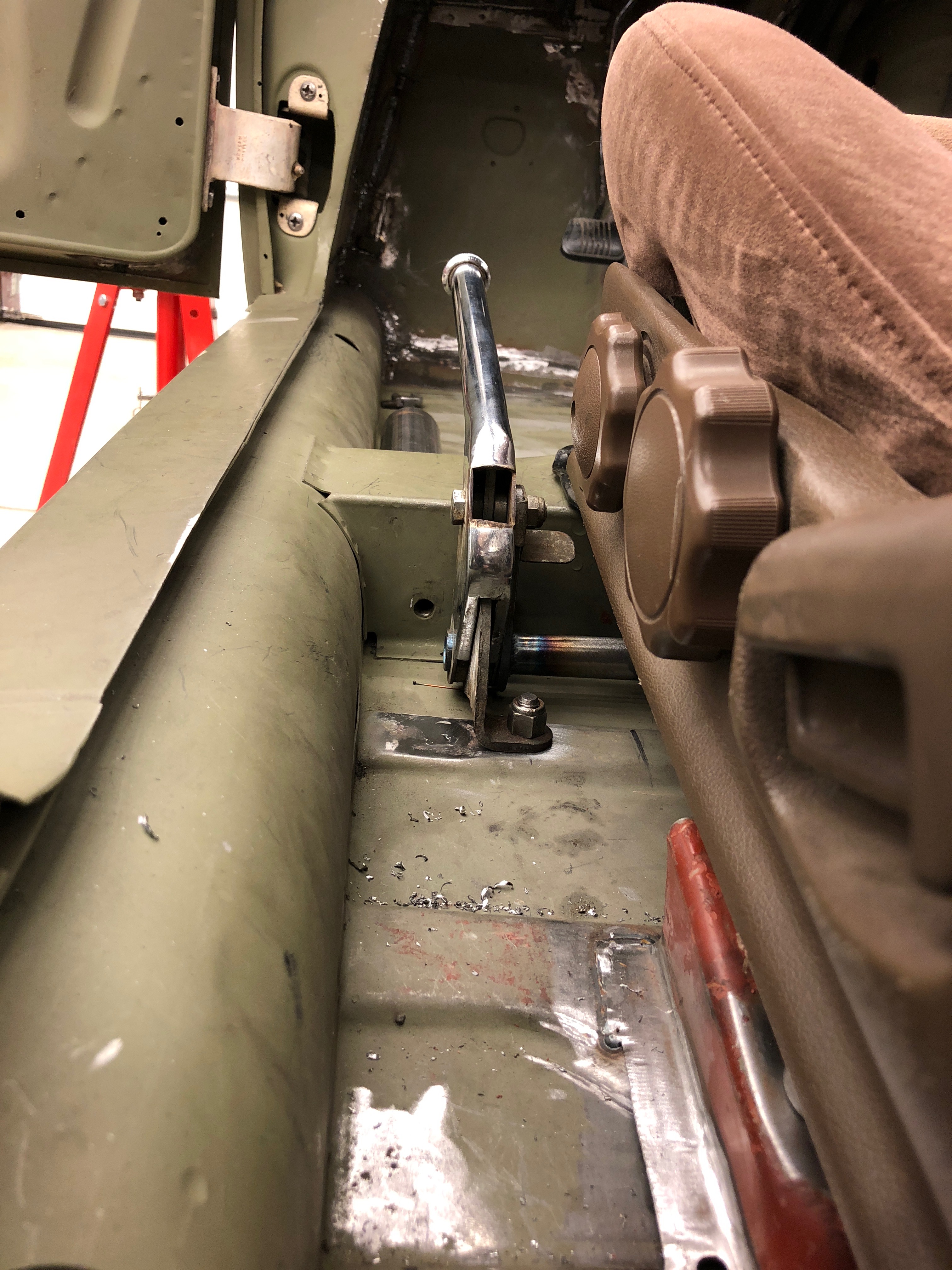

Moved the E Brake lever in 1 1/2" inboard to allow room for the lower door bar.

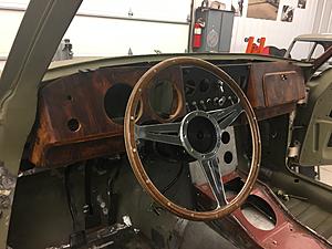

Also included pictures of the steering wheel and quick disconnect.

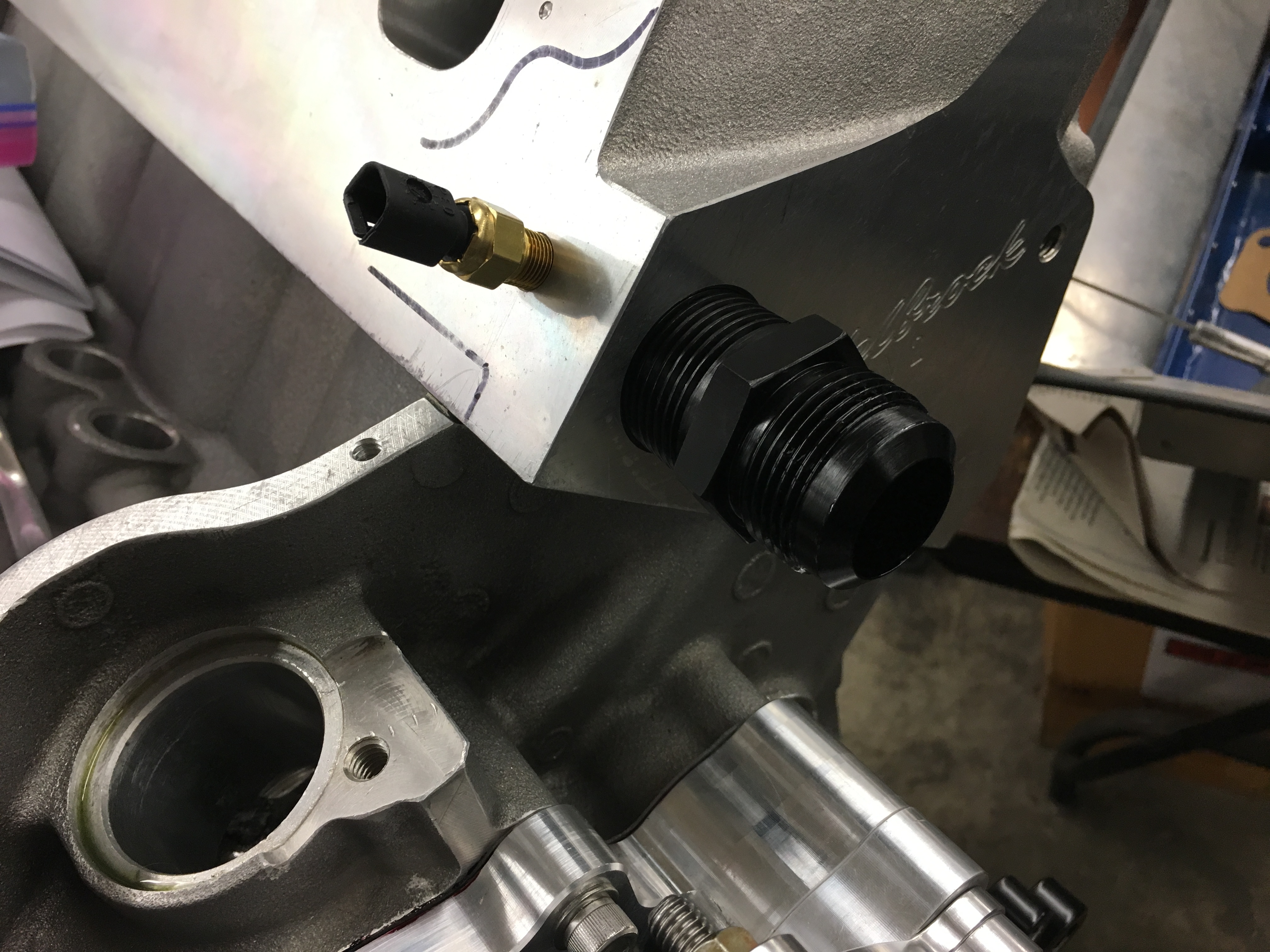

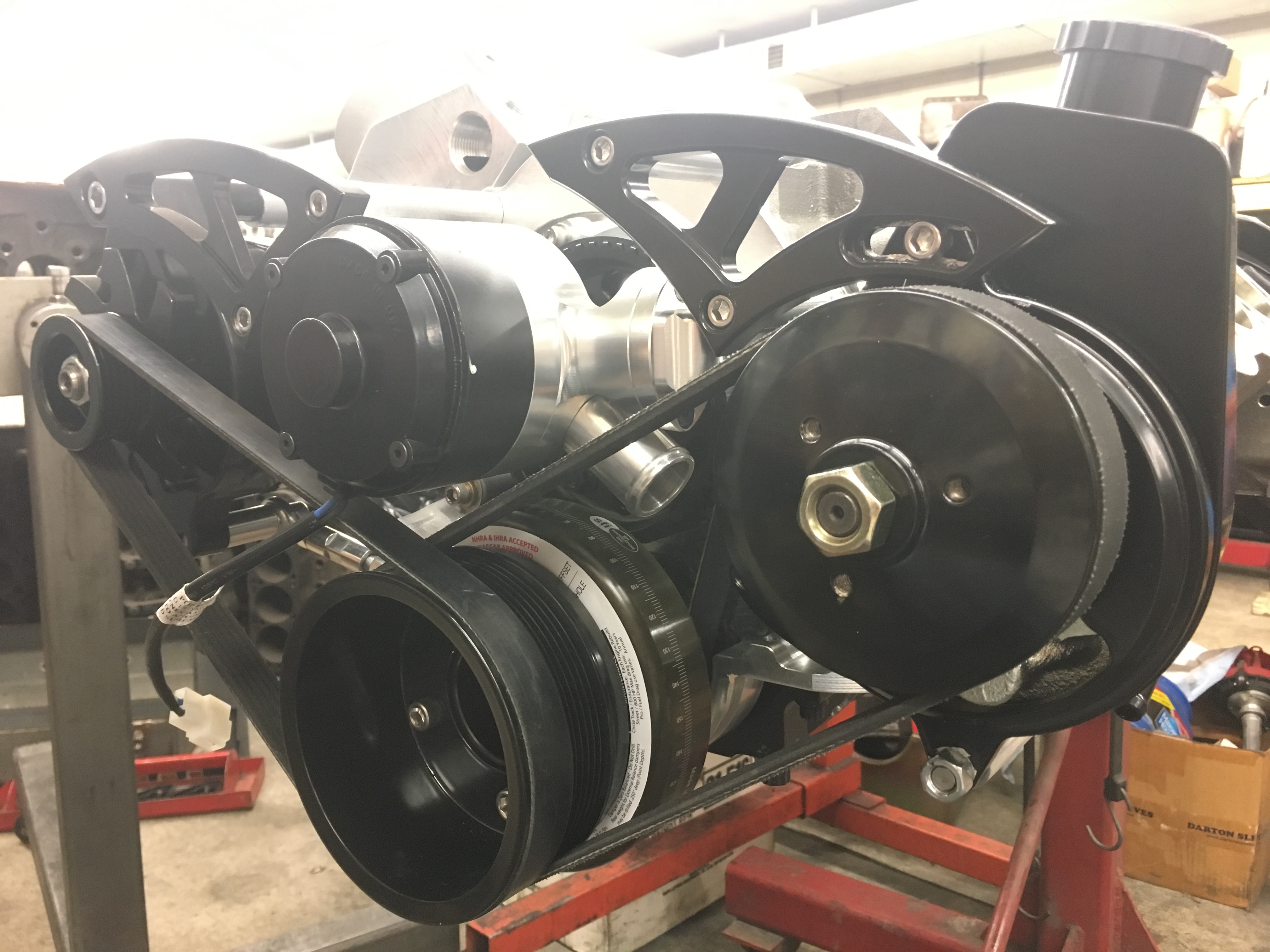

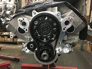

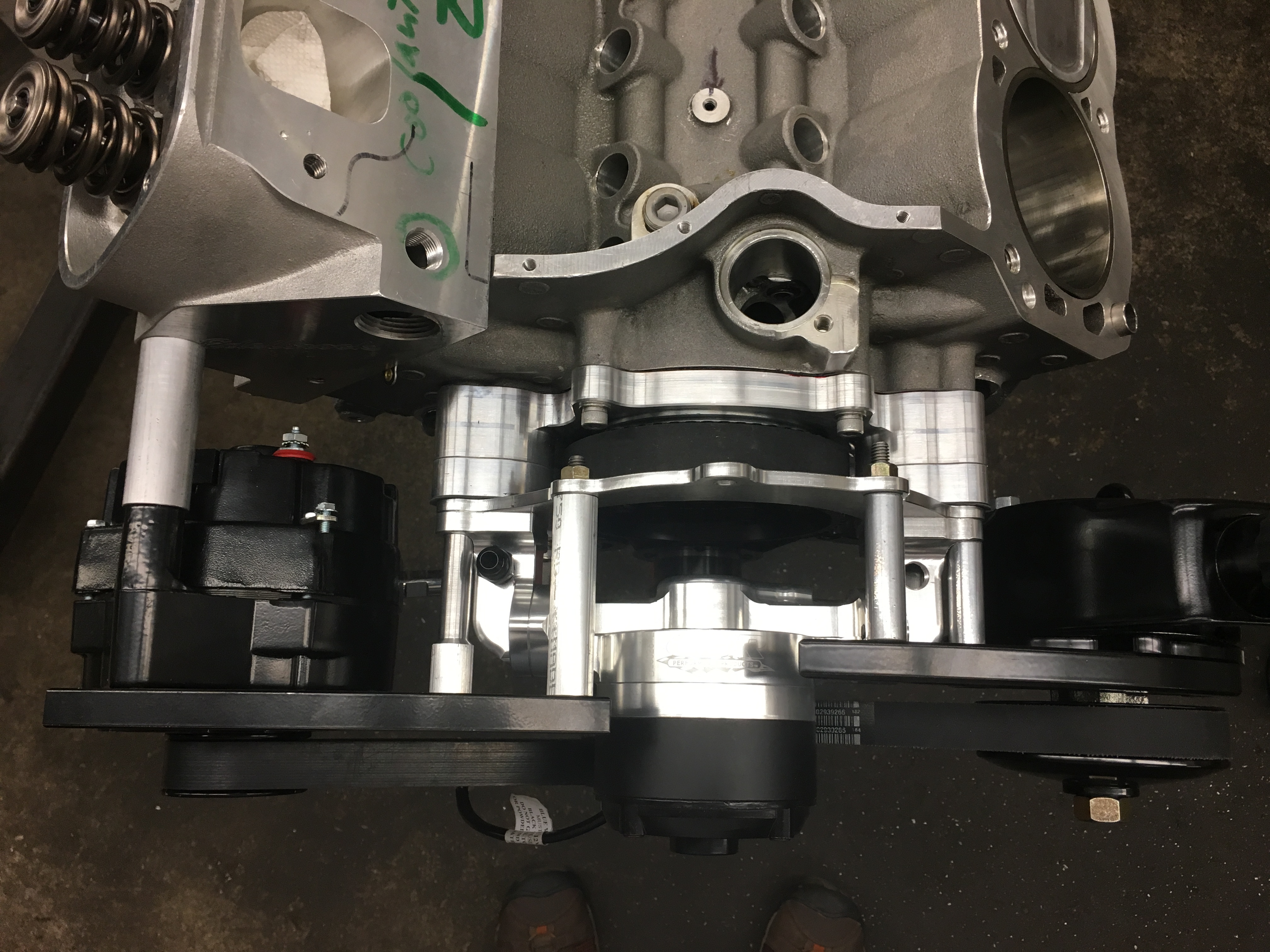

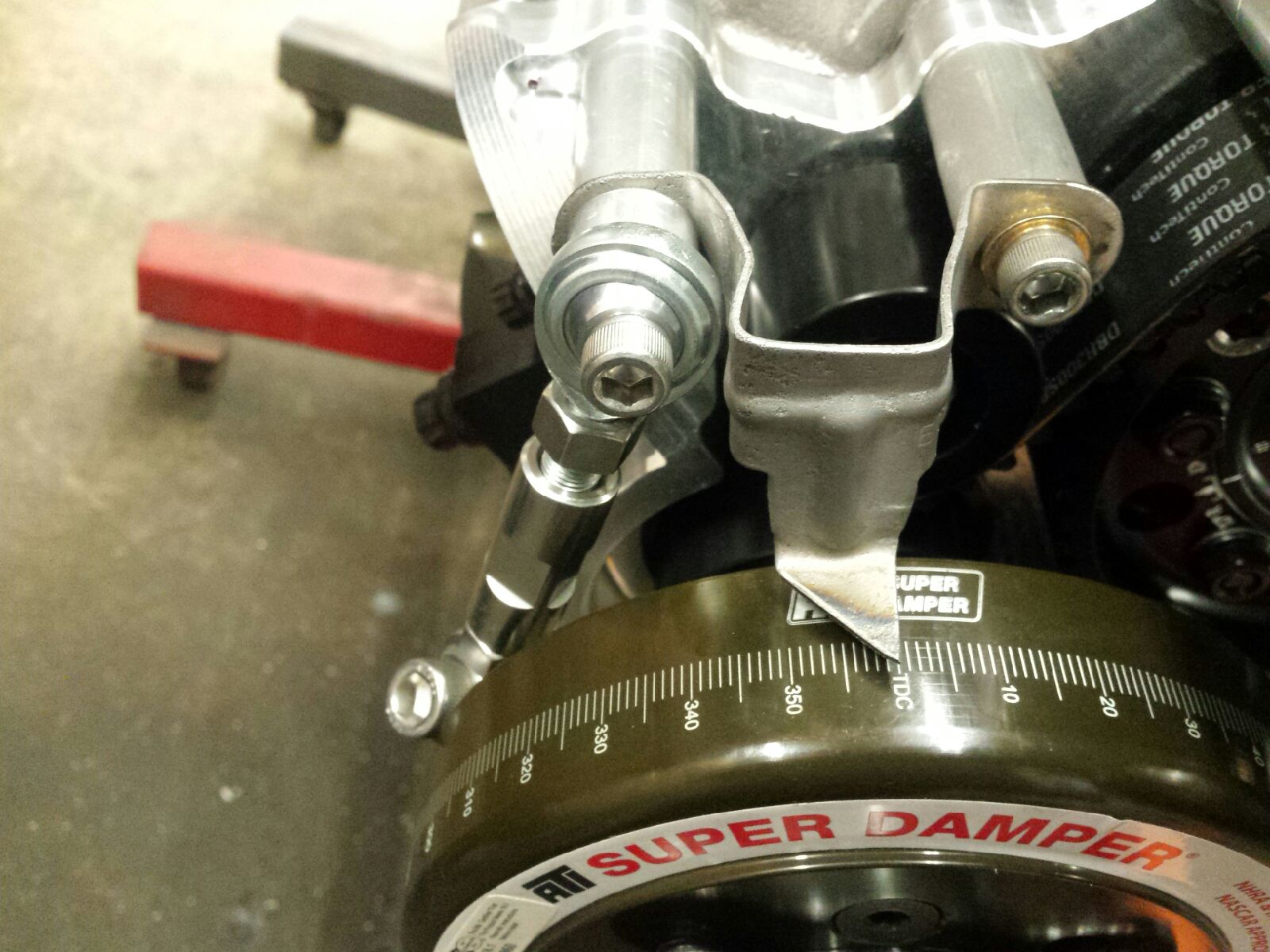

Default Seven Brands
Greetings,

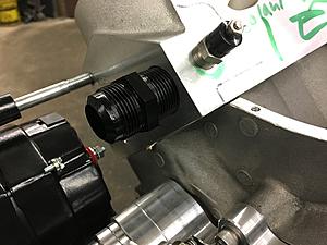

There seven brands/manufacturers from and including the block out to the harmonic balancer.
California bolt ons, some modification required. Every spacer for the alternator and power steering had to be remade. Timing pointer is Ford and may be the only Ford part in this setup. It's pedestal is custom( not shown)
Heads are being bolted on tomorrow.

I ferret out the craftsman. Roll bar shop is Crowman Fabrication, Gordon Crow. Engine is at CAMS, Canton Automotive Machine Service, Roger Decker and sons. Assembly will be my department.
Cage is 1.75†chrome moly. Trying to satisfy NHRA and SCCA rules. In real life the car will be on the street 93% of the time.

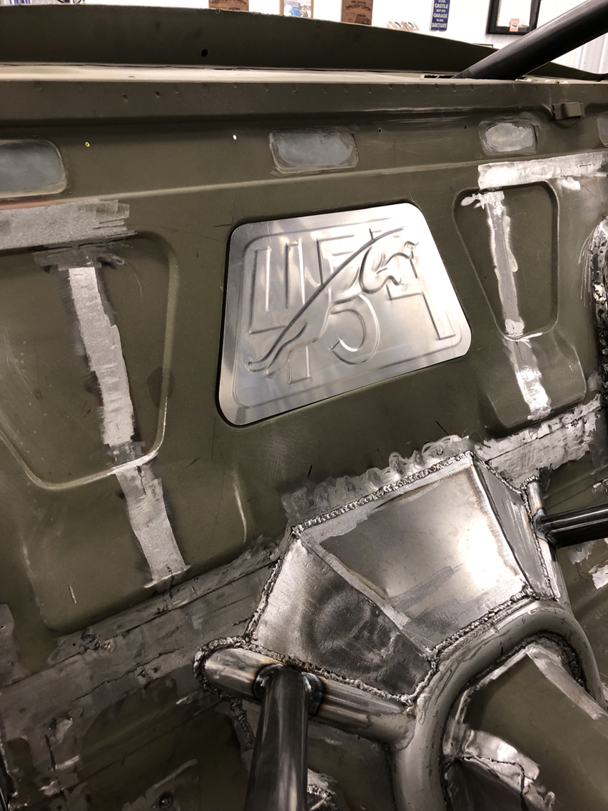

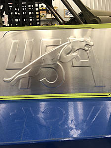

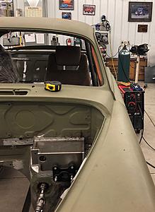

454 SBF, not to confused with a 454 BBC.

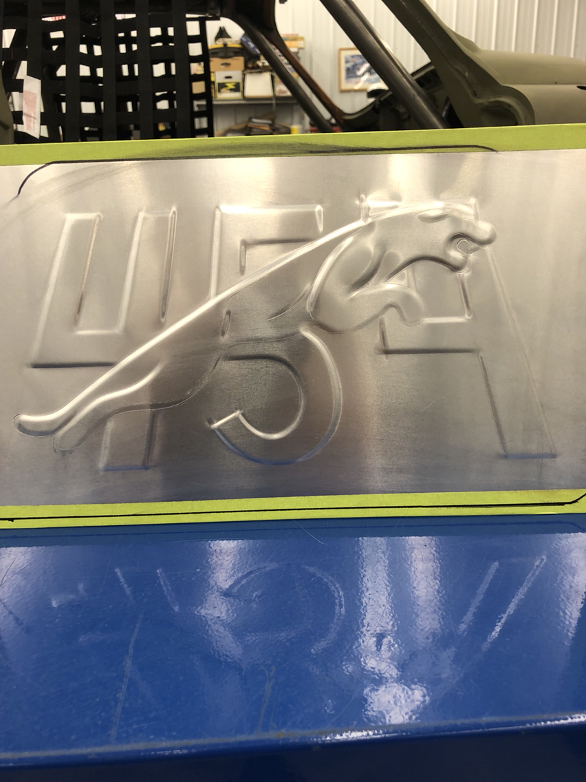

Gordon at Crowman Fabrication is quite the artist with a bead roller.

Blimey, that is very impressive with a bead roller, I'd love to see how he did it, proper craftsmanship.

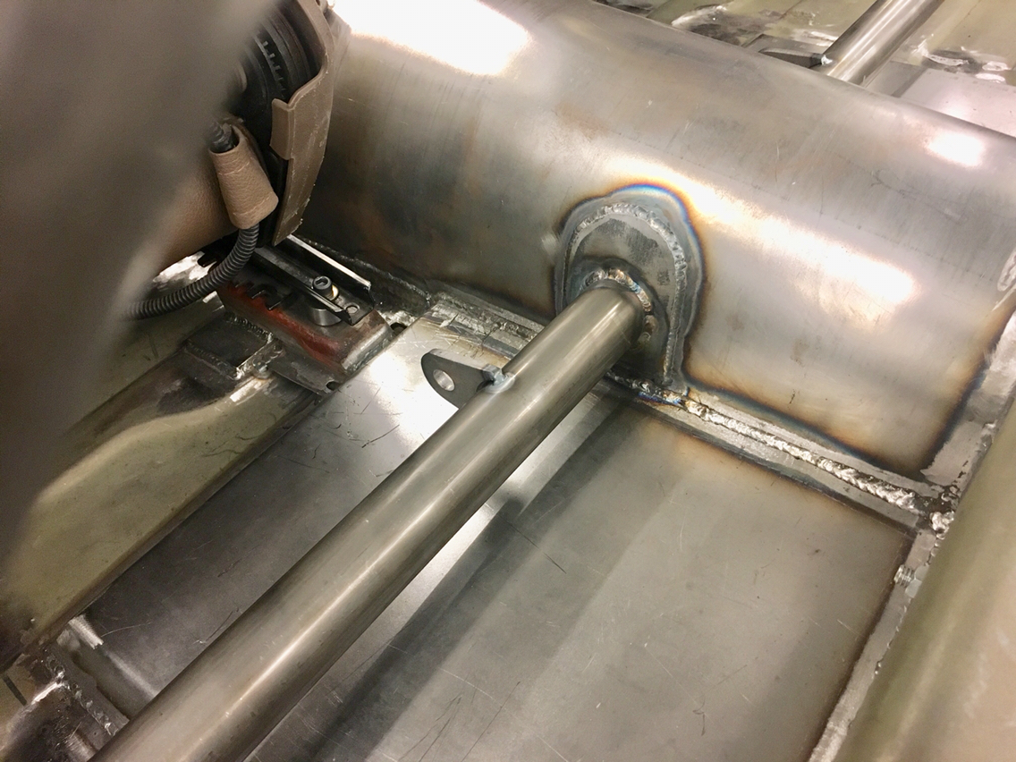

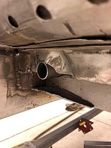

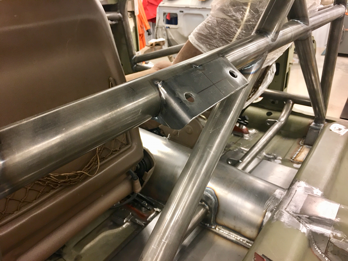

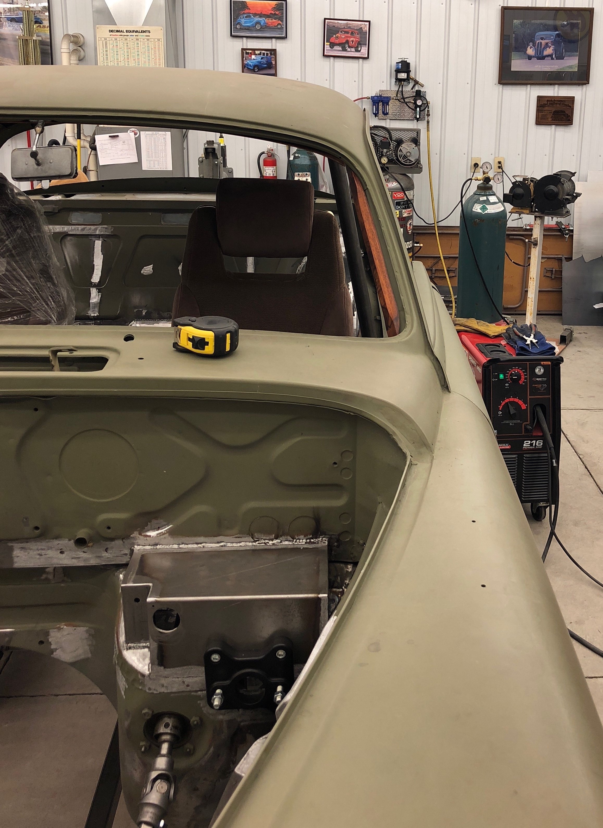

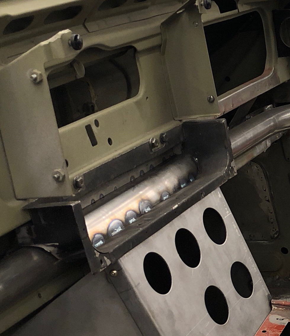

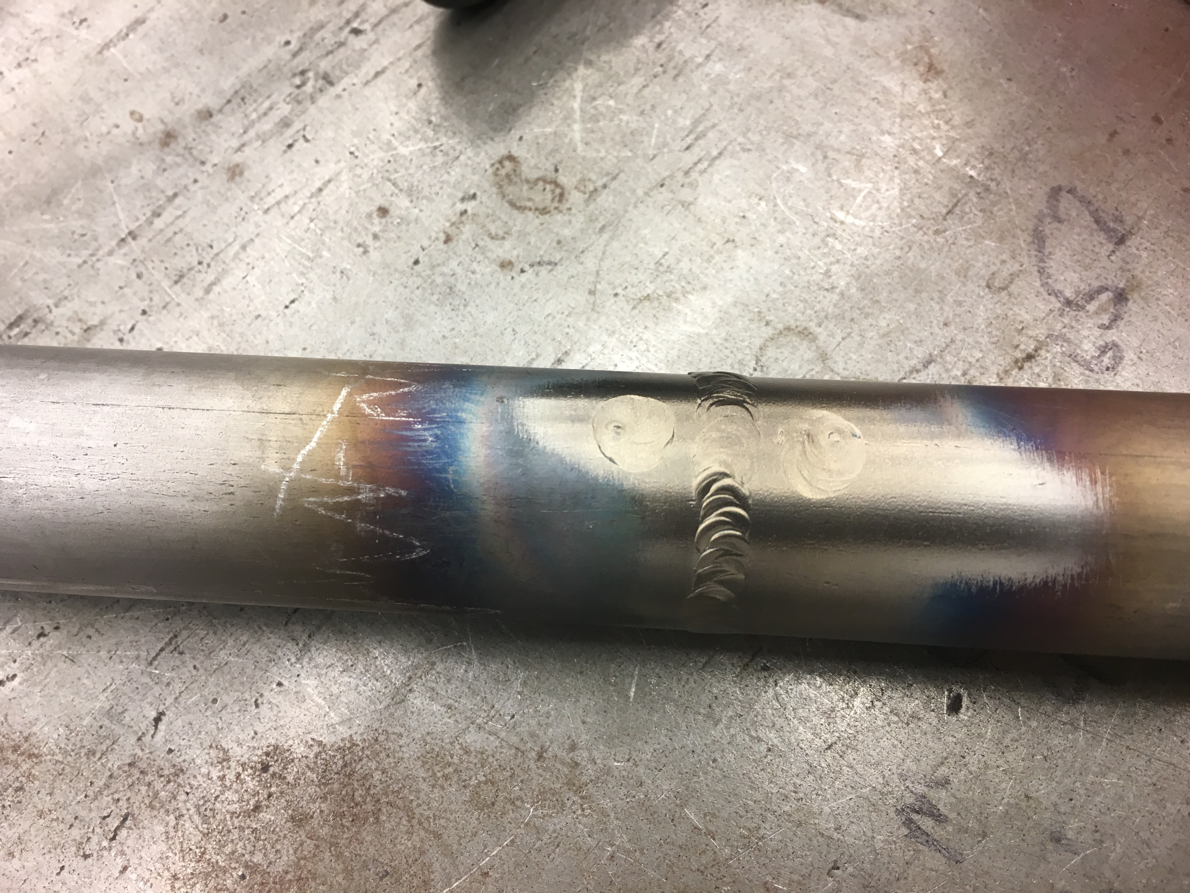

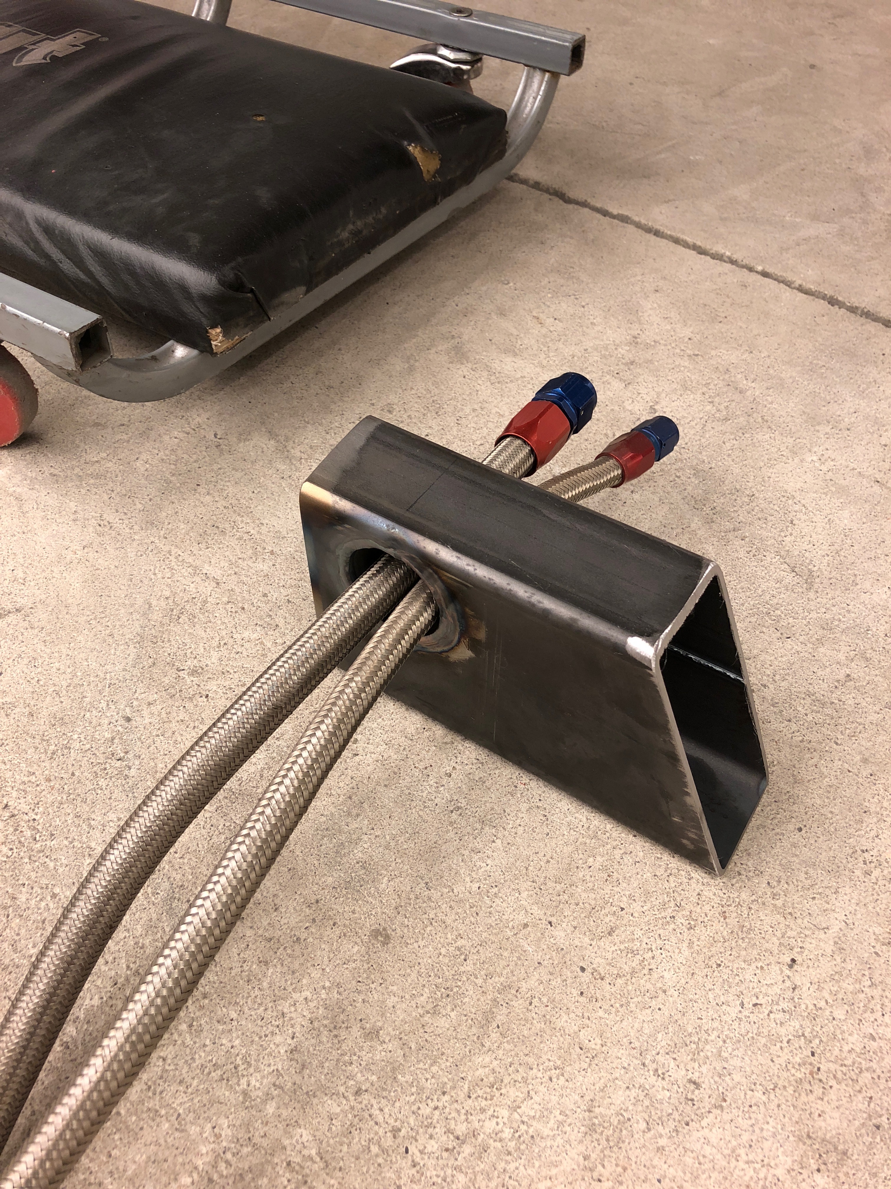

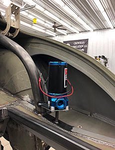

More of the cage, seat belt mounts, fuel pump mounting.

Pictures did not load.

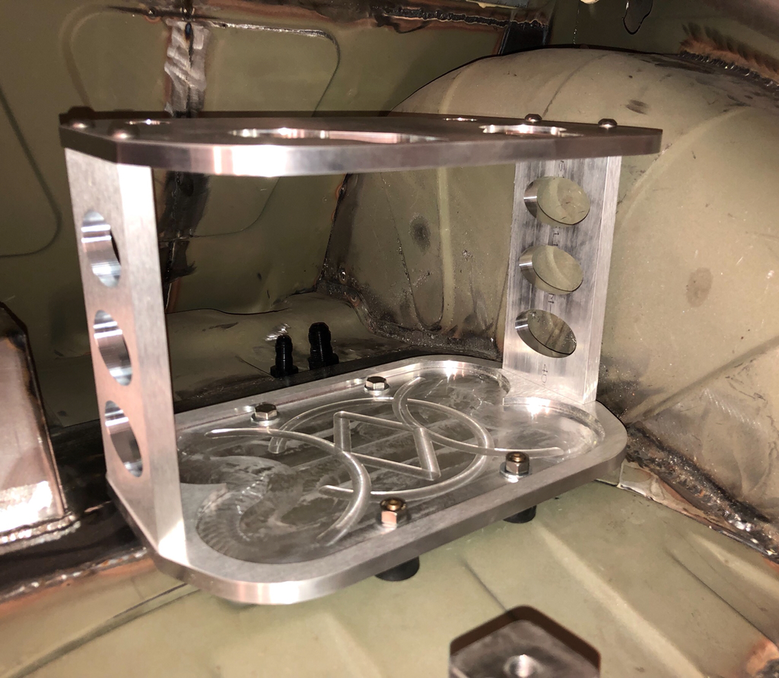

What's the item in the second picture Clyde, that's quite a lump of milled Aly fabrication there !
Damn nice job on the cage.
Old Dec 14, 2017 | 07:22 PM
  #197
lickahotskillet's Avatar
Posts: 795
Likes: 200
From: Ohio
TillyJon,
Thanks for looking! It's the battery tray & hold down.

From: Bath UK
That's probably the best looking Battery tray I have ever seen Clyde
