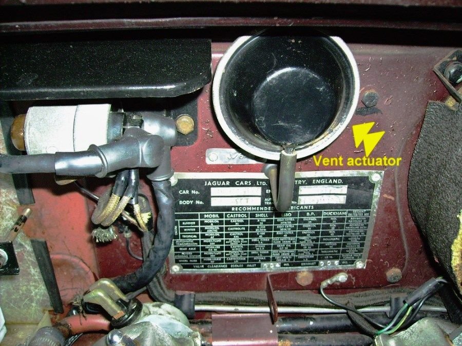

Check on the bulkhead dead centre under the bonnet. There should be a round saucer shaped vacuum switch with a rubber tube going into it. When the button on the dash is pushed this saucer shaped vacuum switch operates a lever that opens the scuttle. On the Mk2 this was opened by a lever but the S Type went up market. Problem is the saucer shaped Vacuum switch can stop working and is no longer made so a previous owner might have removed it.

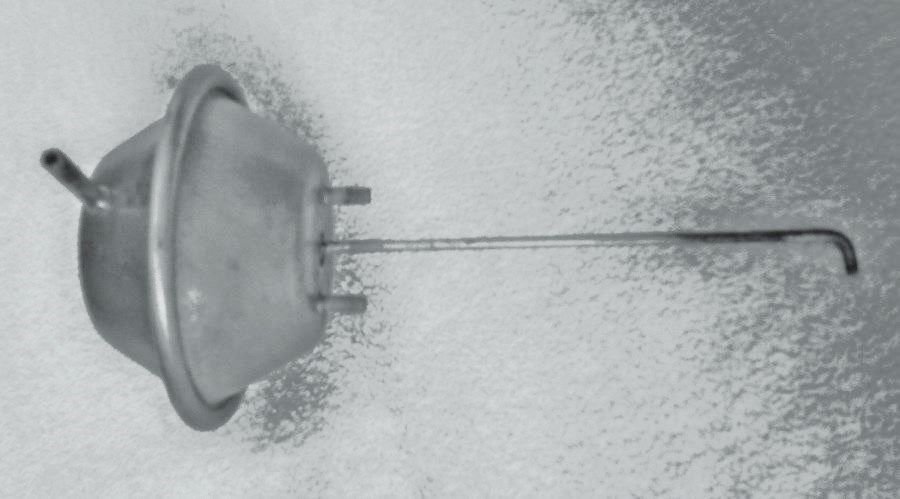

the Vacuum Actuator for the Scuttle Vent is located on-center below the vent itself mounted to the firewall in the engine compartment.
Cass calls it a "switch" but it is an "Actuator" operated by vacuum.
Those actuators can be rebuilt by a firm in Australia for approximately $85.00 USD.

Vacuum control scuttle vent. 66

this is the Scuttle Vent Actuator
