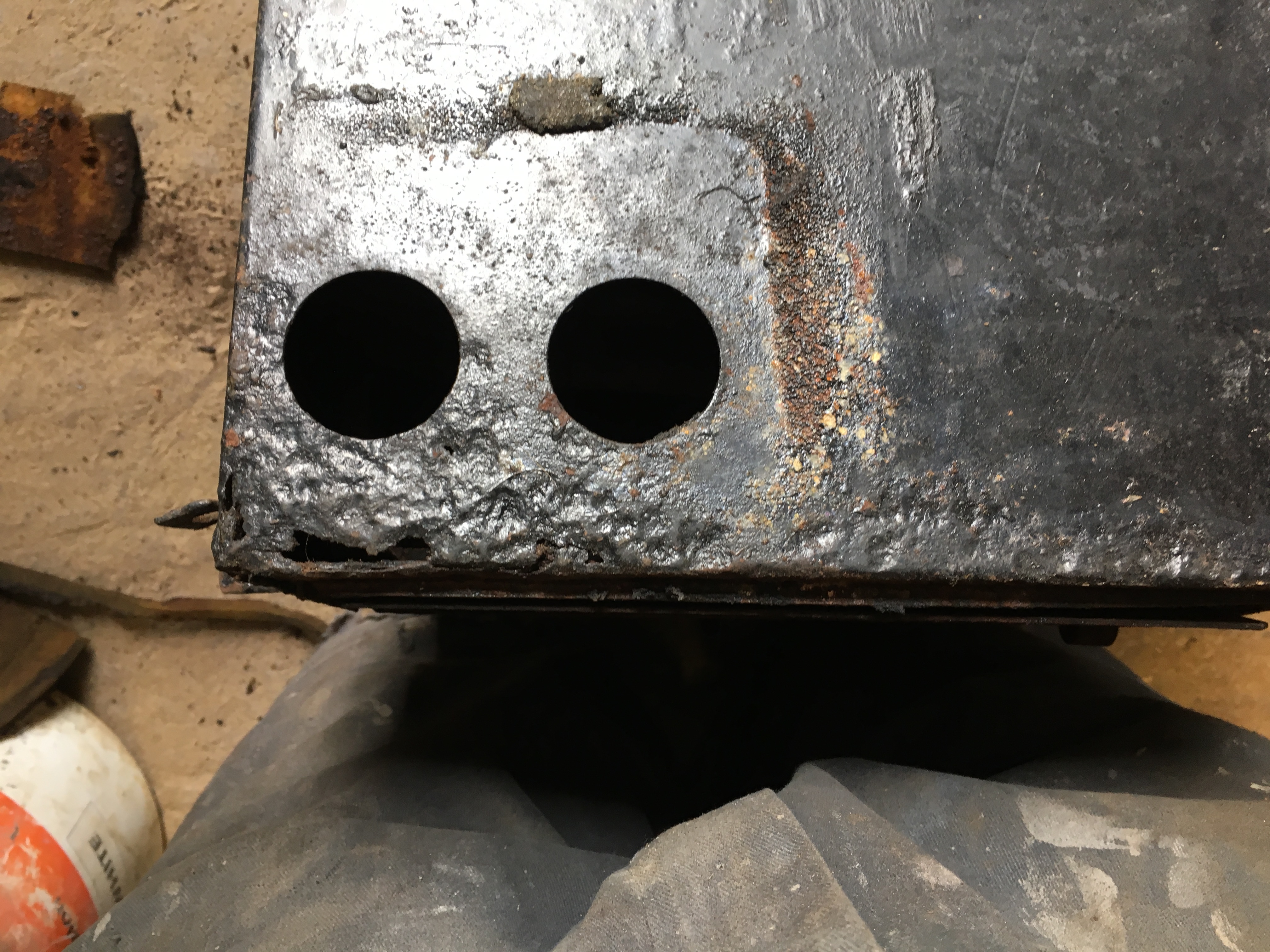

I had an extra fuel tank in the car when it arrived, which was in much better condition, but I thought I would take the filter and sender out of the old tank to see what they were like before ordering more new parts, you will see that i wasn't much of a decision !!
So new parts fitted and in went the spare tank which turned out was brand new and immaculate internally, just a real bad paint job, which resembled icing rather than paint, so I rubbed it down and gave it 2 new coats of paint.

That float and sending unit is sure a scary mess !

They say everything ends up back in the earth, guess that gas has just about turned back to tar, you can just see whats left of the filter still inside the tank, and the pick up tube was solid !!

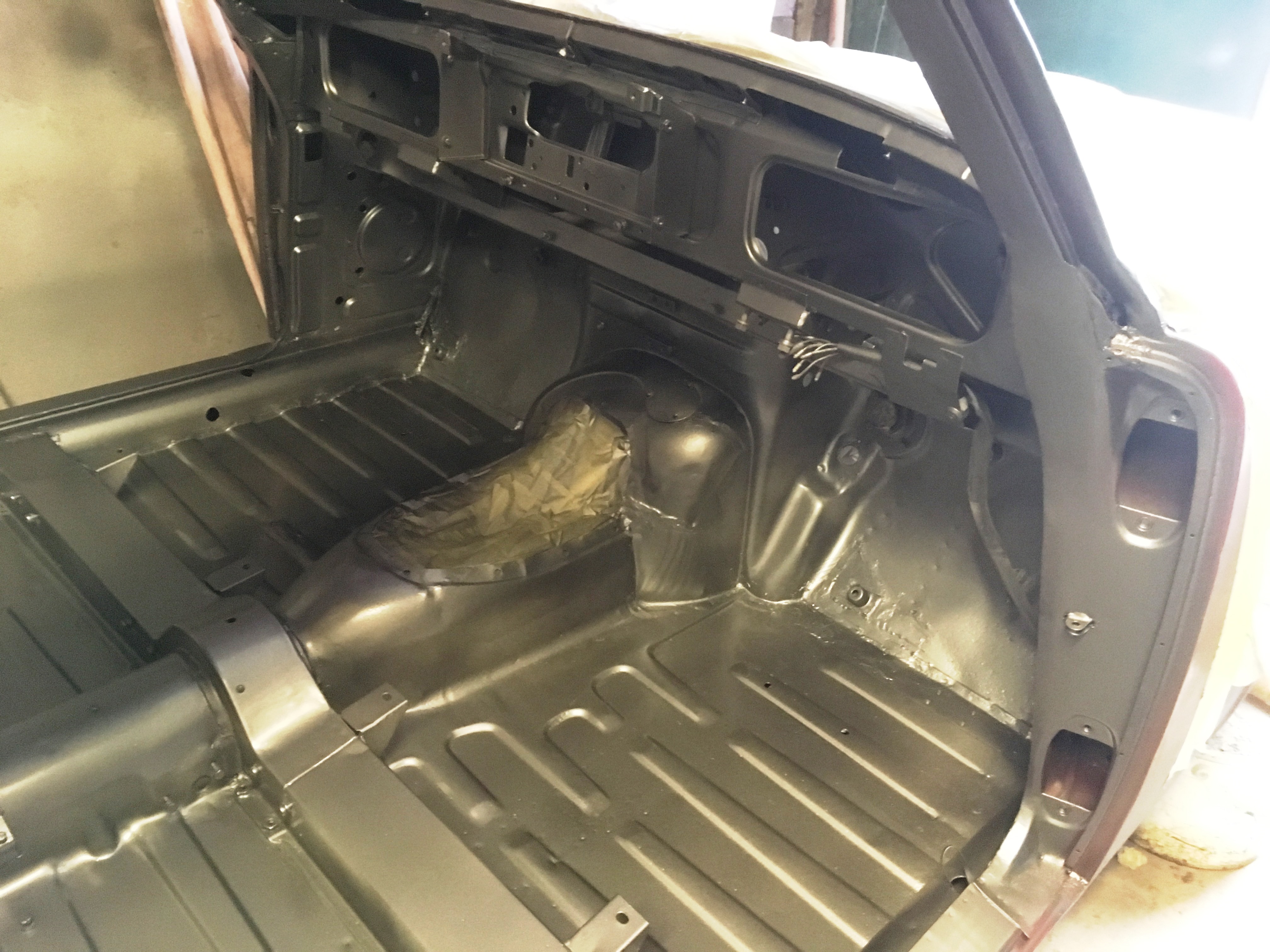

I was lucky that there was a new tank with the car, I'm not sure I would have tried to resurrect the old tank after seeing the state it was in.
Thank you Gene, it's a way off driving yet, but I am getting there slowly, have a few bits to sort out and then I need to strip and sort out the doors, bonnet and boot and then the respray can start properly.
Got the inside coated in the finished color, boot next then the doors etc.

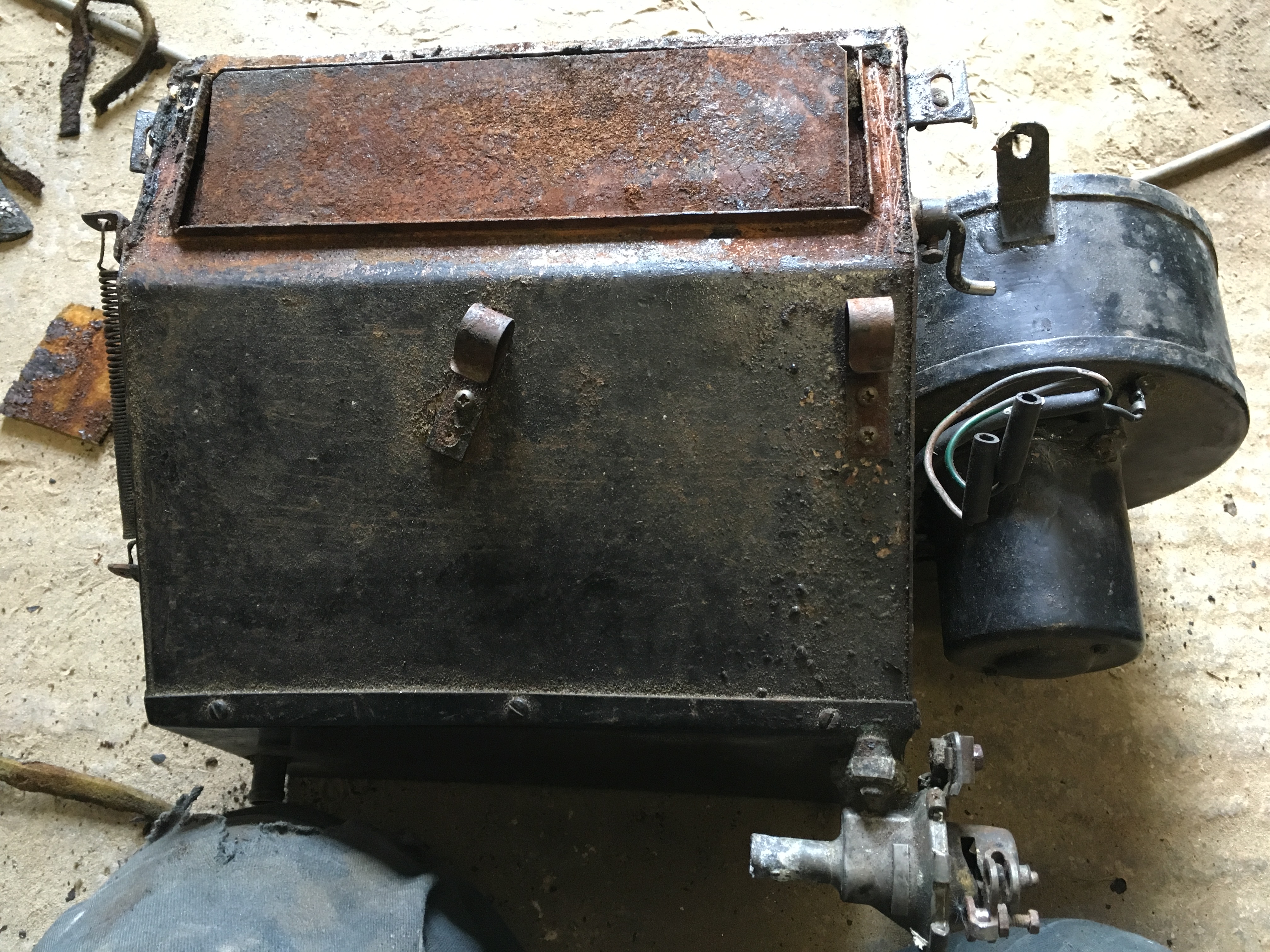

Heater box was on the agenda today, usual mess and some rust, seized lower flap and completely shot water valve.
This is well documented on MK2's Valvechatter site, so I won't bother with the details, a few pics below of what I started with and the repaired area before re-drilling the vent and painting, I removed the brazing from the lower flap, so I could shift the pivot pin and free up the flap, and I have acid etch primed and just shot a coat of black over the box.
Ordered some self adhesive neoprene sheet which I shall make new seals from and a new water valve and some other bits. I will take the heater matrix to be re-cored with a more efficient core for better heat transfer.
The motor is in very good condition, and appears to work very efficiently, it seems to pump out a lot of air despite many comments that these are poor fans, was there an upgrade to these in the later MK2's ?
