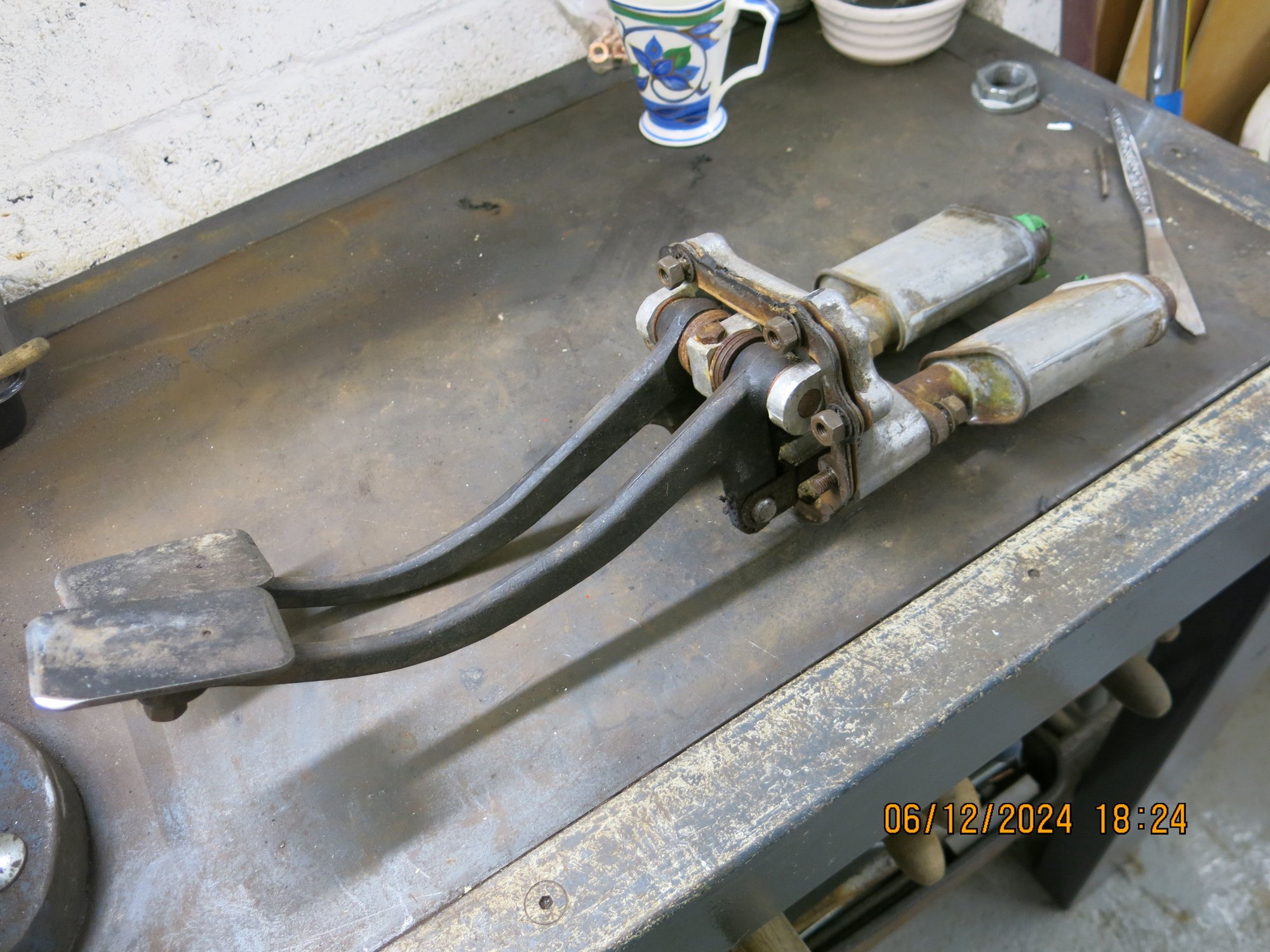

I spent yesterday stripping apart the front brake calipers, *clutch and brake reservoirs along with the 7" brake servo, bearing in mind that the calipers and MC come from a mk 2 (I found the date tag of 30.6.64), once the calipers were apart one could see the plating that remained either cadmium or possibly zinc (but 64 might have been too early I reckon for the manufacturers to be using zinc). So I will follow that lead. Still when I took the brake peddle box apart it is my feeling that the pedals had been chemically blacked and not painted so I will also follow that.
The original reservoirs I intend to use again once I can free the piston and hopefully be able to measure the seal kit, they don't appear however to have been a design used by other jaguars of the period
- I could do with one screw top should anyone have a spare?

I may be misunderstanding the photo, but it looks as though there are two clutch master cylinders and no brake?
Old Dec 10, 2024 | 11:01 PM
Bill Mac's Avatar
Joined: Nov 2012
Posts: 1,131
Likes: 1,206
From: Joyner, Queensland, Australia
That pedal box and master cylinders are correct
The MK1s did not have a separate brake fluid reservoir as per later MK2s etc.

Old age! I'd forgotten we were looking at a MK1.
