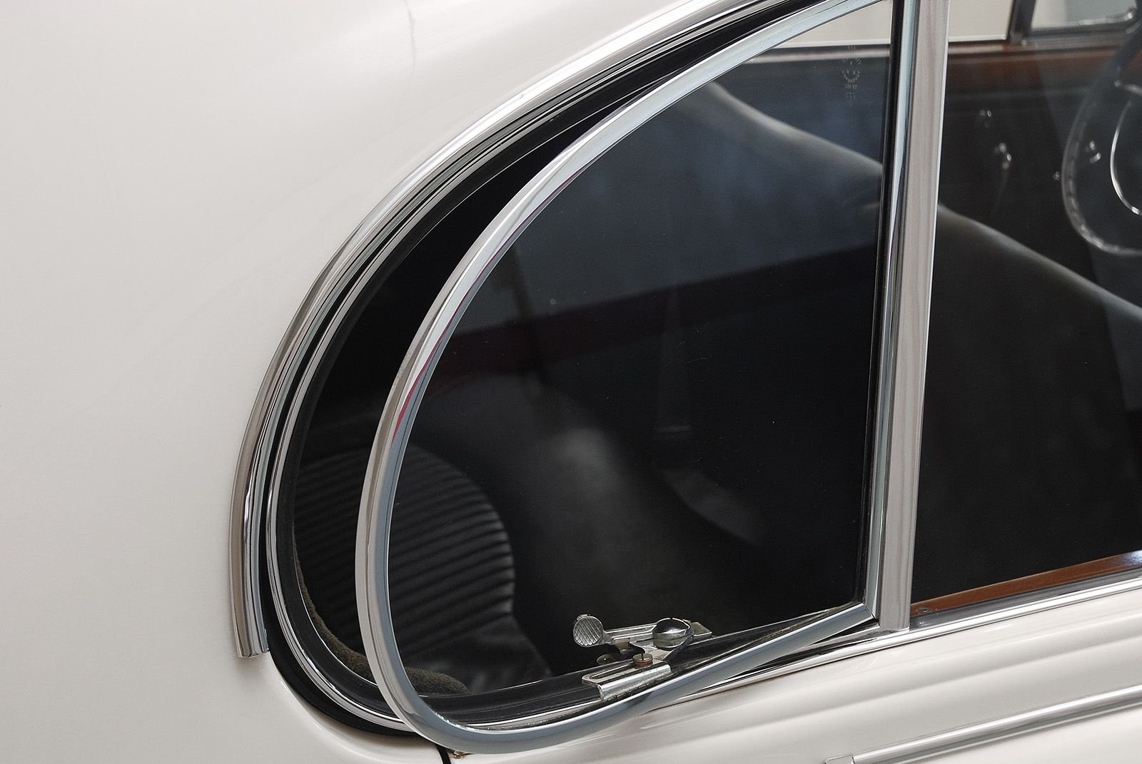

Cross section:

The inside of the car takes a standard "whisker strip".

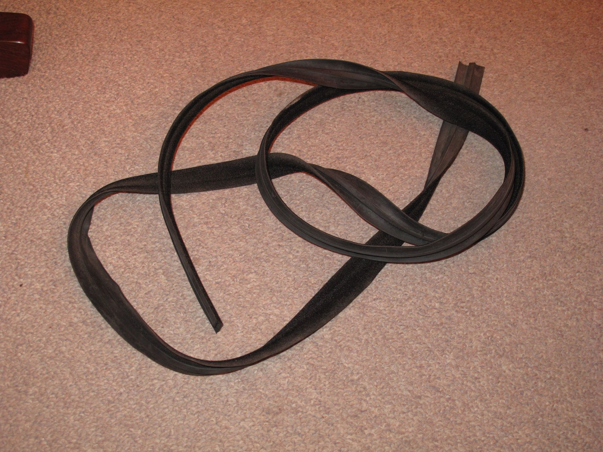

Sorry if this is a rather simplistic question. Using the dishwashing soap tip from Glyn, I was able to slide the rubber seals into my nicely rechromed trim. without much trouble. I bought the correct seal material from SNG Barrett and they supplied much more than apparently needed for each window. Obviously the rubber on the outside is only as wide as the glass opening between the chrome frame pieces. It does not overlap the chrome frame. When I trim to width, do I cut the entire way through, leaving no rubber fore and aft of the window opening or should the rubber stay in the channel and I just cut off what I need to cut off. The remnants of my original trim pieces seems to indicate that there was rubber inside the bead beyond the glass but that may be the sealant used under the NDVs. It just seems odd to me that they gave me an extra 8 inches of the rubber seal for each window. Maybe it will become obvious when I get to that point.

Once shrunk to size cut off at end of chrome strip. NDV's have their own rubbers. They gave you extra if same as S Type.
Let me see if I can find a picture.

This is the extra they gave me.

It's difficult to cut what's inside the chrome molding. I'd cut away what is outside and excess to the width of the glass. Any remaining inside the chrome is invisible and harmless. It might even help to anchor the rest.
Absolutely correct. That is exactly what I did & so did the SA Plant. All 3 of my cars were cut like that but rotten.
