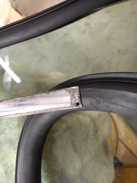

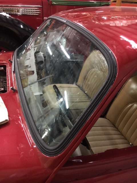

I bought a complete rubber kit from Welsh Jaguar for my MK2. I managed to get the rear screen in by roping it from the inside. I have read that i should now mastic it in to fill the gaps and basically glue it in place, but nothing really definitive. Any opinions?
I also tried to fit the front screen, but the rubber from Welsh is clearly too long, and doesn't look right to me. When I hold the shiny trim up against it, there is nowhere for it to go. I suspect this is the wrong part. Welsh is very responsive when you want to buy something, but so far I am not getting an answer now I need help.

Have you also got the rubber filler insert for the seals ? This has to be inserted before the chrome strips can be inserted into little lips that run all round the seal.
Windscreen sealing goo is generally always needed to ensure it doesn't leak water. This is not the same as gluing in the screen like modern stuff.
There is a special tool for inserting the filler strip as this was commonplace on most UK cars of the time. Older screen fitters may still have theirs in the bottom of their toolboxes somewhere.

To Fraser's point, the front windscreen rubber goes on to the body first, and then the windscreen put up against that. The Kriss Motors progress blog has a section on Glass installation that describes the process quite well. (fairislepress.com).

No- don't cut the rubber. See how it fits on the window frame, and if you have an issue with that, talk to Welsh. It is possible you have the wrong seal, but unlikely if the back one fit.
You might consider outsourcing this to a place that does Jaguar glass. From what I read, the front windshield is a bear.

Wondering if you're installing the gasket upside down. In your pic with the chrome trim the underside of the gasket is showing - the slot on this side fits the lip on the windshield opening in the tub. Here's a pic of the correct orientation - a fill strip goes into the center slot after fitting the glass to lock it in, and then the chrome pieces install under the shallow lips in the gasket. Hope this helps.

Thanks Doug. My first attempts revealed that I must have it upside down. I have been trying it the other way around, and I can see why it should work now, but I cannot get it to go together no matter what I try.

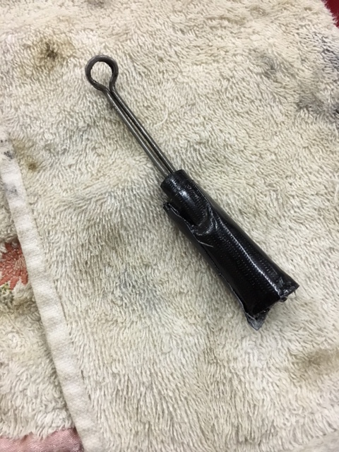

Well, I decided to ignore the phone last night after everyone had gone home and have a go at this. Surprisingly I had good success with the windshield. I used masking tape to hold the rubber in place near the top of the A pillars, and the screen went in without too much fuss. I made my own tool for the lock strip, and with the assistance of some vaseline it went in on the second try. You have to make the tool so it does not try to rotate the rubber strip as it goes in. The whole process took less than an hour. I then wasted another hour on the chrome trim. I gave up and went home.

Excellent. Congratulations. Please describe how you made that tool as I for one will be needing one eventually.

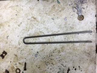

I used one of the pins that come with Preen Landscape Cloth. It was the right diameter at the bent end for the locking rubber to squeeze through. I found a steel bar (a drill bit will work) that was a good fit, then squeezed it in the vice to get close to a full loop with a handle. A bit of adjustment to flatten it, then bend the end and wrap the sharp end with tape. I did hammer it slightly to made it more diamond shaped to control the the lock strips better, but with some lube on the rubber it goes in easily.
