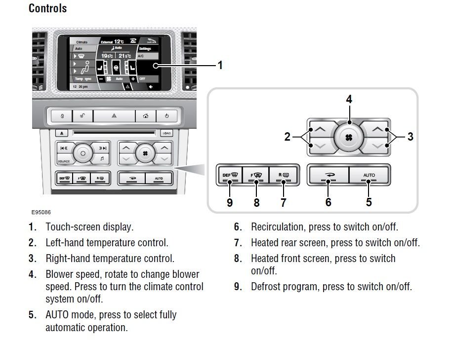

Hello, I'm new to jaguar vehicles. I just purchased one 2 days ago and everything seemed fine. The AC was working perfectly fine, blowimg cold air through the vents.. however my husband started messing with the settings in an attempt to connect Bluetooth (which it doesn't have).
I'm wondering if he messed with the AC can't settings because I feel like air is coming out but through the dash like the defrost vent, and the bottom.
I already checked that the actual "defrost" buttons at the bottom are not on. I wonder if it's just that the ac no longer works so soon? Please help, I went to YouTube and couldn't find any videos on this.

It will be a remarkable co-incidence if the AC has failed. It's more likely that the present climate control settings are preventing you feeling the desired level of cold air. Using the left and right temperature control buttons (2 and 3) to cycle from max hot to max cold with the blower speed knob (4) rotated clockwise will check if the AC is working.

Omg youuu all made my day!! The instructions worked to perfection .And yes that is the last time I will let my husband touch my Vehicle..
When I got to work the AC was throwing the air through the bottom Vent however when I got out of work turned the car back on the AC turned on normally the real regular vents the temperature was set to 70゚゚ which is to hot, do I adjusted the temperature and voila!
