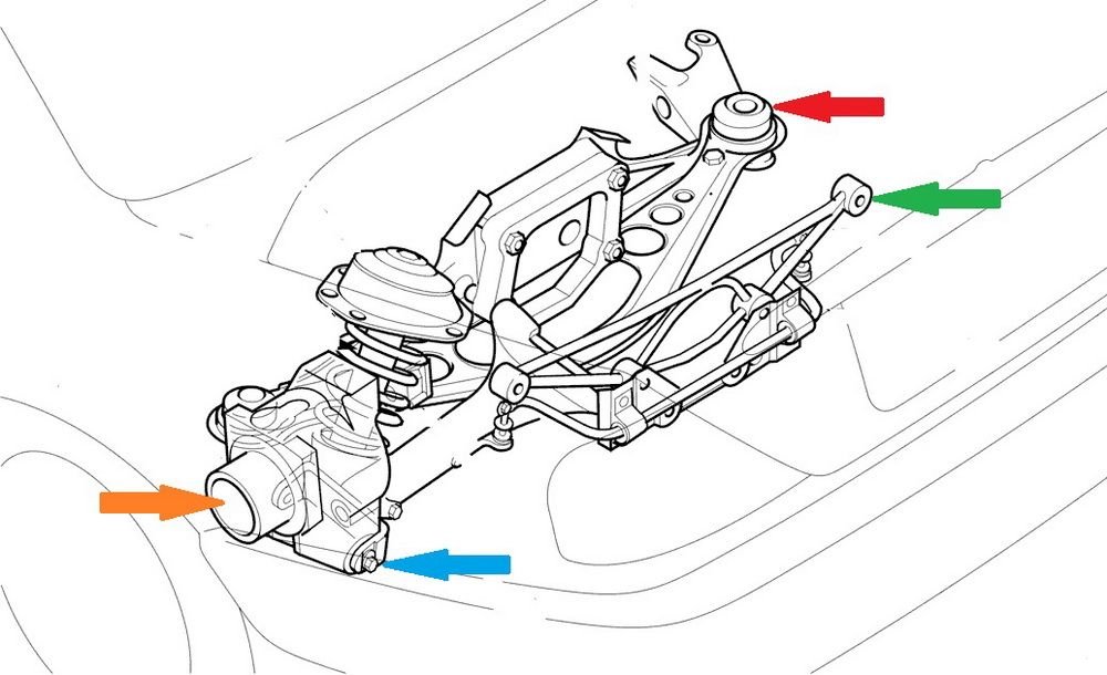

Hi Franklin from USA just bought a 98 Jaguar xj8 4.0 I have a bumping in back in like going down a rock drive way do you think it is bushings or shocks all together thanks for adding me to the sight

Probably bushes and shockers at that age.

It could be as there's plenty of bearings and bushes to wear on the rear suspension. A common failure is the "A" Frame bushes - arrowed red in this diagram:

If my car was doing that I would look at shock bushings first and go from there.
