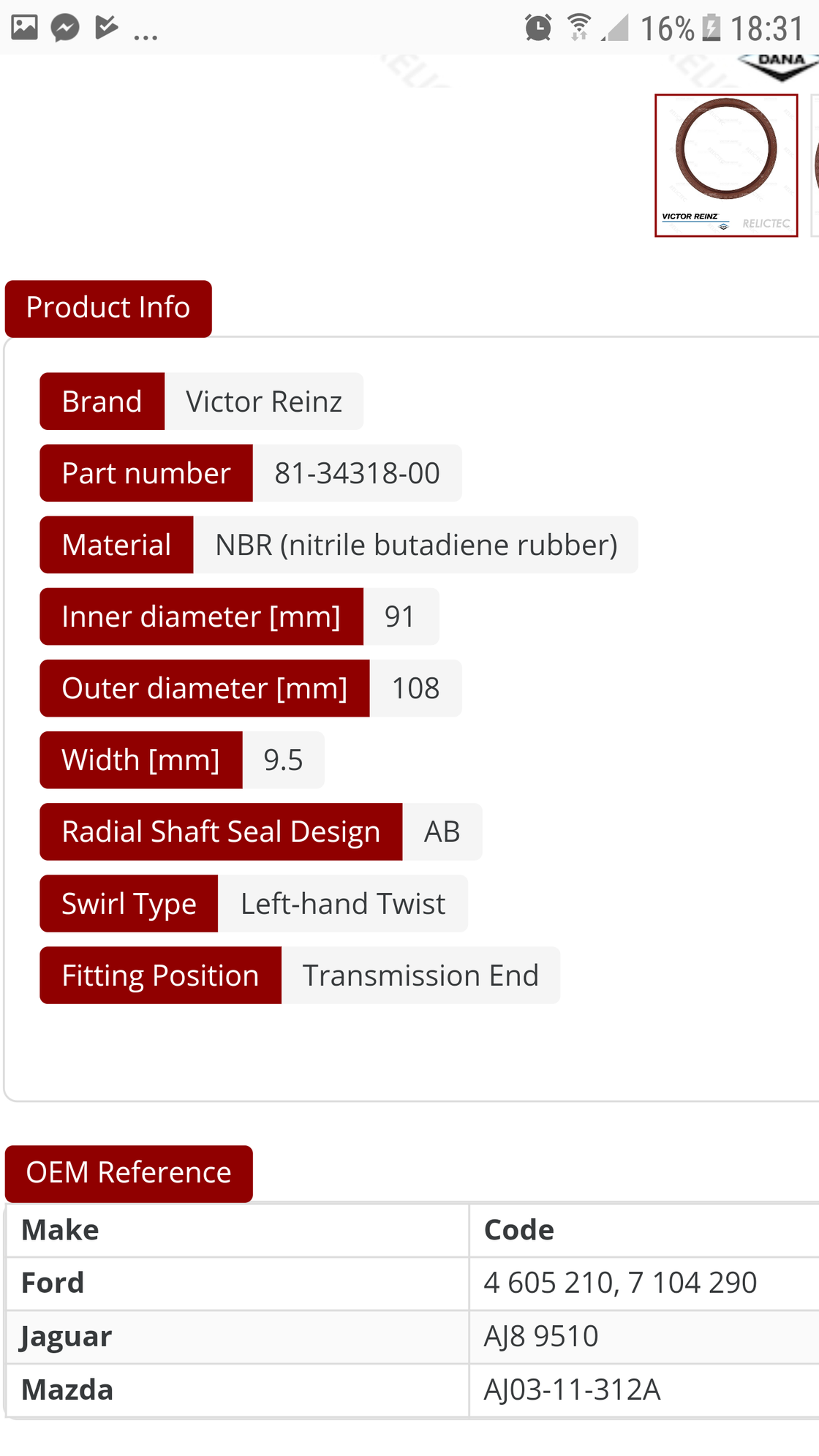

Hi , I'm Mark, from Devon UK. I'm doing the clutch on my 3.0 v6 and noticed I need a new crankshaft end seal. Euro dont stock it, Jag can't get one till sat. Am I correct in saying the Ford ST220 uses the same bottom end, and might have luck with Ford?

Found my answer

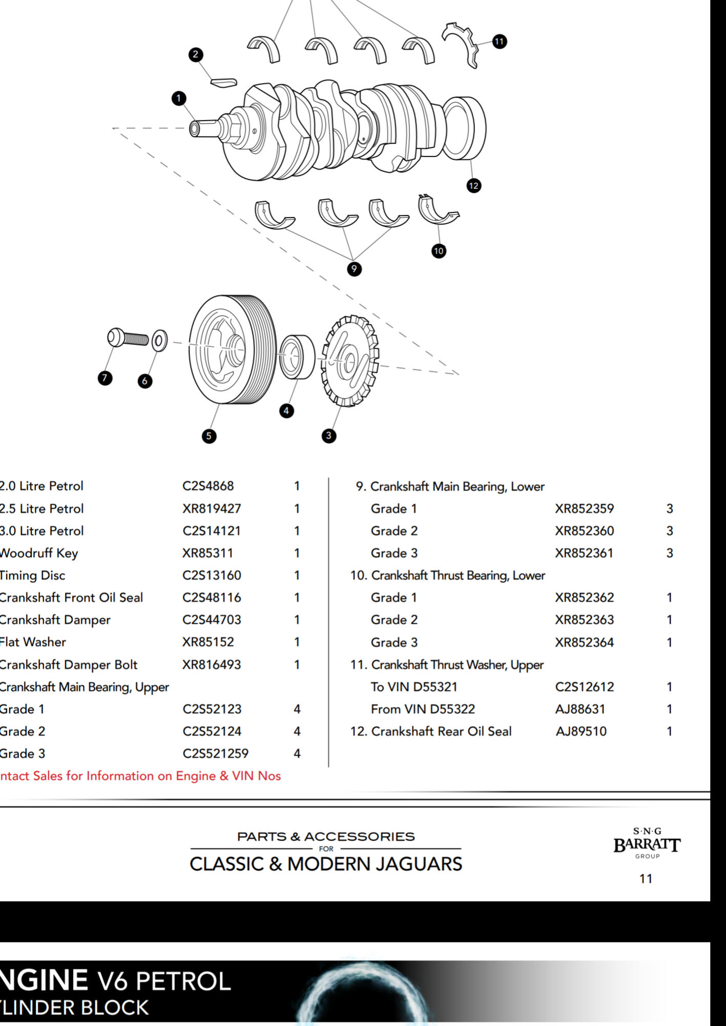

Welcome to the forum Mark,
Good to have you with us at Jaguar forums and to see you found the anser to your own question.
If I've identified the correct seal, Jaguar Classic (part of JLR) list a superseded P/N:

Thank you. It was the rear seal on the transmission end. But thanks.
