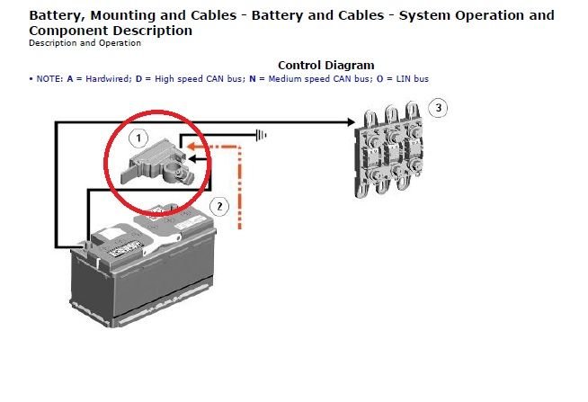

YES to permanent connection but NOT simply direct to the battery. On later models with BMS (Battery Monitoring System - see item 1), direct connection should be to the positive terminal but negative connection should be to the nearby earth (ground) stud.
Depending on the distance to your power socket, extensions called 'comfort connectors' are available if required.
