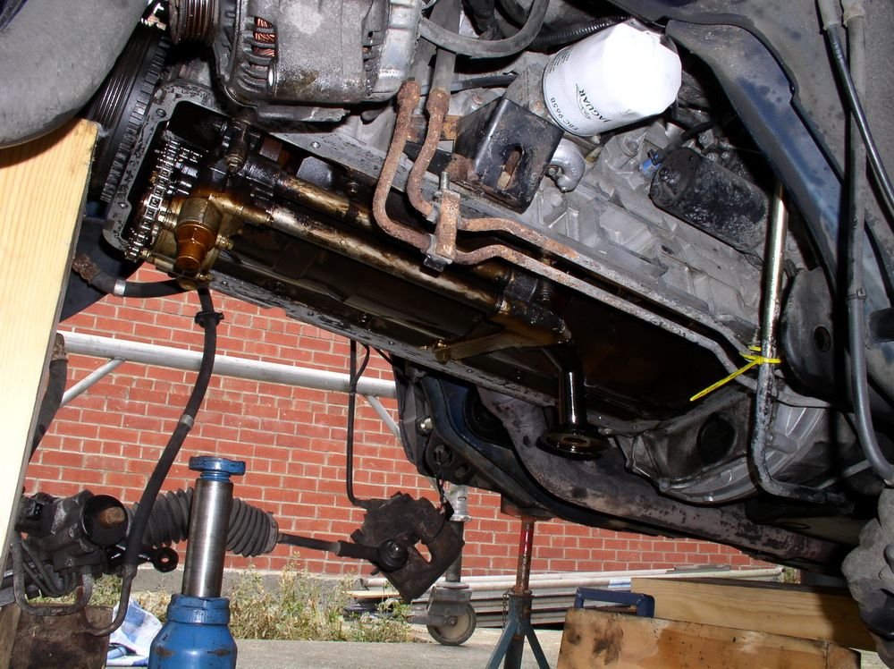

Thankfully it's just the oil pan gasket leaking and oil is blowing back onto the bell housing. Some very minor cam cover leaking but per my mechanic "these don't count as oil leaks for a jaguar" ha! I had the chance to look at the car on the lift while in the shop for trans fluid and filter changed and we were both impressed with how clean and solid things looked. Fortunately no metal in the trans pan, too.

Just as well it's a minor leak. The front suspension has to come off to remove the oil pan. No gasket - Jaguar use Hylomar sealant.
Mine was cracked so I had no choice but to replace it.
