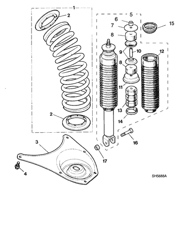

Old Feb 9, 2018 | 04:34 AM
Posts: 28,839
Likes: 11,290
Welcome.
Your 1996 should be an X300 Series with the 6ltr V12.
Well done on a rare car.
The attached parts drawings show the XJ40 set up, with a front spring kit having a part number of JLM11267.

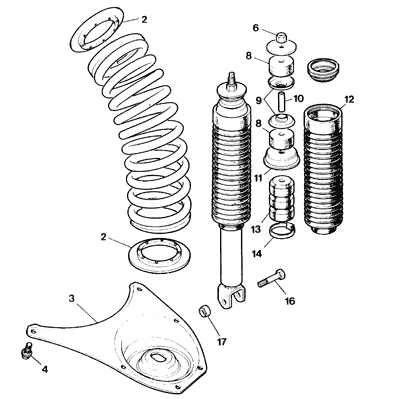

This one is the X300 set up. With the spring kit having JLM12161 as its part number.
What the actual difference is, NO idea.
Check the Jag number on the sprigs you have been supplied, and maybe there has been a model foul up?????
Your VIN ## will easily identify your car.
