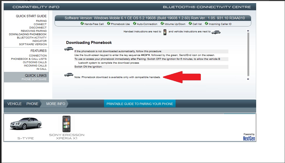

Originally Posted by Peter.Munton
.......... 2006 S Type 3.0 also a Sony Xperia J mobile phone I can pair them no problem but the address book does not transfer to the car.............
Jaguar BT Connectivity Centre doesn't list your Xperia J but see the line I've highlighted with the red arrow against the Sony Xperia X1:
Connectivity with newer phones in older Jaguars is becoming more difficult. Even with the fewer phones that can connect, Address Book sync is often unavailable. As an example, my Samsung Galaxy will pair in my 2005 XK8 but the Address Book will not sync.
I think you could be on a loser trying to progress this issue.
