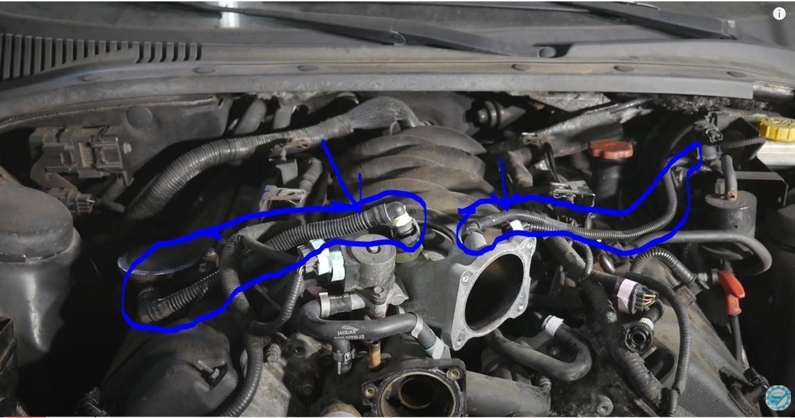

Hello.....I'm new to the Jaquar Forums. My father picked up a 2004 Jaguar S-type (4.2L) for me from an auction site as a way of thanking me for helping him through his battle with esophageal cancer. In 2019 ....while quite weak from chemo and radiation treatments.....unknowingly to me...my father drove 200 miles each way to pick it up. The whole thing was a total surprise. My father was quite proud of this find. However, looks were deceiving. The car was pretty neglected over the years. I'm not a mechanic by any means and funds are very limited....but have slowly been working through each issue. I've had the car for a little over three years and have only been able to drive it maybe 20 times for quick little joy rides before something else went wrong with it. Many times, I wanted to just throw in the towel and send the car off to its final resting place. But knowing what my father went through to surprise me with it, my heart just wouldn't let me do it. Sadly, my father lost his battle with cancer in September, 2022. But something keeps pushing me to try to get the car up and running reliably as a way of honoring him. Perhaps its the don't give up attitude my father had up until he passed at 90 years old. So for very sentimental reasons, I want to give it one last try. My hope is to get the parts I need from a salvage yard. I've called every salvage yard I can think of within a 75 mile radius.....and none of them have a 2004 Jaguar S-Type to pick from.
Can anyone tell me if the parts that I need have to come from that exact model/year? Or would a different year or maybe even an x-type be helpful? The parts that I need for now are the two vacuum hoses shown in the attached picture and a retainer clip for the hose that attaches to the bottom of the coolant reservoir tank.
Thanx for your time and advice!

An X-type will not work, as the V-8 was never fitted to this chassis. An XJ-8 with the 4.2 should use the same hoses. Firment for the brake booster hose indicates both the XJ and S-type. The part is available from Barratt's for around $48.00 new.

It appears some of the cooling system is disassembled, so let's start with getting some of the known failure points corrected so the vehicle can become more reliable. The water outlet containing the thermostat is one of the items to be replaced as it often cracks leaking coolant. Also the EGR return hose under the inlet manifold should be replaced as it can cause severe overheating when it fails. Remember to refill the cooling system with the correct coolant meeting Jaguar specifications.

Here is a great resource for researching part numbers:
https://parts.jaguarlandroverclassic.com/
I’ve had excellent results finding a Jaguar part number, and then running a web search with that. Look on eBay with a Jaguar part number, as many dealers are liquidating older stock. I’ve found many genuine Jaguar parts this way.
What is the purpose of those hoses? Are they part of the crankcase ventilation system? I had several similar plastic lines fail on my ‘02 V6. I fabricated replacements with steel lines and rubber hose. They work great. You might be able to save yourself lots of money that way.

While I am waiting on that.....So is it only the XJ-8 that has the same same 4.2L engine as my 2004 S-type? If there are other models please let me know. Also......can you advise on the year range for the S-Type and XJ-8 that would have the 4.2L? When I called the Salvage yards......they really weren't helpful with regards to what other models and/or years would have compatible engine parts. I would tell them I am looking for parts for a 2004 S-type 4.2L and they would say they don't have that model/year in their yard. I would ask if they had any other models/years that might have the vacuum hoses and/or reservoir tank clip and they didn't know.

Yes as Xalty says pretty much all 4.2L V-8's are the same. Jaguar is so small that they use a very limited range of engines and transmissions across the entire JLR product range. So Range Rover and Land Rover 4.2L are in the mix too.
The 4.2L was developed off the older 4.0L V-8. Many variations used over the years.
Probably one of or possibly even the best engine Jaguar has produced.
4.2L Engine History
While used might work I would consider that these are all plastic parts and the car is a 2004. So at minimum you have plastic that is 18+ years old. It's at the end of it's life and they are shot. Now since they are plastic IF you can't source factory replacements you could rig up something up using an aftermarket hose of some kind.
We are seeing this type of repair on older car fuel pump repairs. The plastic elbows that connect the hoses to the pump are easily broken and almost impossible to find new. The repair replaces the plastic elbow with some common brass fittings and then replace the hose with something that fits.
