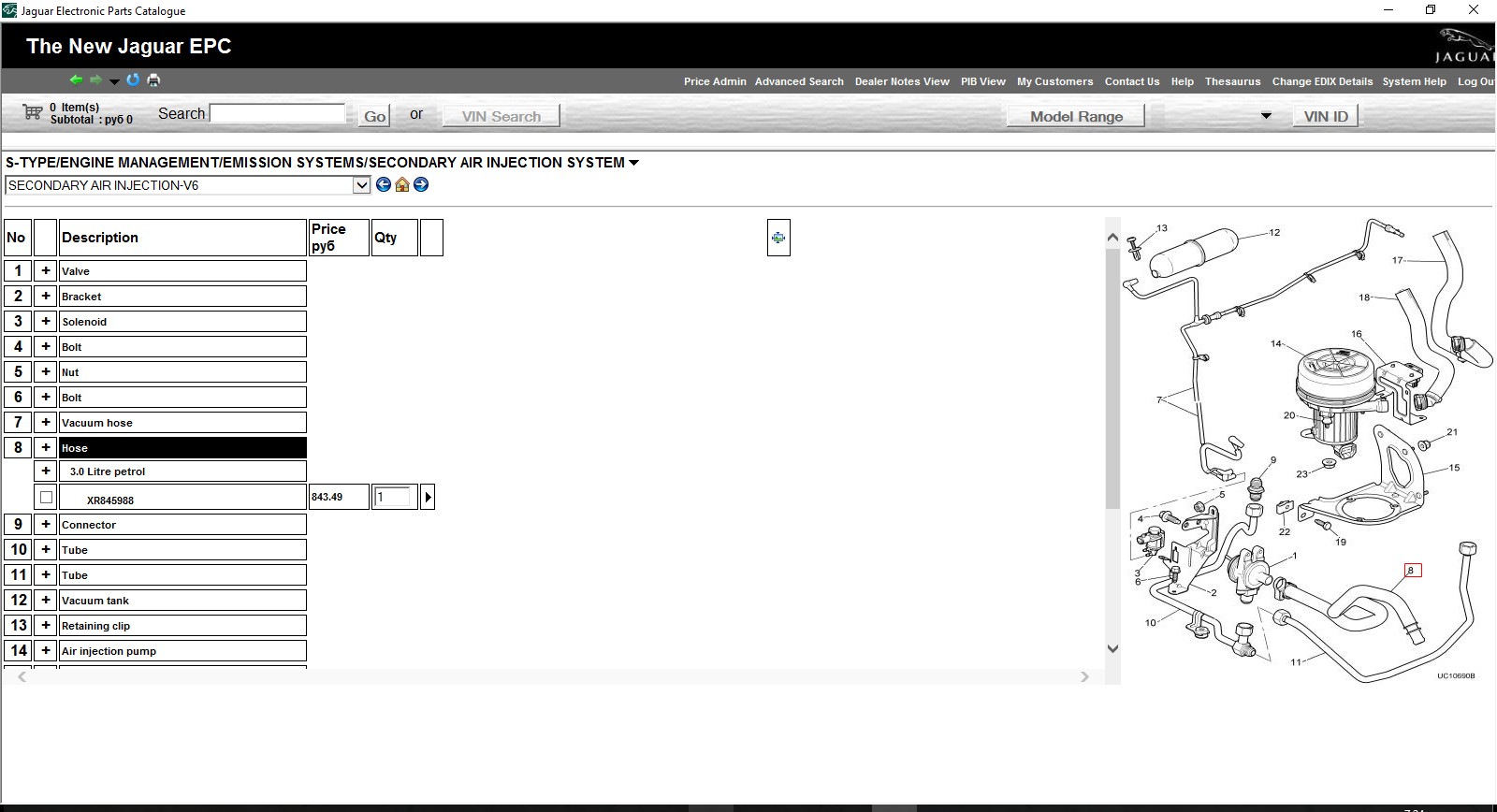

That part appears to be item no. 8 in the parts diagram for the secondary air injection system. You can see the part number is XR845988.

Here is a link to the official on-line Jaguar S-type parts catalogue page for XR845988:
https://www.jaguarclassicparts.com/uk/part/XR845988
