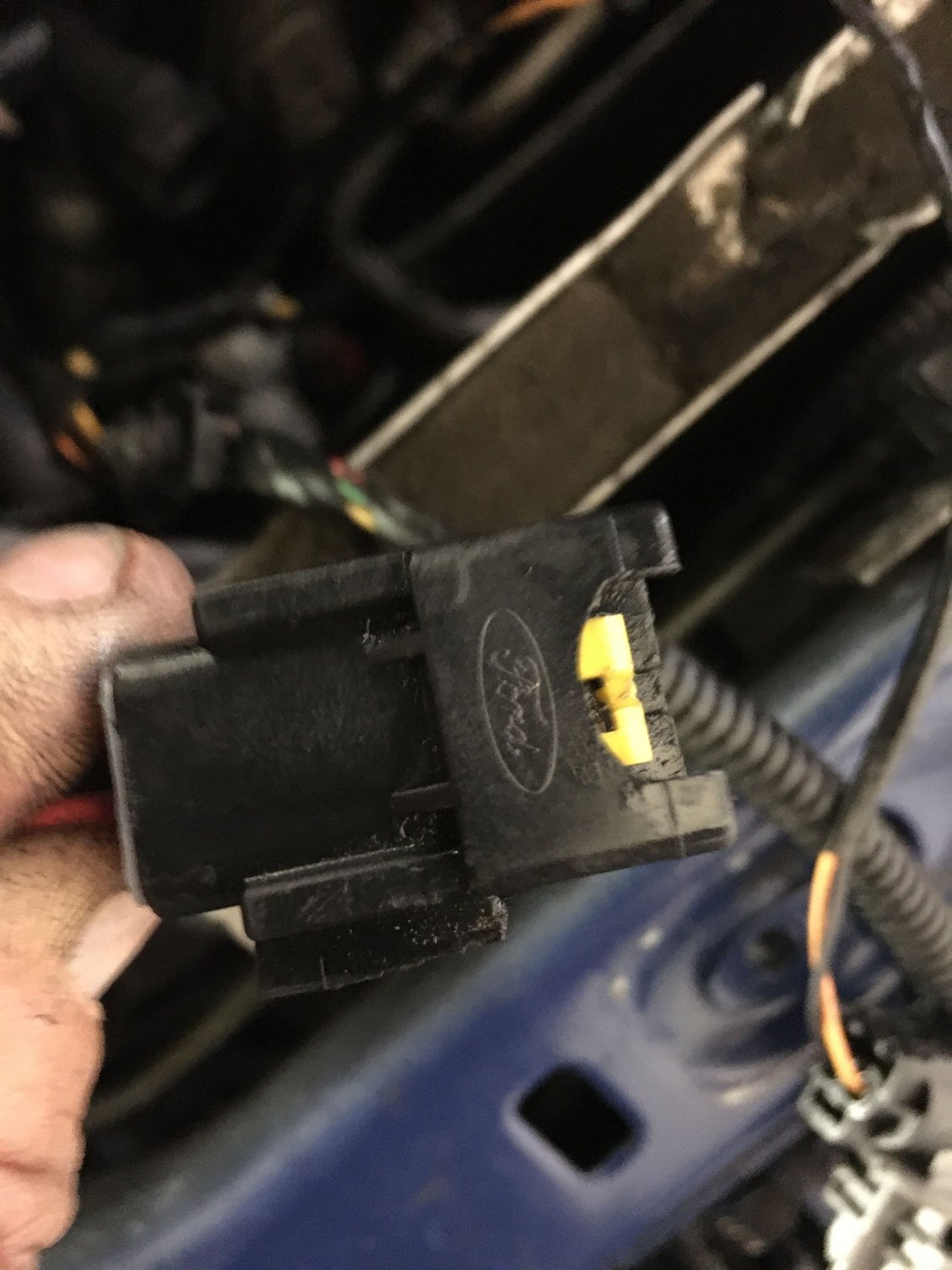

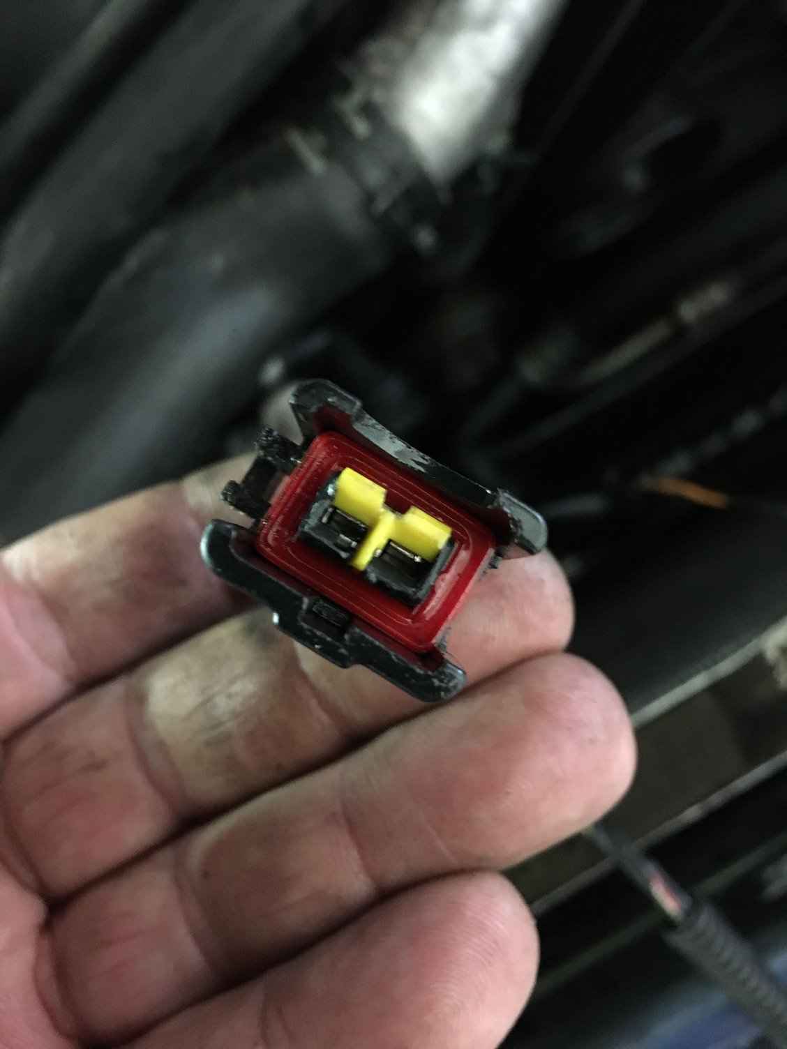

Hello Guys . I damaged the female connector plug that clips into the bottom of the auxiliary water pump and I am looking to see if there is a replacement part or part number available. The car in question is a S-Type R 2004 . The only information available is that is a 2 terminal plug and it has a ford badge on it . Any help would be appreciated. Cheers

On your existing connector, is it just the locking portion that broke? Can you still fully insert the connector, even if it won't lock? If so, I'd be tempted to try locking it in place with a tyrap or similar, so as not to disturb the factory crimps. I think that would be a more reliable connection than splicing in a new pigtail.

Look at the first page of 2-cavity connectors in either catalog. Does WPT-372 look similar? Both are also listed as 3U2Z-14S411-ATA. If you search online with either of those numbers, you will find many hits, both OEM and aftermarket. If close, but not quite right, try leaving off the suffix of that longer number and you should see similar connectors from that same basic series.

Hello . Yes I got an original plug from America . I ordered it on eBay ( Part number WPT- 372 ) or 3U2Z-14S411-ATA ) . Cheers
