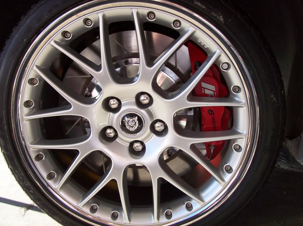

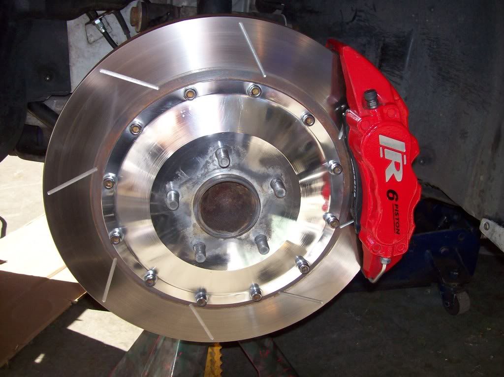

If you want your car to stop try something like this, 410 mm rotors with custom hats & radial mount Alcon calipers mounted on custom brackets.Name:  Brakes001.jpg

very beautiful setup
I like 4 pots more than 6 and 410 is too much in dimension, but it's only my way of thinking, many tuners think different
The 410 rotational mass is too heavy
It's seems that rotors are not floating, could you post the rear of the disks
6 pots, 410 not floating has not a big sense
The bolts used on hats MUST be special hardware, usually is one of the most expansive items in rotor/hat build up
You could not make a custom hat and use std hardware to fix the disk to the hat

Too bad you did not get stainless steel brake lines. Hard to believe you spent multi-thousand dollars on brakes and left the rubber hoses???? Your pedal will feel much more solid with the correct lines. I guess this is NOT a STR?? The STR has SS brake lines stock. You really need to engineer the ENTIRE brake system and not worry about looks so much.

The brake lines are custom stainless that are wrapped in a heavy rubber heat shrink, I had the hoses made by Truechoice Motorsports in their workshop & they recomended this. I like the fact if they ever chafed I would see it right away.

Are the disc rotors floating?
From the hardware it seems you machined working the hat not considering the different dimensional stability of alu and iron
The best way to get a working hat is to buy from an affordable supplier (Brembo Stoptech Coleman AP Racing ecc ecc) a rotor and a hat in the dimension you need (un-machined) and then machine working the pieces to your needs
this is the way we custom build the brakes for our race cars.

nice setup, youre just missing the full race look without the safty wired hat bolts.
