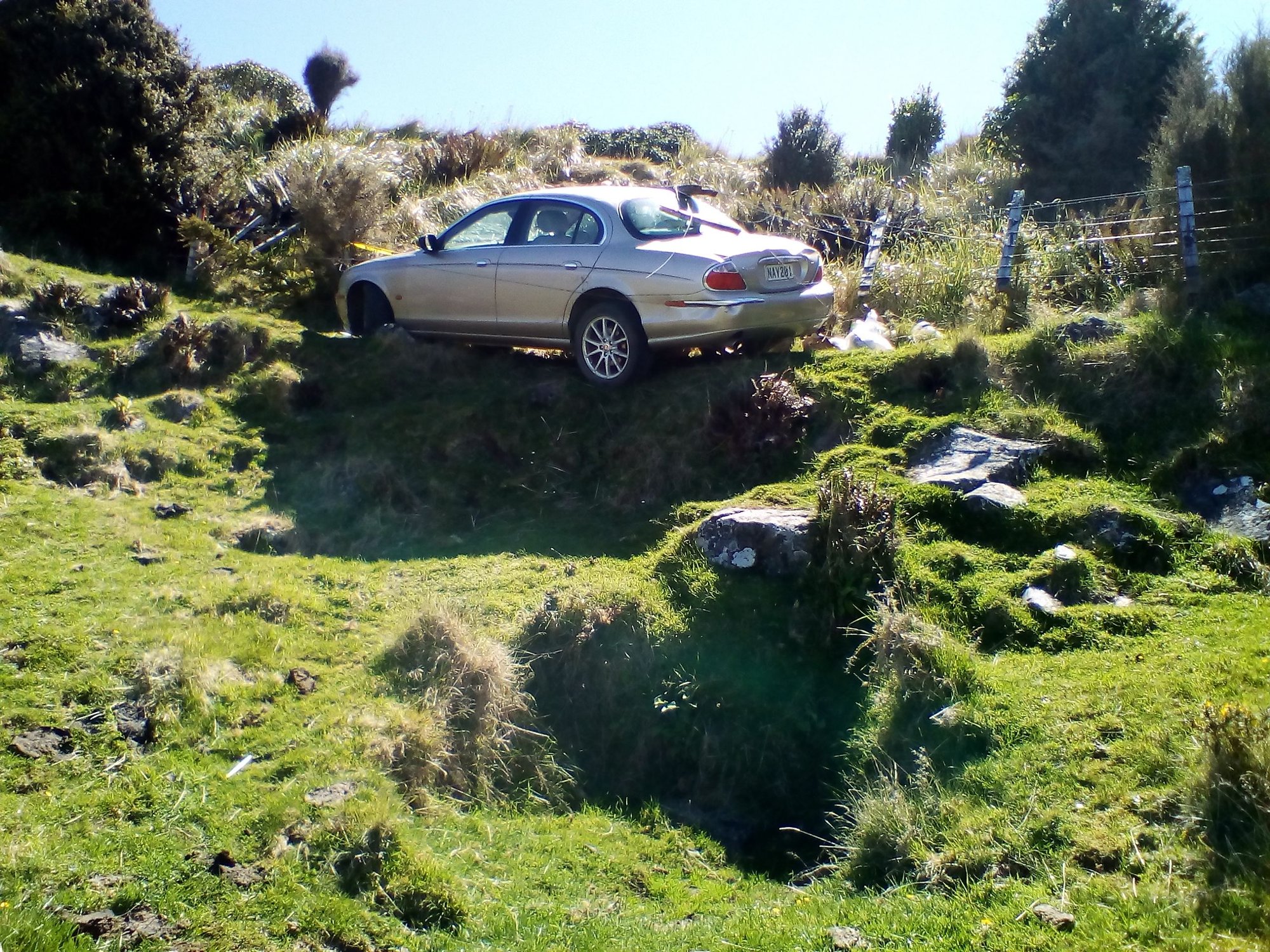

P.S. the James Bond style final position
Held by one strand of fence wire (and beached on a small boulder).

Wow, you were not kidding when you said the car rolled! I thought you meant it had rolled a short distance in your driveway, perhaps until reaching a conveniently situated pile of pillows.
We may never decipher the exact sequence of events that caused the car to hold initially and then roll. My hunch is still the transmission was not fully in park for reasons unknown. Loose cable? Lever not fully at the end of travel? If it had bumped out of the detent, it would have been in reverse. We may never know for sure. You mentioned the P legend on the bezel was illuminated, but was that after the fact? Maybe the impact upon landing bumped the lever fully into park, unfortunately too late.
