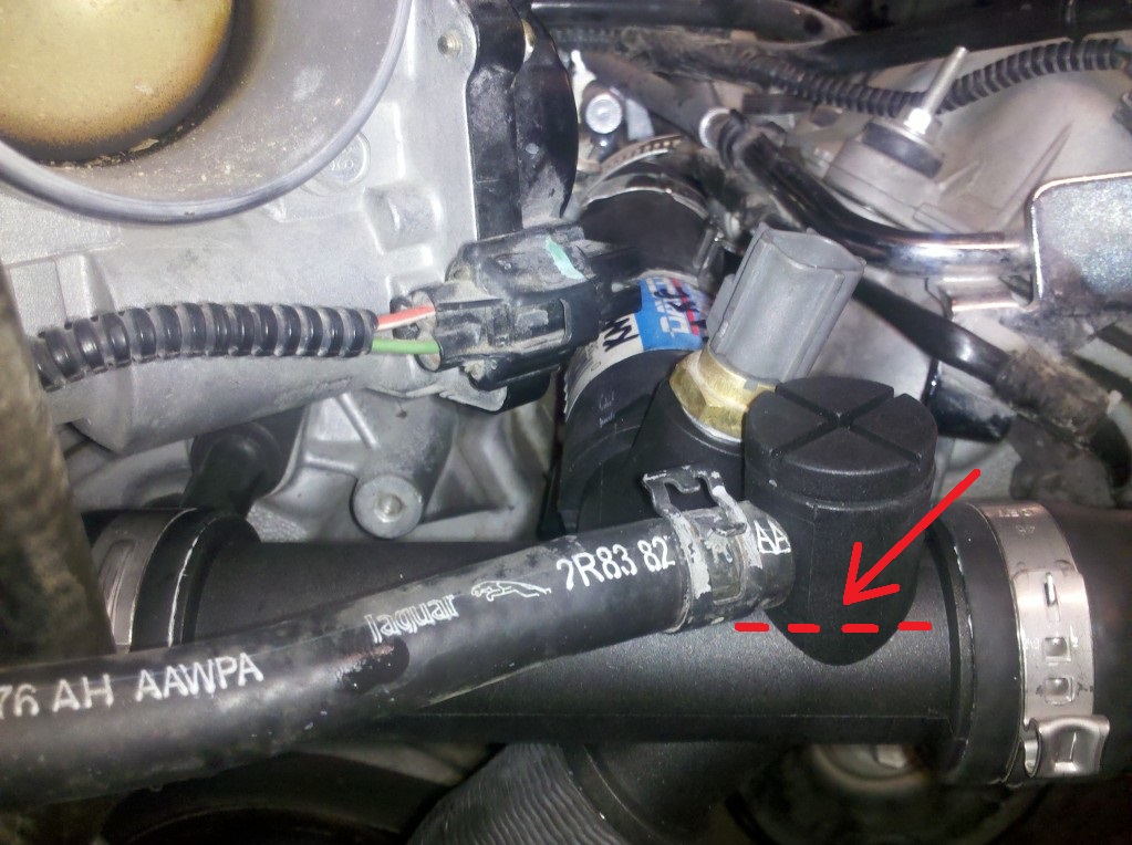

Can someone draw on the photo where this failure spot is and where to place the epoxy perhaps?
Here you go Bob. The turret design for the 2005 3.0 is a little different that Zanes above but it is very close. It almost looks like there is a purge screw on this one.

Jon, Norri is correct, the turret part pictured above above the red dashes just blew off the hose assembly. Kind of what a tank turret would look like if you removed it from the tank body. There was NO dripping or any sign she was going to blow. Upon removal the turret portion did indeed crumble under the duct tape. Again the 2005 turret is a bit different but pretty much looks the same as aholbro (Zane) has pictured. The 2005 does not have what looks to be a purge (bleed) screw on top the turret.

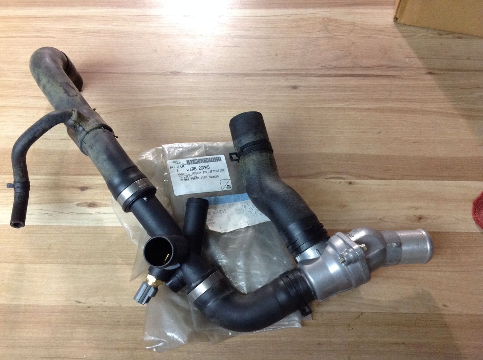

Here is what I paid $80.00 for which included next day air from La. Everything you see, brand new.
Jaguar Part # XR854920 is what Norri has pictured above and DOES NOT included the thermostat housing.
Jaguar Part # XR826065 DOES include the thermostat housing.

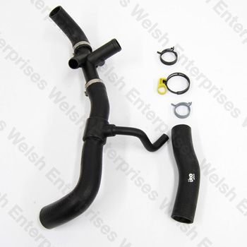

here's how the orig. Jaguar part fails:
Here's how it will look if you replace it in time:
and the first pictures posted WERE actually on the 2005 MY, not the 2003, but it was a part obtained from Rock Auto for $62.99: Uro XR849446
(I did have to swap the old temp-sensor onto the Uro part...it came with one, but didn't match the wiring connector) See the telltale "make from" hose from this thread? https://www.jaguarforums.com/forum/s...p-3-0l-126574/
(Just to confirm my memory, I popped the bonnet on the 05 and that's it)
