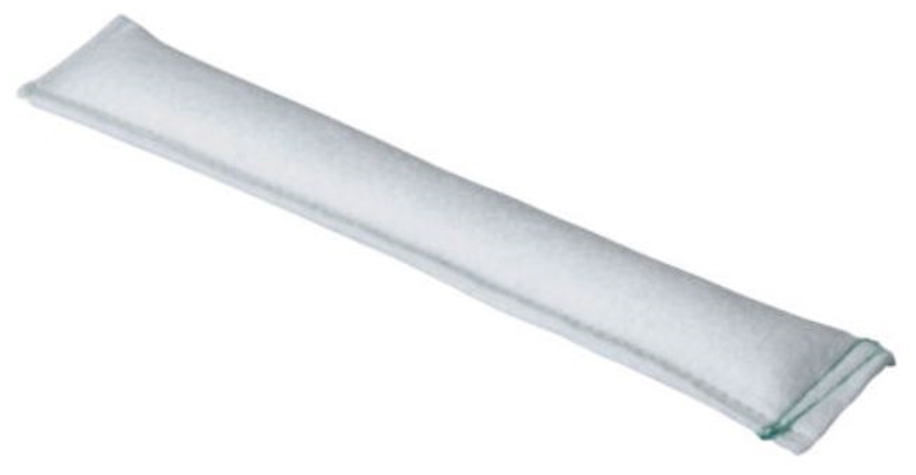

Please check me because it might be transmission fluid but I just fixed this on my 2005 STR.
It's A/C system dye/oil. Your A/C compressor is leaking oil from the case seals. The compressor is pretty cheap at about $300 with no core. But I found it a SOB to change and did it different than what the instructions in the JTIS said.
I also verified that the A.C. Compressor is identical to the 2003-2006 V-8 Lincoln LS. So no problem getting the correct one. The 4.2L N/A and S/C used the same one too which further simplifies it.
Don't forget to change the dryer desiccant bag. This was new to me and I had not run across it before. It was a change from the early 1999-2002 cars that had the normal little Aluminum canister type. It comes sealed and says do not expose to air for more than 5 minutes. You get the old one out and then pop the sealed bag and install the new desiccant bag.
Here is what it looks like. Pretty cheap at about $20-$35.
