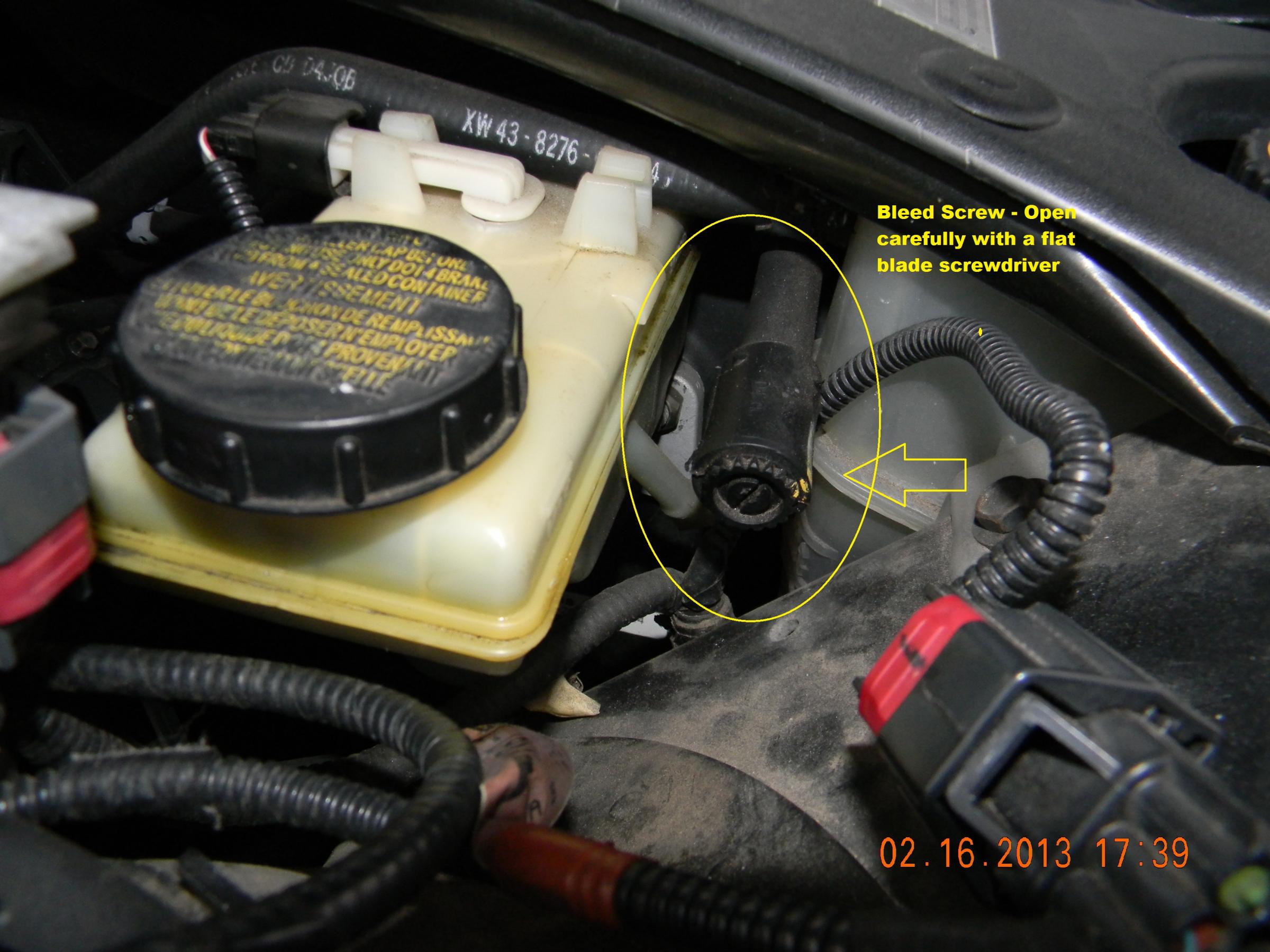

There is a bleeder hose - it is probably tucked between the expansion tank and the master cylinder. +1 on JTIS diagrams...

Originally Posted by Derek1
I only have two hoses on my expansion/header tank I asked the mechanic that fitted it, one on the bottom and one from the top of the 9kn or whatever the torque setting is on the allen key screw at the front where you top up the water when starting to refill. There is definitely no bleed screw on the return.Regards Derek
Derek, look at the attached picture. This is what I was referring to. Hope this helps...

Ah yes I see what you mean, and no I dont have one of them. I gave in today after 8hrs burnt fingers and half a tank of the lovely petroleum. I phoned the mobile mechanic back and he is coming round tomorrow morning. Thanks for all the tips.

Tha bleed hose has to be there - this is the only way to properly bleed the cooling system (and keeping your fingers intact also) Sometimes this bleed hose is tucked in really good between the master cylinder and coolant expansion tank. This hose is the highest point in the cooling system (even higher than the thermo housing fill cap) - find that hose, unscrew carefully with a large - flat blade screwdriver - search the forum regarding "bleed procedures", follow instructions, be careful and you should be all set. Don't overtighten - there should be a mark on the plastic screw cap and hose - match them up!
