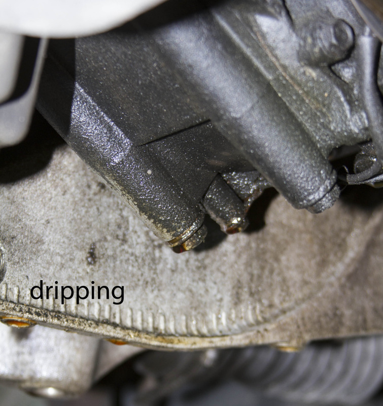

Thanks very much for the reply. I mentioned some humming up front especially when turning and took a look at fluid levels and my power steering was very low. Went under the car and found some dripping. So now need to figure out where the leak is.
When driving the car, do not hear the noises you hear on the video. I wish I could tell you a change in sound when an increase or decrease in power, but really do not hear one. The car sounds for the most part, normal. If a bad bearing on the power steering pump would it cause the leak? I did record the video I think when the fluid level was down on the steering. At 120 thousand, expected some things to break down so here we go.

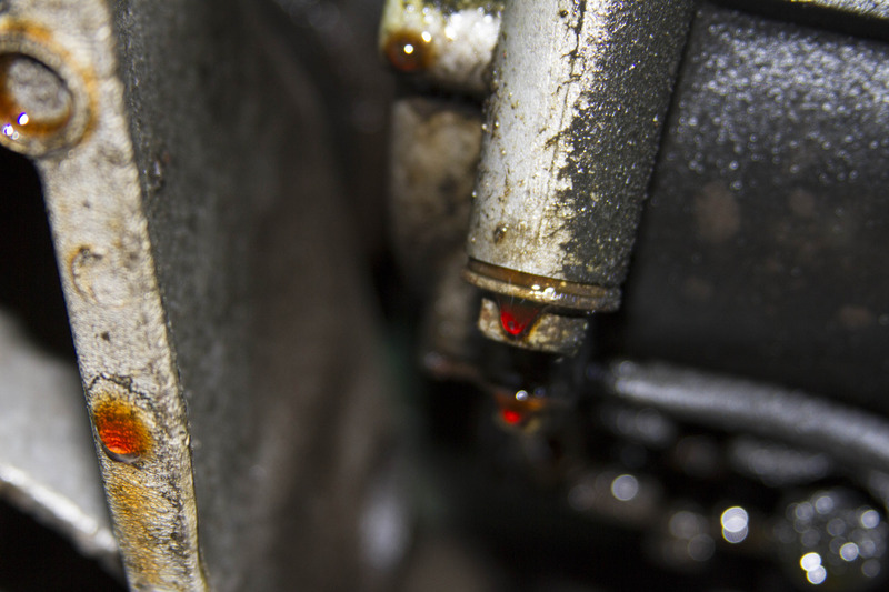

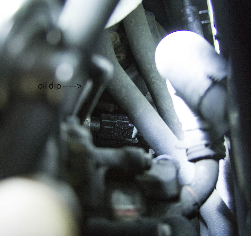

This picture is taken looking down at the engine. I point out the dip stick position. I saw fluid around that connection piece that is in focus so it must be spraying a lot of places.

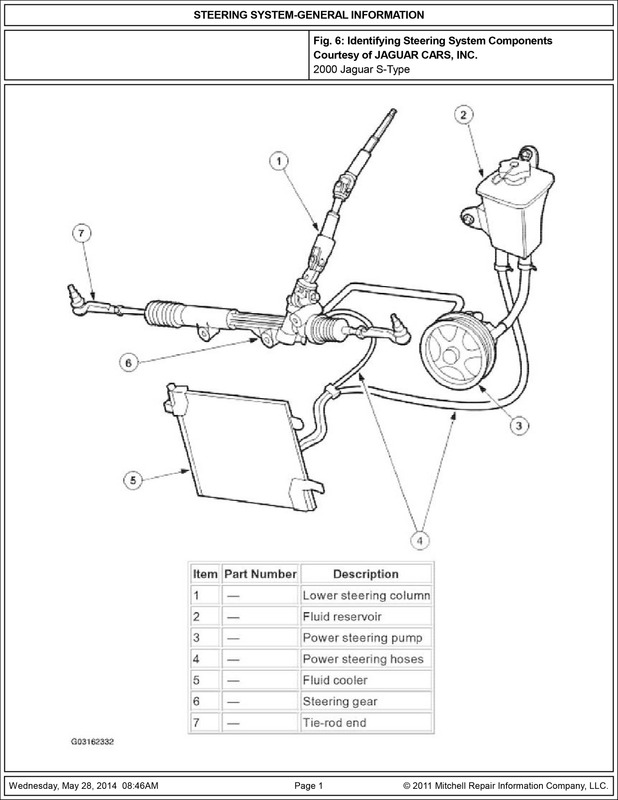

I use JTIS but find Mitchell on demand goes into a little more detail on what to look for and how to repair.

I would note the leaks/weeps. Wash it down.
Refresh the fluid a few times.
Renote the leaks/weeps.
Often some fresh fluid does wonders, the rest of the time NOTHING. If yours becomes the latter, dig deeper if it really bothers you and is a major concern.
Replace that belt. It is called for at 100K kms down here.
Once that is all complete, re-evaluate the noise/s.
