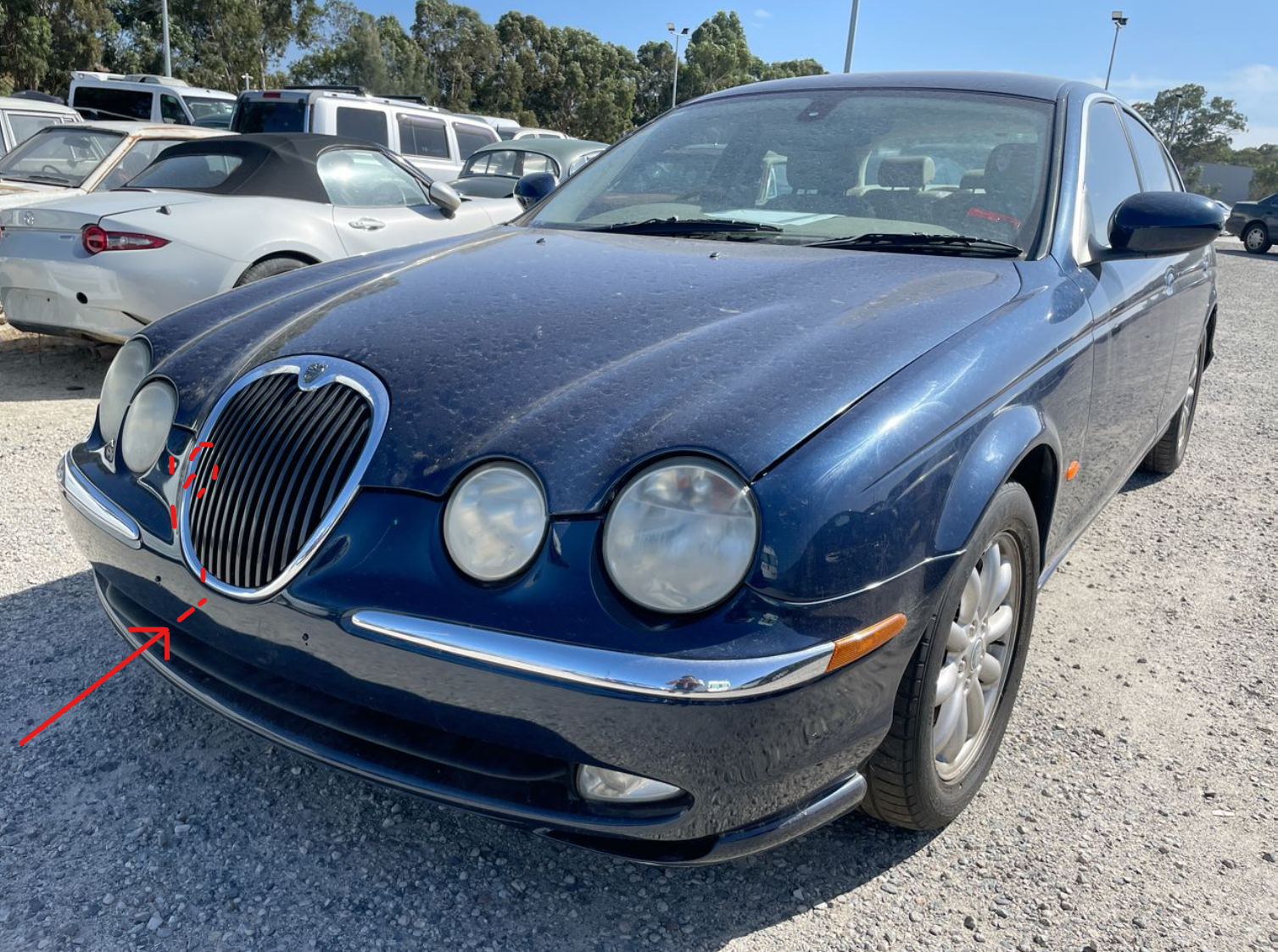

Mine broke on one side on my 2003 S-Type 3.0. I discovered I can reach in from the lower bumper "scoop" thing and actuate the release with my finger. You may need to remove the black center piece in the scoop first.
On your '06 the front bumper, anti-theft (if equipped, mine is not), etc. may be different so YMMV.
