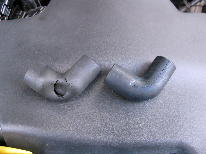

Brutal you were dead on! I replaced the elbow and got it all together and at the present time it is running great, no extra parts. I will try to make a procedure when I get time. Thanks for your help!

I have been driving it today and I think I did OK, it seems to be running better. I started the job around 10am and finished around 3:30pm, I also had to get the elbow in that time. I would like to take all the credit but Brutal provided details that made the job go quickly. Thank You Brutal! I hope to have a detailed procedure in a few days.
