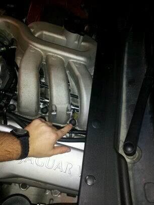

So this past weekend I tried doing some maintenance on my 2001 S-type. I tried to remove the intake manifold and one of the bolts is stripped and will not come out!! I spoke with someone at a Ford Dealership and he stated that in the past they had to buy a new manifold. Is this true? If so, anyone know where I can get one?

Which bolt is stripped? Do you have a picture?
There may be options for repair once we can see what's broken.

Okay I will post one for sure. I am working the Fire Station today and for some reason Photobucket is blocked, so I will in the morning.

Just pull the intake up with all but that one bolt removed. The brass insert will come with it. Then take pliers and hold it and unscrew the bolt. It just came unseated from the plastic fuel injection manifold. Epoxy the insert back in the hole with plastic epoxy. Do not use jb weld it doesnt stick to plastic. Make sure you do not get excess epoxy in the threads. Then when you bolt it down put the other bolts in first and put alitttle lube on that one and easily snug it. Youll be fine, fix these like this all the time. Welcome to the wonderfull world of plastics
Size:  22.7 KBName:  manifold1.jpg
Thanks for the tip!! I will give it a shot and see what happens!
