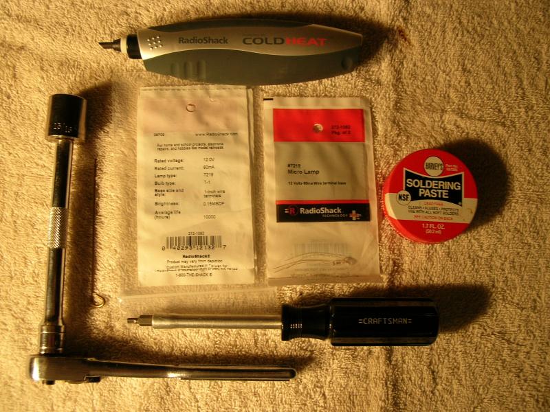

In my daily (the Caddy) the little micro bulbs are a known failure in the steering wheel radio control buttons. I had replaced the bulbs for .99 cents for 2, (2 bulbs required per switch), rather than spending $300.00 for 4 new switches.
The following is what I used and would use in Joyces Jag if required.
Disreguard the ratchet and nut driver.
Here is on of the Caddies switches dismantled:

Thanks Rick, I repaired radio fronts a view times with these bulbs. But also noticed sometimes the presence of micro led welded on. These Micro led are hard to replace the welding is so very small.
I will make some pics of the S-Type Switch inclusive the result.
Ciao William

William that is why I use my "cold heat" soldering gun rather than my conventional plug in guns.
The "spot solder" on these are so tiny, a very quick touch and the bulb just pops out with the dab of solder along with it.
