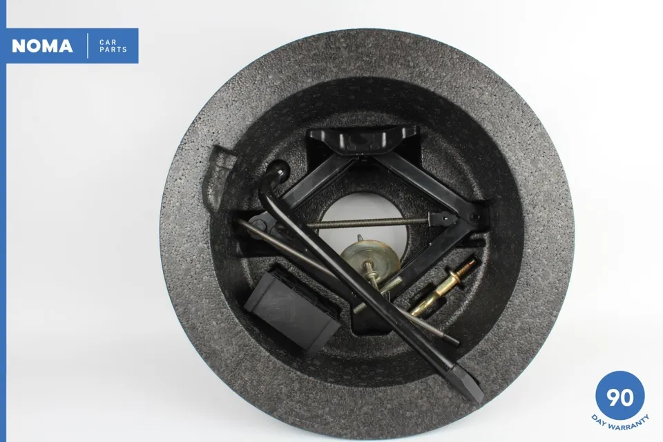

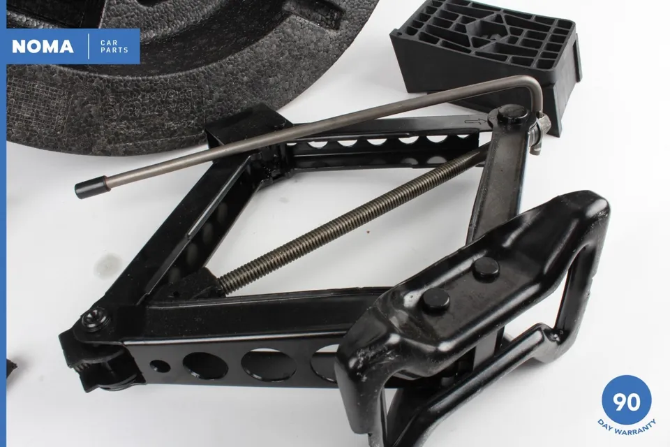

Yes. eBay is your friend for good pictures, even if you purchase a jack elsewhere. Here's one example, many more with a quick search:
https://www.ebay.com/itm/235377459144
Image stolen from eBay

You may have the earlier rectangular type polystyrene tub rather than the later round type shown above by kr98664.
The earlier type requires that the jack be wound down to fit in the cavity. I had to change jacks as the original had started to double thread would you believe; easily kill you..
Went to the (now unfortunately closed local wrecker) and bought another genuine Jaguar S Type jack. Came from an X204 V6 and I noticed it had a sticker on the jack with the words "S Type'.
Not that easy with fleabay in this country; see if you can buy a genuine one from one of the local wreckers. Probably the same as the XJ and X Type; others will confirm.
Yes, we all know the wheel spanner is a joke. Good as useless and guaranteed to ruin the rims and nuts. Do not use. Buy an extendable socket type and only use a 19mm socket. Socket as narrow as possible and wrap some good tape around the socket end to avoid chipping the paint finish on the wheels.

thanks guys, a picture speaks a thousand words, or something, someone said
now i know what to look for

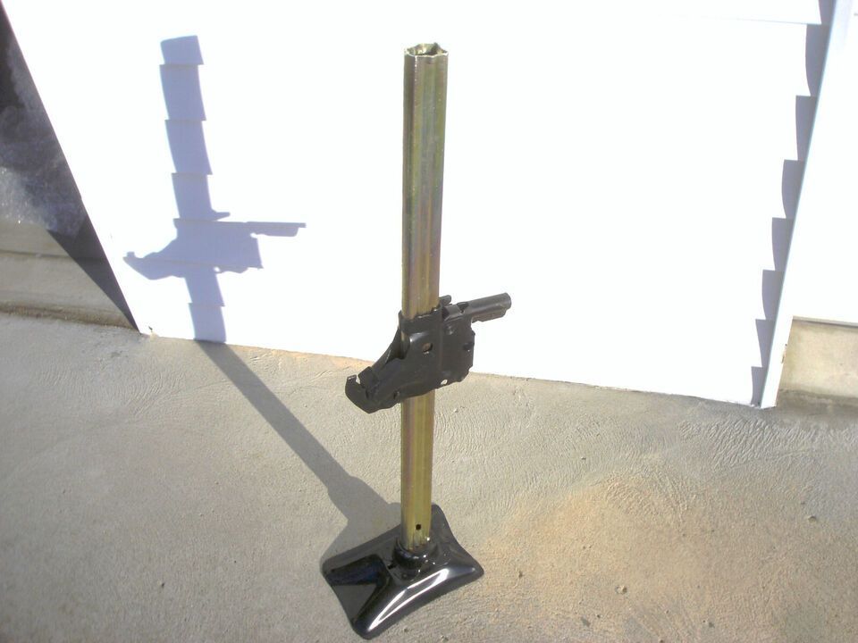

Many moons ago we used those stick clicking jacks that fit on those old chrome bumpers. They had a little lever to go up or down. Yes, we got under a car with those jacks. Damn, we were dumb. If we were taking an engine out, we used 2 of those jacks.

sounds like what we call kangaroo jacks over here, they are about 4 feet tall

I think that is the one. Here is a photo of one of these wonder inventions.
