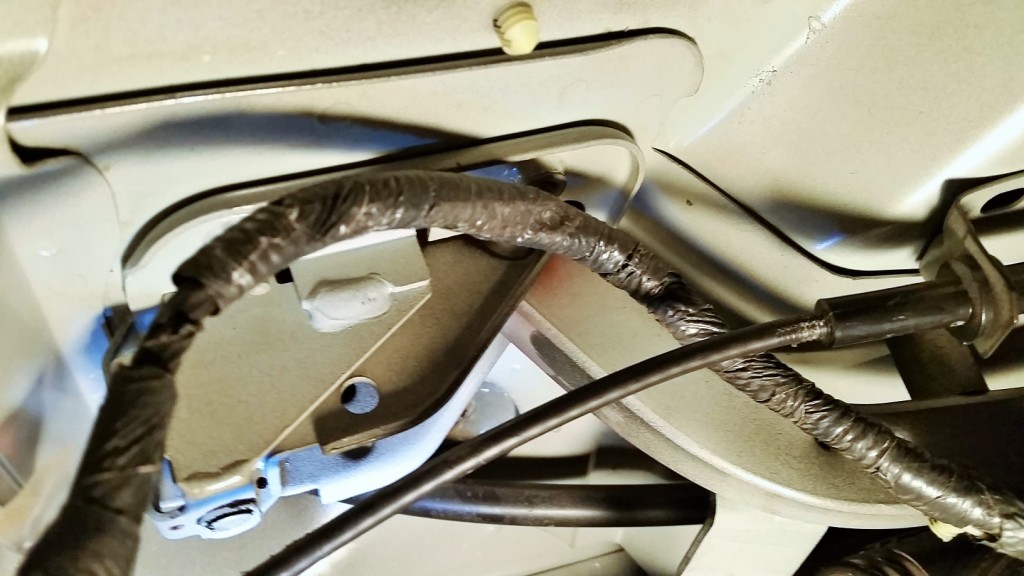

One error in my last post. The loom is not responsible for the reverse parking aid problem, I got carried away there - that turns out to be the dreaded water in boot problem causing the module bolted in the wheel well to fail. That was caused by a split boot lid rubber making the seal very weak at the bottom corners - took ages to find, just lift all off and rotate the whole deal 180 degrees - solved....
The picture shows the area where the loom really gets flexed by the boot hinge. Eventually the wires fail because of fatigue. Soldered new sections of wire in place - now interior boot lights go off when they should, also means boot release now works again......5 wires were broken, some with the insulation still intact - just pull a little you'll see!
Oh BTW this problem starts with intermittent alarms from the car when parked and locked (because alarm thinks boot has just been broken into as the wire breaks intermittently!!) But I put it down to high temperatures messing with the ultrasound in the cabin......only now do I realise that was connected.

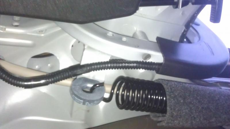

I had similar problem with trunk light staying ON. Lately info "TRUNK AJAR" was displayed. Also I had two unexplained sound alarms.
So I changed trunk switch- nothing changed. Also got to clean contacts,...
Anyway finaly I climbed to trunk(had to remove speaker box) and dissected the harness .
Three wires were broken. Rest of 8 wires had some cracks or damage on insulation. Quite a mess. All result of mechanical motion of harness loop.
I soldered the three wires and so far so good.
I am now thinking what to do for long run... change all section of wires to recommended high flexible multistrand wires?
I also noticed temperature from existing incandescent 'Edison's age' bulb.
So I changed to more modern and less power LED type; and added another LED trunk light to driver side ( while soldering iron was hot...).
Attached Thumbnails Jaguar S-Type Trunk light on all the time.-1x-jaguar-2001-s-original-harness-trunk-20150323_131510-2-dc.jpg   Jaguar S-Type Trunk light on all the time.-2x-jaguar-2001-s-trunk-open-harness-3-wires-broken-20150323_132838-2-dc.jpg
