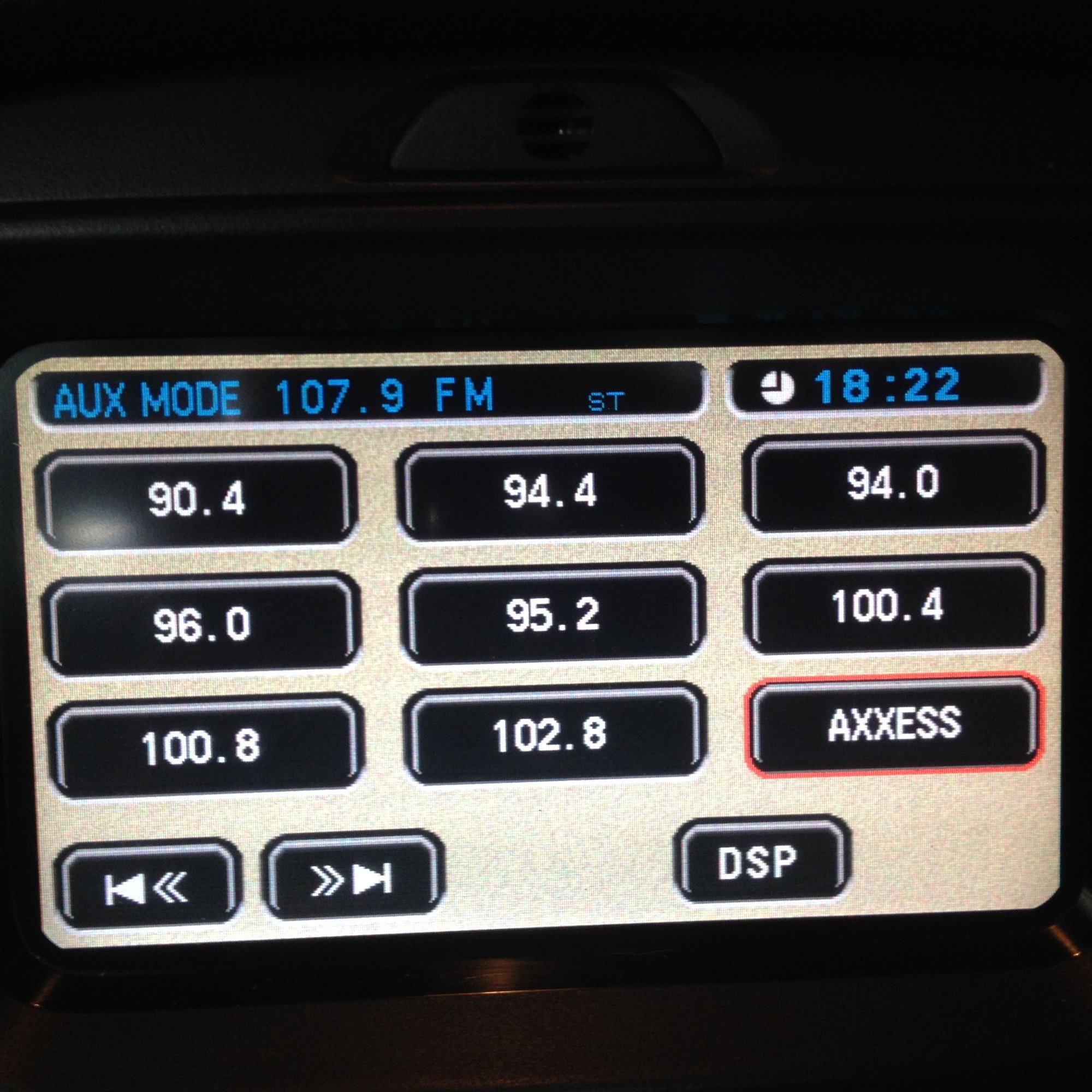

i also have installed one of these . far better sound than a parrot . but not quite as crisp as the veffbox.
it is FM modulated with hands free, and may be the best FM modulated kit i have come across .
its affordable , easy to install .
has bluetooth in .
3.5mm RCA in. male or female.
and RCA in
comes with a flush mount usb charge port . i mounted in the arm rest center console .
mic and cable . it has a switch to internally disconnect the antenna when powered on . to reduce channel interference .
and 3 frequency choices .

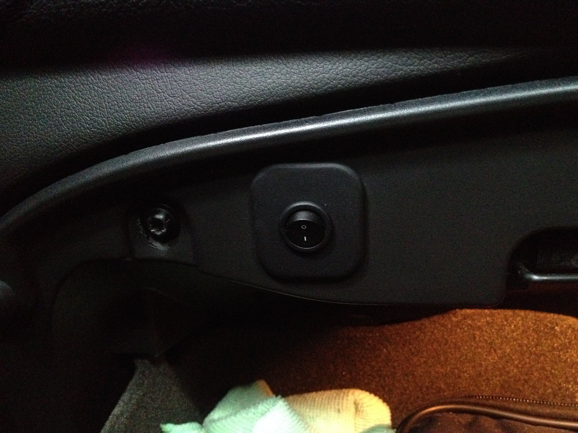

on/ off bypass switch in glovebox
