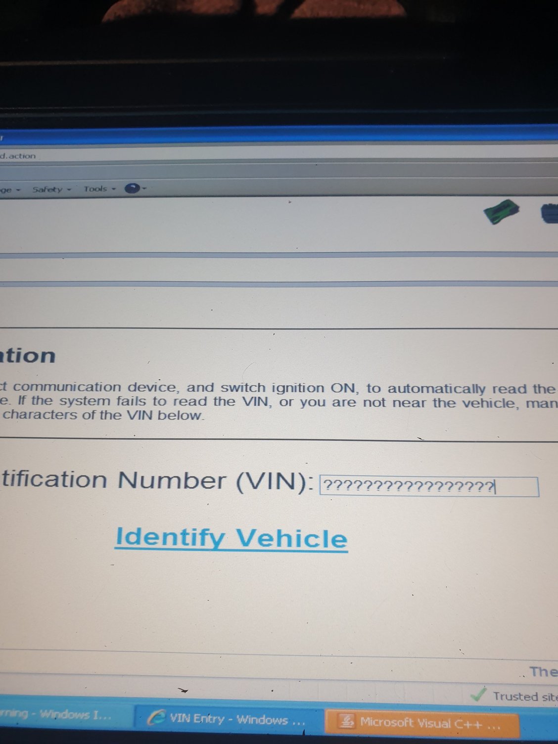

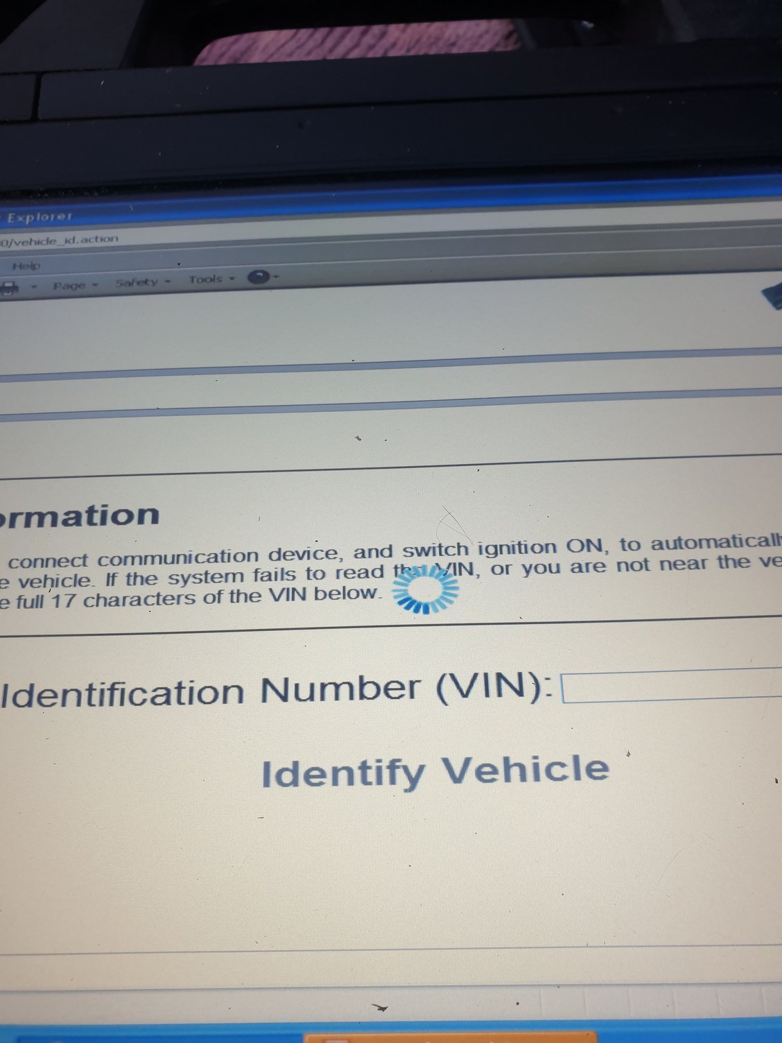

so got out the JLR IDS SDD MONGOOSE
AS some of you know it reads vin automatically
Well mine came up?????????????
Can not read vin
I entered manually Exactly the same please enter correct vin

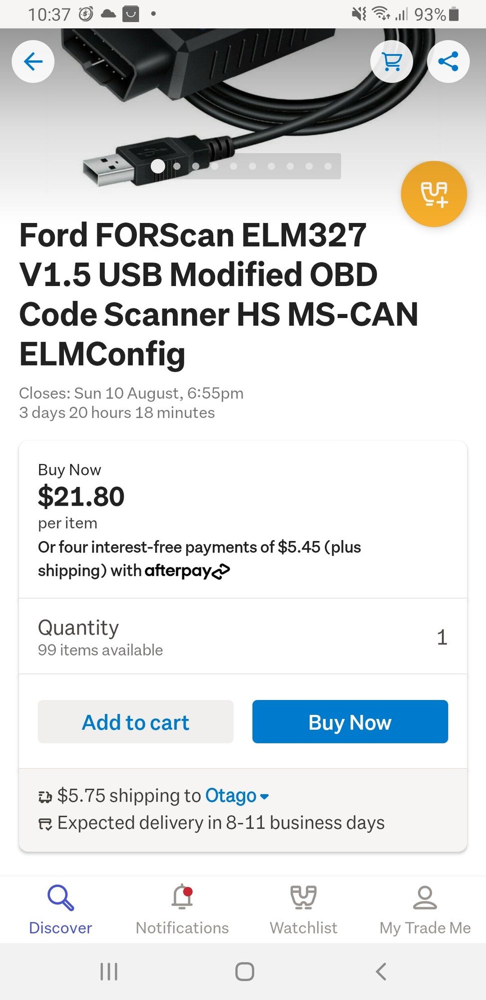

The main problem is in New Zealand it is hopeless finding scan tools
We have a platform similar to eBay ect yes they advertise them all
But you go to purchase one it always says shipped from overseas please allow 10 to 15 day for delivery
The only one I have found locally is a I carsoft but I already got one

S-Type owners do use the iCarsoft. IIRC it has settings/menus and can be made to do the right protocol - trawl through some threads or just mess with its menus.
The Forscan elm is probably overkill but should work so long as you have a PC (with Windows) as it is USB.
