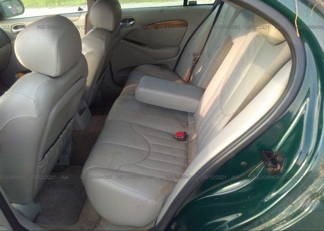

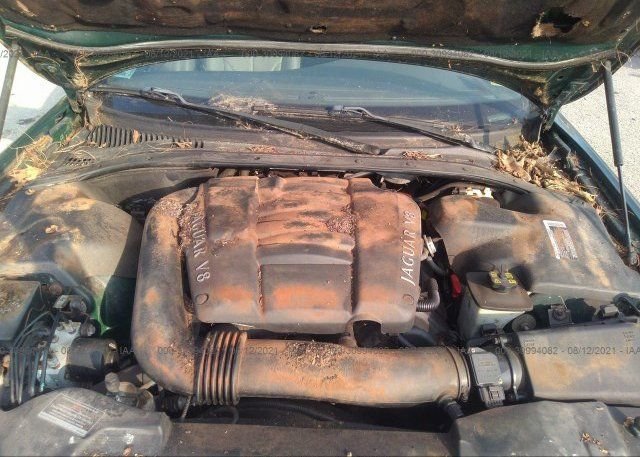

I came across this car while perusing my local salvage car auction. Although it's in rough shape and had mice living inside of it at one time, I was able to put a battery into it, top off the cooling system and drive it about 60 miles at highway speeds with only minor issues.
Idle was rough but after fresh fuel and some highway driving it smoothed out and seemed to drive flawlessly. Then, the check engine light began flashing about 5 miles from home. The engine didn't stumble at all or sound any differently but I'm going to see if any codes were stored since the light didn't stay on.
I had the chance to do a preliminary wash and plan on doing a tune up, filters, and new coils this weekend for preventative maintenance. I'm really hoping that there isn't an oil leak causing the spark to short out.
The head liner, clear on the roof and hood are failing so I want to address that once I know for sure if the engine is good.

When I had my 2001 X200 4.0 I kept a few on-plug ignition coils with me in the car as spares.
I replaced DOZENS when I worked at the dealer. The 4.0 coils were always changing part numbers and getting 'superseded' at a blinding pace from Jaguar.

Originally Posted by 04STYPENH
the check engine light began flashing about 5 miles from home…
The light flashes to warn of a misfire bad enough to cause thermal damage to the cats. Don’t continue driving like that. Most likely you will find one or more misfire codes have been stored.
Don’t panic about oil collecting in the spark plug wells. The preferred fix is to replace the gaskets for the valve covers, of course. But since you’ve got other issues also requiring attention, you can usually just clean the wells and spray the coils with some electronic cleaner. Unless the oil leak is a gusher, that will usually buy you a few months.

JagV8's Avatar
Posts: 27,531
Likes: 4,915
From: Yorkshire, England
Next URGENT job is check - and probably change - the chain tensioners. You almost for sure have the brittle plastic ones and if (when) they let the chain go your engine is toast. You need the metal-bodied ones & associated pats - use Search and read up.
Lots of parts changed in 2002.5MY so don't expect to use many parts from cars after that.

just do the secondary tensioners coils and the valve cover gaskets at the same time.

If the MIL is flashing, catalyst damage is occurring. Find and correct the misfire(s) or you'll be seeing P0420 and or P0430 DTCs.
