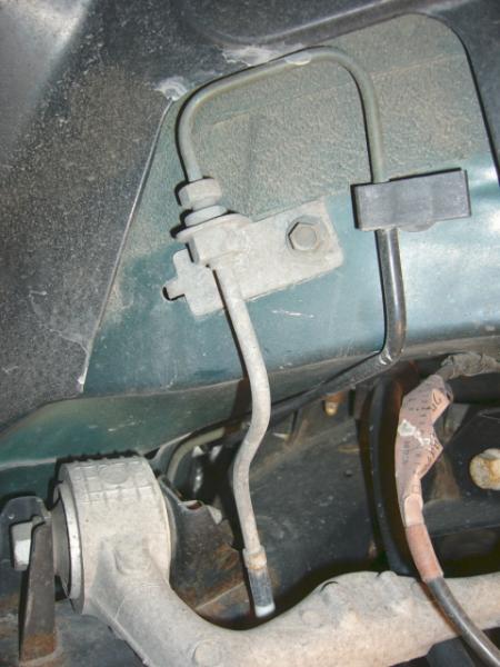

I don't wish to be a pedant but:Originally Posted by Mikey
You sure?
1.I am sure my car has SS brake lines.
2.I cannot verify that they were installed at the Jaguar assembly plant(I was not present at the time).
I have owned the car for about 7 months,every part I have looked at on the car is Jaguar--even the battery is Jaguar(made by Varta in Germany).
It is possible that someone changed the brake lines/hoses.I have attached pics so you may judge for yourself.

I think you may be right. I put my car in the air today and looked at them again. They seem to be hard, but not like hard rubber, with a plastic shield over them. Only way to be for absolute sure is to dissect them off the car. I figured they were just rubber, my brakes are quite mushy and I know rubber lines will cause that issue. I may be looking and another problemOriginally Posted by Six Rotors

I did rear brakes on a 2000 the other day, and they are for sure standard rubber lines. And yesterday I took all the wheels off my car to flush the brake lines and I am confident they are stainless lines. They have a clear plastic shield over the top. They were just so dirty they looked black! I guess I should have looked before. But must be Jaguar started SS lines in 03 on the S-Type
