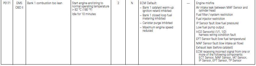

Hi andy,
Here are the definition and possible causes of P0171:
Even though you only have a Diagnostic Trouble Code for Bank 1, both of your banks are running lean, so the most likely cause is an air leak in the intake plumbing somewhere between the MAF sensor and intake manifolds, or a vacuum leak. If you can't find a crack in a plastic or rubber hose or a loose connection, a smoke test may help.
Are any other DTCs triggered that might provide additional clues?
