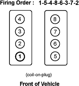

Old Jun 15, 2017 | 11:12 AM
unpredictable1's Avatar
Joined: Jun 2017
Posts: 56
From: Canada
Originally Posted by JagV8
Any chance of a mistake over which one is cyl 6? (It would explain why nothing changes.)
6 is the second one on the driver side from the front right?
Either way, I can plug and unplug that coil while the car is running and symptoms don't change. If I unplug any other coil, the misfire gets significantly worse.
Old Jun 15, 2017 | 11:23 AM
JagV8's Avatar
Posts: 27,532
Likes: 4,915
From: Yorkshire, England
If you can do that then I'd say it's that one and you're back to figuring out the actual cause. (BTW it's not apparent to me which side your drivers sit, but #6 is bank 2 (as per international standards) and ought to be the third one from the front. You seem to be saying cyl #4.)
Old Jun 15, 2017 | 11:40 AM
Joined: Jun 2017
Posts: 56
From: Canada
Forgive me since I totally forgot many of you have vehicles that are right hand drive. This is a left hand drive vehicle.
Hrmm - is this not the proper order?
edit: I had used several of the links on this board for the 4.0. Pretty sure I'm looking at the right cylinder - or I need a bucket of coffee haha
https://www.jaguarforums.com/forum/s...misfire-58838/
Attached Thumbnails P0356 after new coils and plugs, have spark confirmed on cylinder 6 RESOLVED-ironfist109_88.png
Old Jun 15, 2017 | 12:11 PM
JagV8's Avatar
Posts: 27,532
Likes: 4,915
Sorry yes should be. It's before they use the standard. (Hopefully they didn't change the software yet leave the diagram as it was! You could test by swapping a coil for #7 in that diagram.)
