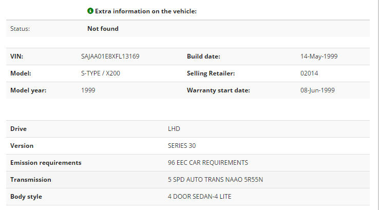

Your car is an early version, known as an X200, and has the Ford 5R55N transmission fitted.
