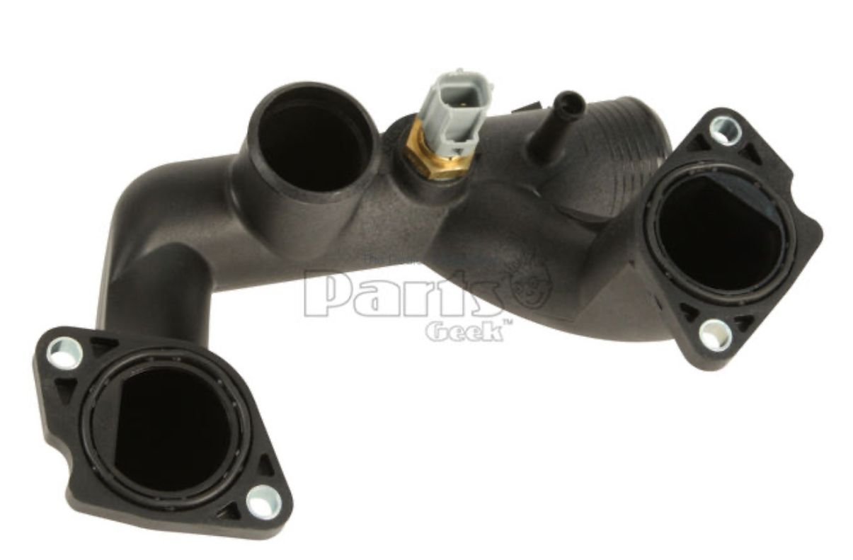

Anyone have to replace a water outlet pipe for a 2000 S type 4.0?

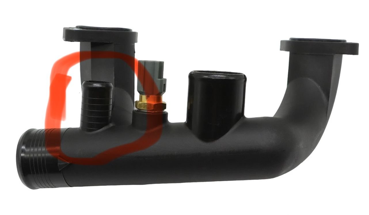

The part seems impossible to find new or used. I’m wondering if the XJ8/XKR 4.0 L version would fit. It looks the same in photos, but one nipple is larger. If it otherwise fits, I figure I could modify a hose to compensate this size difference.
Water Outlet Pipe AJ85884
Top photo is s-type
Botttom photo is XJ8 version

The coolant outlet (heater feed for the AJ26/AJ27) is the only thing different about the outlet pipe you need. (AJ28)
I did not realize they were unavailable recently.
Wish I had known so I could have stocked a few for customers.(I have a few with AJ28 engines)

I was also shocked to know the part can’t be found in stock. Really didn’t want to go used since I figure if mine busted, other original ones may be getting fragile too. Going to give the XJ8 version a try.

aj27 outlet and a hose barb reducer. that or you use an aj30 outlet xw4z8a520af and drill + jb weld your coolant temp sensor in there
