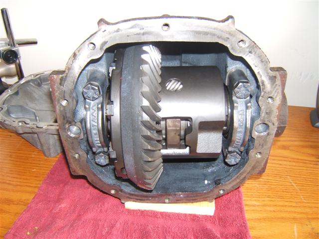

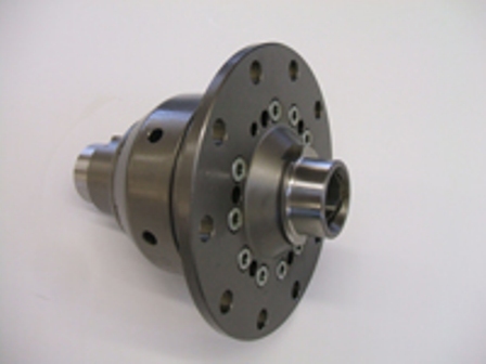

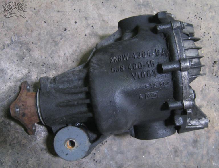

I have a 2003 Lincoln LS and a 2005 STR. The rear ends look identical but I am not sure?? Here is some pictures of both units. See what you think?? I have added a picture of an XK LSD which I know will NOT work.
Attached Thumbnails See a lot of LSD threads with no answers...-lincoln-ls-torsen-differential.jpg   See a lot of LSD threads with no answers...-2003-s-type-r-rear-differential1.jpg   See a lot of LSD threads with no answers...-2003-s-type-r-rear-differential.jpg   See a lot of LSD threads with no answers...-jaguar-lsd-xk.jpg

Thanks for the pics!

Here are some pics I found......from a 2003 STR

They look to be the same, Im gonna try and see what the part #'s on mine are.

More good pics - thanks!
