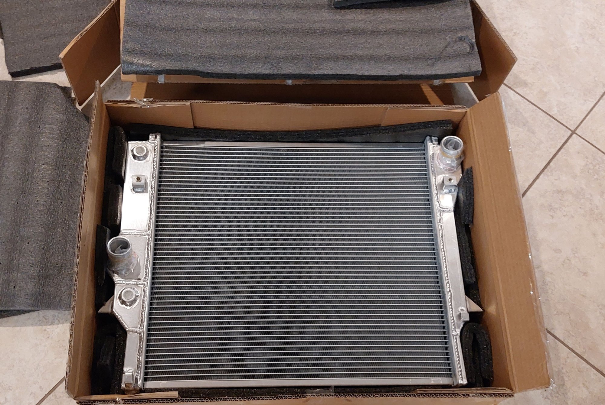

Has anyone had a good experience with an all aluminum radiator for the S-Type R?
Most of the 1, 2, or 3-core all-aluminum radiators available online are thicker than the original single core radiator. As many of you already know, real estate is quite limited between the supercharger pulley, overflow tank, radiator, and the front bumper assembly. Especially with the dual zone climate control valve mounted in such tight proximity to the radiator. None of the manufacturers I've contacted so far can 100% confirm fit inside an S-Type R model, only in the V6. So, I'm hoping someone here in the forum has found a brand that fits the supercharged R. Any help would be greatly appreciated.
Side note:
I've ordered the Nissens radiator from RockAuto twice.
Unfortunately, each arrived with badly broken mounting brackets and other damage, on both occasions. RockAuto even refused to offer me a 3rd radiator as replacement, opting instead to give me refund straightaway "to avoid any further return shipping charges." The factory packaging from Nissens is woefully insufficient, leaving the radiator loose and free enough to slide around almost 3" side-to-side with very small, inadequate packing foam blocks to protect the delicate plastic brackets on the plastic tanks. The inside packing material was also badly damaged in both. Of course, FedEx didn't help by abusing the boxes in shipment. (They are the worst!) It's no surprise that neither radiator survived the trip. Anyway, I'm hoping that a more robust all-aluminum radiator can survive shipment to California. Those cheap $90 replacement radiators at the local auto parts stores just won't do.

Classic_Engr's Avatar
Posts: 88
Likes: 36
From: San Diego, CA
Default All Aluminium radiators (NOT Nissens, etc.)
I appreciate the attempts at replies. However, neither reply even addressed, much less answered, my question. Again, my question was, did anyone have any experience with the alternative high-performance ALL ALUMINIUM radiators available online? It seems the answer is "No." So, I decided to venture forth and buy one. I received it late last week. I was smart to consider all of the dimensions so that it will fit with the 4.2L SC V8 in my S-Type R. So far it looks great. And, unlike the Nissens, which came in horribly cheap and inadequate packaging from their factory, this one arrived in one piece! Excellent packaging! I will attempt to install it this week, complete with photos and possibly video. More to come... 🔧
