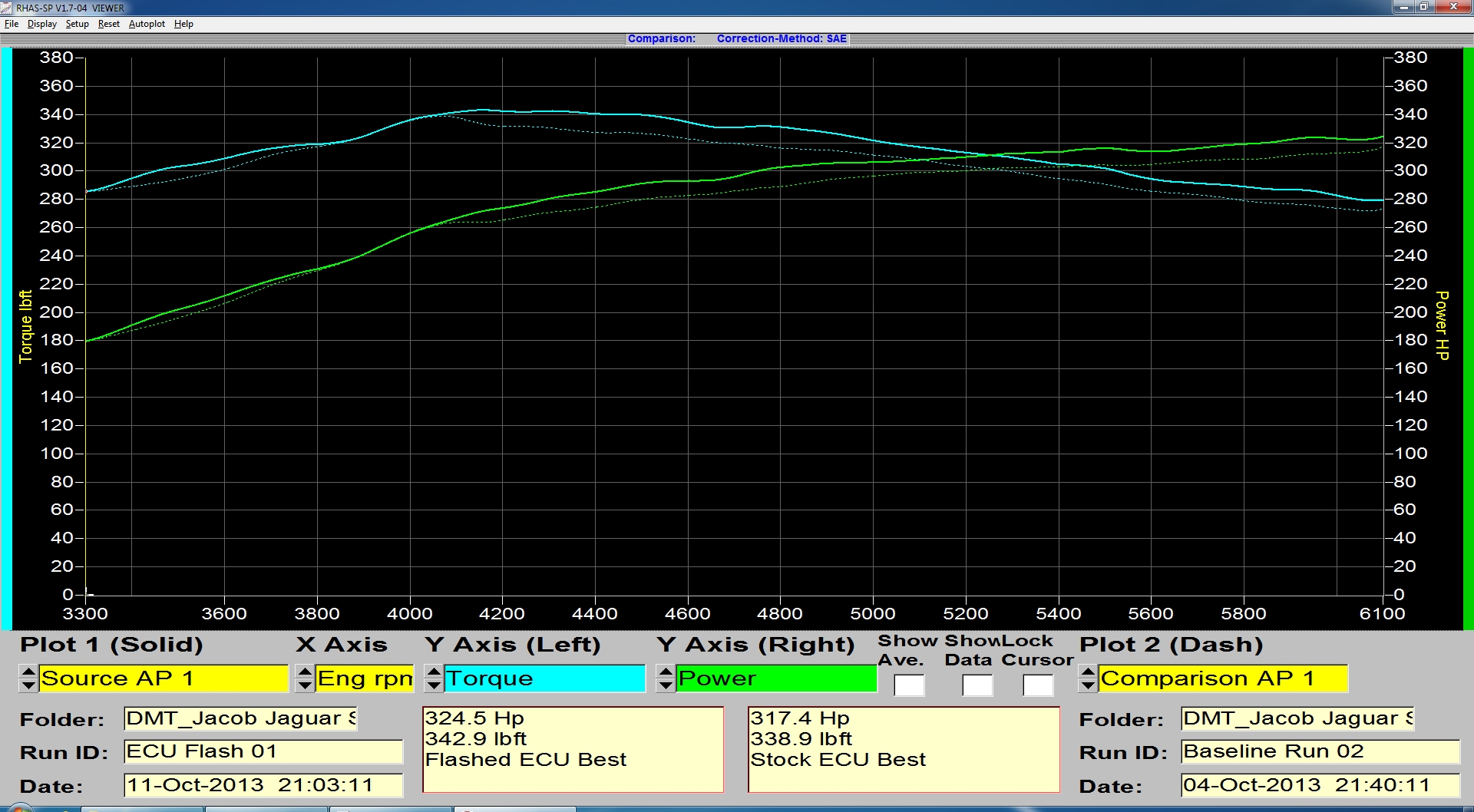

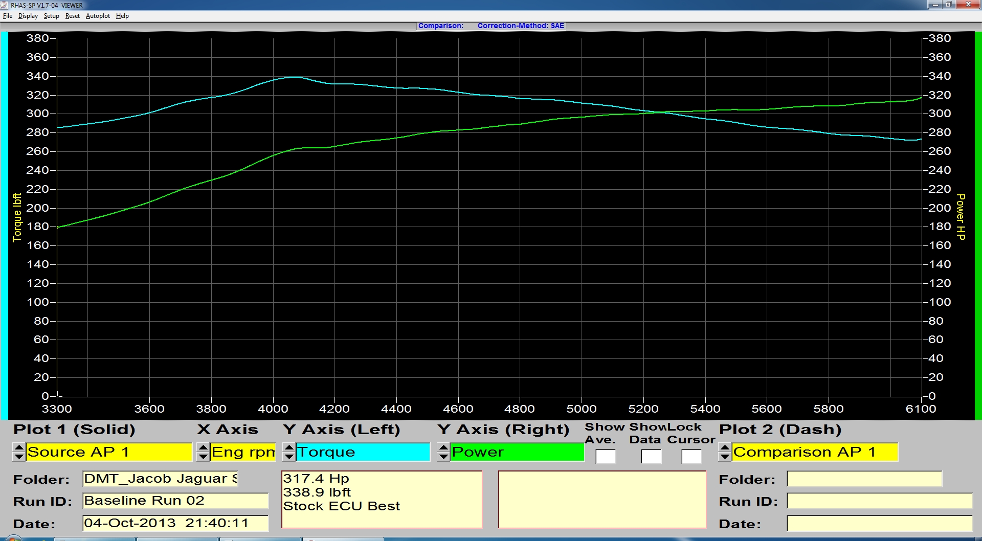

Ok guys, my apologies for keeping you all waiting, the Thanksgiving day long weekend really had me sidelined,
So on Friday evening, I returned to the dynamotorsports dynpack dyno, running the same 91 shell V-power, along with near-identical temperature and weather conditions. Same 30 minute drive over with a short cool down prior to the runs.
I will lead with last Friday's results, these are my 'baseline' results before getting flashed with the eurocharged tune, these are the peak numbers,
First pull: 310.7hp / 335.6lb-ft
Second pull: 317.4hp / 338.9lb-ft (BEST, SHOWN BELOW)
Third pull: 306.2hp / 326.1lb-ft
With the Eurocharged tune, the following Friday's numbers:
First Pull: 324.5hp / 342.9lb-ft (BEST, SHOWN BELOW)
Second Pull: 321.5hp / 342.0lb-ft
Third Pull: 315.4hp / 333.4lb-ft (Dyno operator let off early on this one)
We then disconnected the negative battery cable and touched it to + in order to do a 'ecu reset', and performed a fourth pull to note any difference,
Fourth Pull: 322.6hp / 332.7lb-ft (ECU Reset)
Here we overlay the best of stock tune VS best of eurocharged tune results;
In terms of peak numbers, the eurocharged tune gained 7.1hp, and 4lb-ft of torque.
If you look closer at the dyno chart, and examine gains at other parts of the powerband, you'll find gains between 10-15lb-ft of torque in a few spots, as well as 10-15hp along the entire run.
This roughly 10-15hp gain is visible and consistent across the whole powerband,
So there you have it folks, not a wild gain, but that was somewhat to be expected. If you look beyond the peak figures, you will see there is a small bump across the whole powerband.

Not too shabby - 7.1 rwhp achieved. How much did you pay for this tune? If its around $800 USD then that's a pretty good bang for the buck. Speed costs money, right?
Now we know of a reputable ECU tune with gains that are dyno proven. I had realistic expectations for you because our cars are supercharged, not turbo'd. Turbo cars love ECU tunes lol.

What makes me scratch my head is stock STRs dyno in the 330whp range and with the mods you are at less than that. Granted I think those were a dynojet, but that still seems like a huge difference.

No two dynos will ever put out the same numbers. They are just good for measuring gains, if any. Also they are good for acquiring data while under throttle.
