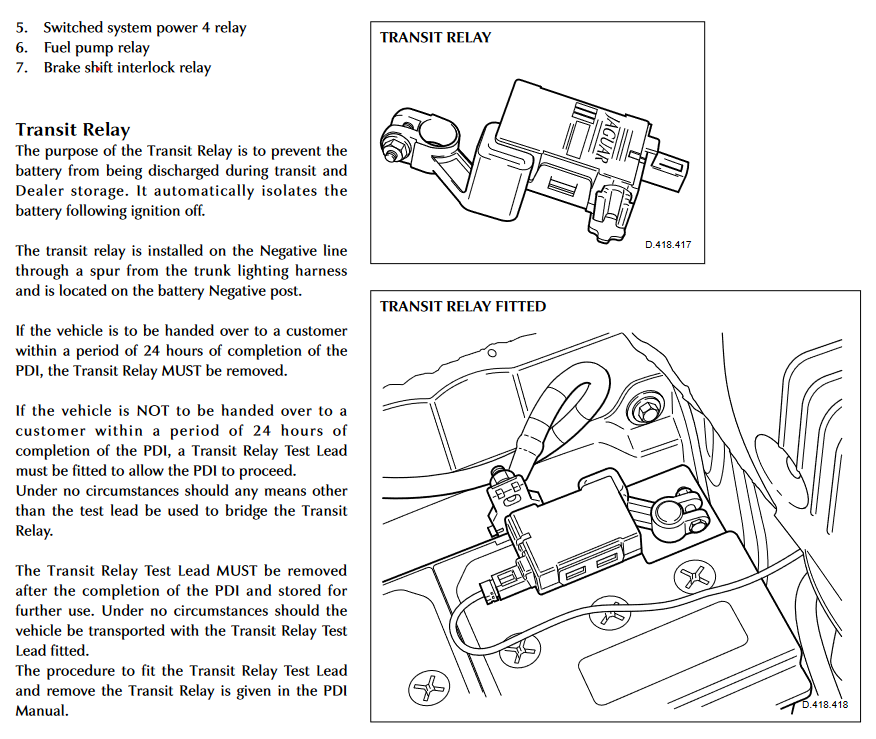

More details here:
http://www.jagrepair.com/images/Elec...troduction.pdf
See page 90 of the PDF. That guide is for the early models, but 2003+ was similar.
In the lower illustration, note the small connector. That's what you're seeing. Once the relay was removed at the dealer, this wire was supposed to be tucked out of the way behind the carpet. The fuse for this relay was also supposed to be removed. On 2003+ models, that's fuse #50 in the rear power distribution box.

A true "Drop the Mic" moment!
Thanks for the image and the effort! As for me, I feel a lot better knowing what this is, why it was there and that it is okay to just "hide it under the carpet"!
