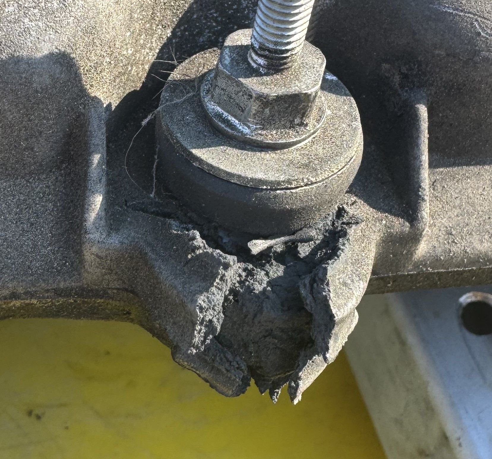

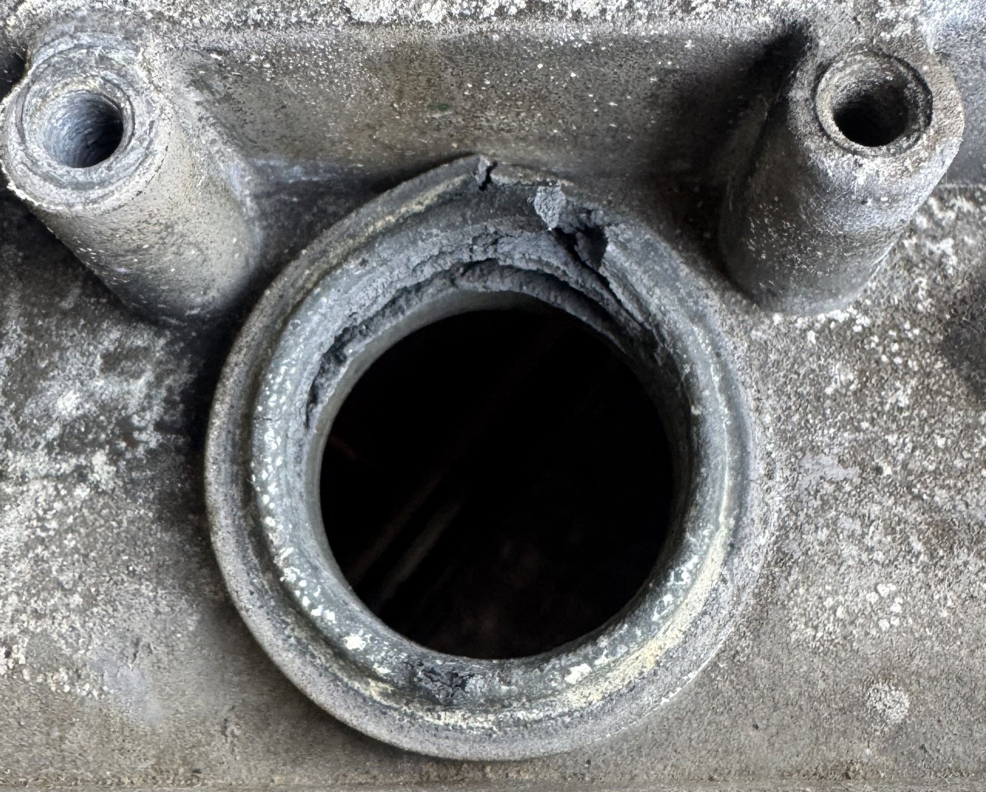

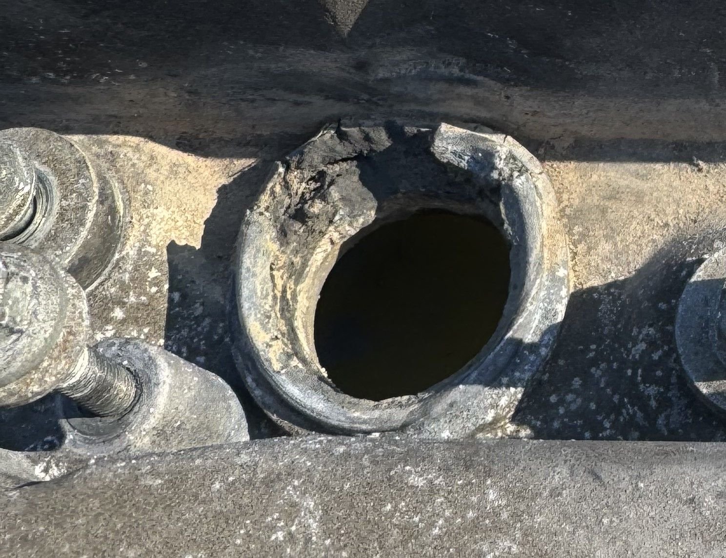

Pit Crew, I'm in the process of going through a hand-me-down Base S-type. The 3.0 is still strong, but suffered a few misfire codes. New packs and plugs solved that,
but also uncovered some oddities.
The valve covers look melted in some spots, include a spark plug tube, and a hold-down point. I'd first misidentified the spark tube as a little o-ring gasket, given it's blackened look.
Any ideas? I'd thought it might be a bad coil pack running current through the cover - but did not see signs of that type of failure --- I did see rust and water in the spark plug hole and so wondering if I'd had a coil/plug current leak conducting through water and finding its way to an outlet ?

I've since read Peter's (Peter of Australia!) note regarding these being magnesium vs my uneducated identification (aluminum)..
Still wondering how they're failing in these particular spots. PofA's note is informative, and so I'm reading more on the subject this morning.

Yes a common problem and it would have been so much better if they had used Aluminum instead.
Here is a aftermarket Aluminum one and I would just dump the OEM junk and fix it now. It will only get worse and worse with time.
Replacement Valve Cover Replacement Valve Cover
I mean for $85 each side that's not too bad.
Here is a pair for $215.
Pair of Aluminum Valve Covers Pair of Aluminum Valve Covers
If you look there are a number of them out there because it is such a prevalent problem.

Yes, that is galvanic corrosion, where Magnesium is the sacrificial element in the vicinity of aluminium and steel.
Back then I wanted to make sure that when that happens to me again I would not be in a situation, where those cam-covers cannot be bought anymore, thus I bought heaps of those cam-covers on Ali-baba to make sure that my two 3.0L S-Types will not face cam-cover-shortage. I asked the guy on Ali-baba, what the material of his cam-covers is - he was not 100% sure, but he thought that it is still an alloy of several metals, and that they are still containing magnesium.
Yes, I saw that the listing of Clubairth claims that those cam-covers are aluminium, but I would not be surprised, this they actually do not know, and that those cam-covers are coming from the same source where Ali-baba had them from. Thus, even those cam-covers may still contain magnesium, possible less than the OE parts.

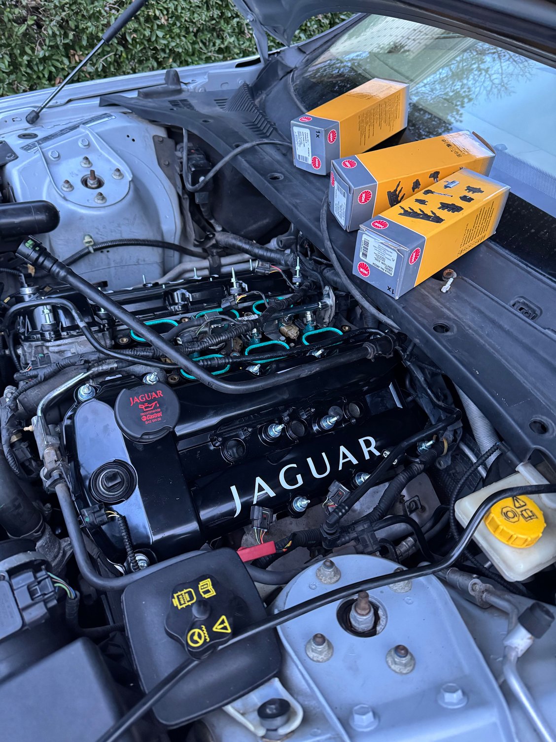

We're on the mend. I went the extra bit, and had a vinyl stencil made for the valve cover. New ignition coils and plugs have solved the misfirings and all codes are cleared. I have only the pesky "brake assist failure" lamp to contend with. Sure feels bright under foot I'd have to add. To Peter, hope your ANZAC Commemoration was grand.

Looks good. My S-Type actually has a big decorative plastic cover covering all of the cam cover on the left, i.e. on mine that JAGUAR lettering would not be visible...

Mine does as well, Peter...just the added touch hiding under the plastic cover for my own amusement!
