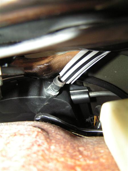

Here is what you are looking for. You will need to do this mostly by feel because it's hard to pry everything apart enough to see. Plus you don't want to damage anything or kink the head liner.
The hose has very heavy ribbing on it. On my wife’s 2003 LS the hose appears to have shrunk in length a bit and I had to use a small worm drive clamp to keep the hose from pulling off again. For some reason the S Type does not suffer from these hoses pulling off but they can and do get clogged occasionally.
Attached Thumbnails a waterfall inside - sort of...any idea ?-sunroof-drain-unhooked.jpg
