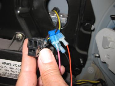

What are all the wire connectors in the boot?
Took the carpet and trim off the right side of the trunk to access the parking brake contol module. Stopped dead in my tracks because of some non-factory wiring that had been spliced in. Looking closer discovered many unused factory wire connectors. Need help identifying these things.
I'm thinking that the non factory stuff is from a DVD/Navigation system because some of the cable ends look like video, and because one of the non factory cables goes around to the stero amp/CD changer side of the car.
Does anyone recognize any of this?
On the factory side, what are these connectors for? Other factory options I'd guess, but can anyone be more specific?

Factory connector #1 is for the optional rear power accessory point. (You could add a lighter plug in the car)
Factory connector #2 is for the CATS suspension model, but your car doesn't have it, it would sit next to the EPB module in the trunk.
I can't really tell what factory connector 3 is, where is that harness relative to the car.

Awesome info! Thank You! It is all history, coming out right away. My S-type is lightly optioned. So, I'm not surprised to find unused connectors, but since I'm trying to chase down an electrical issue, knowing what they is VALUABLE knowledge.
The third factory connector is inside the trunk just below the right rear tail light. I could get a photo of the inside of the connector if that would help.

You should see the butcher job someone did to put one of those old school wired phones into my SL. Straight house wire nuts to tap into the wires, after cutting the factory ones LOL!
