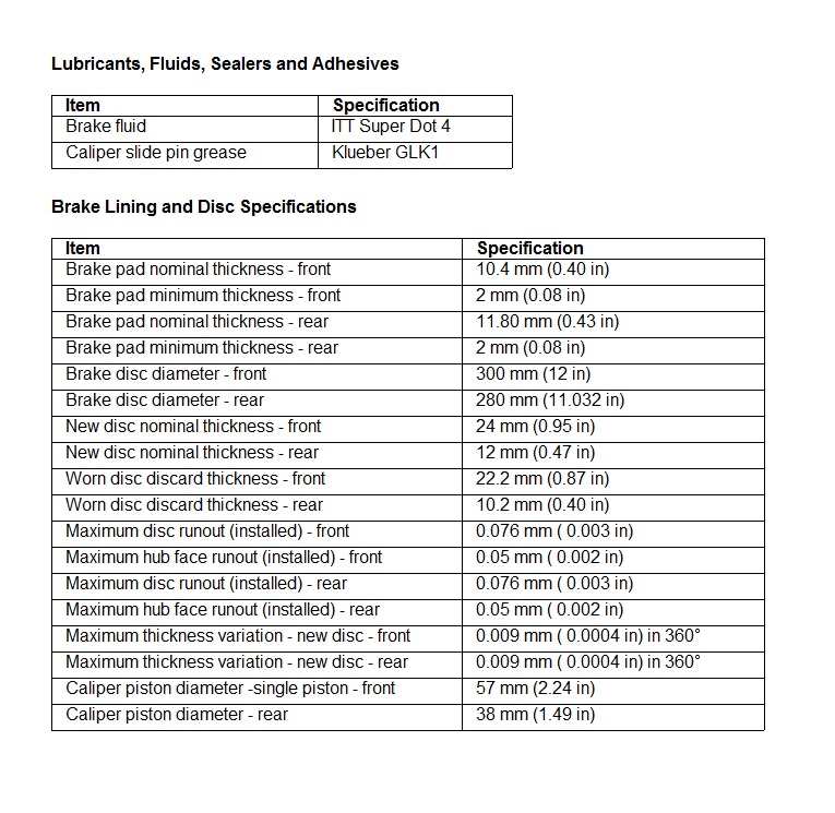

Originally Posted by peteranne
Thanks guys, will stick to the fluid pad change for now, maybe the discs just need to be scrubbed by the pads to brighten them up.
Light surface rust is normal if the car has stood after washing. It disappears with the first application of the brakes.
Heavy Scoring or pitting is not acceptable as both reduce the surface area of pad to disc contact and consequently reduce braking efficiency.
Here is the JTIS specification for the X-Type which will help you assess wear on pads and discs:
I'm always surprised Jaguar quote such a low minimum thickness for pads. I change them when they get below 5mm.
