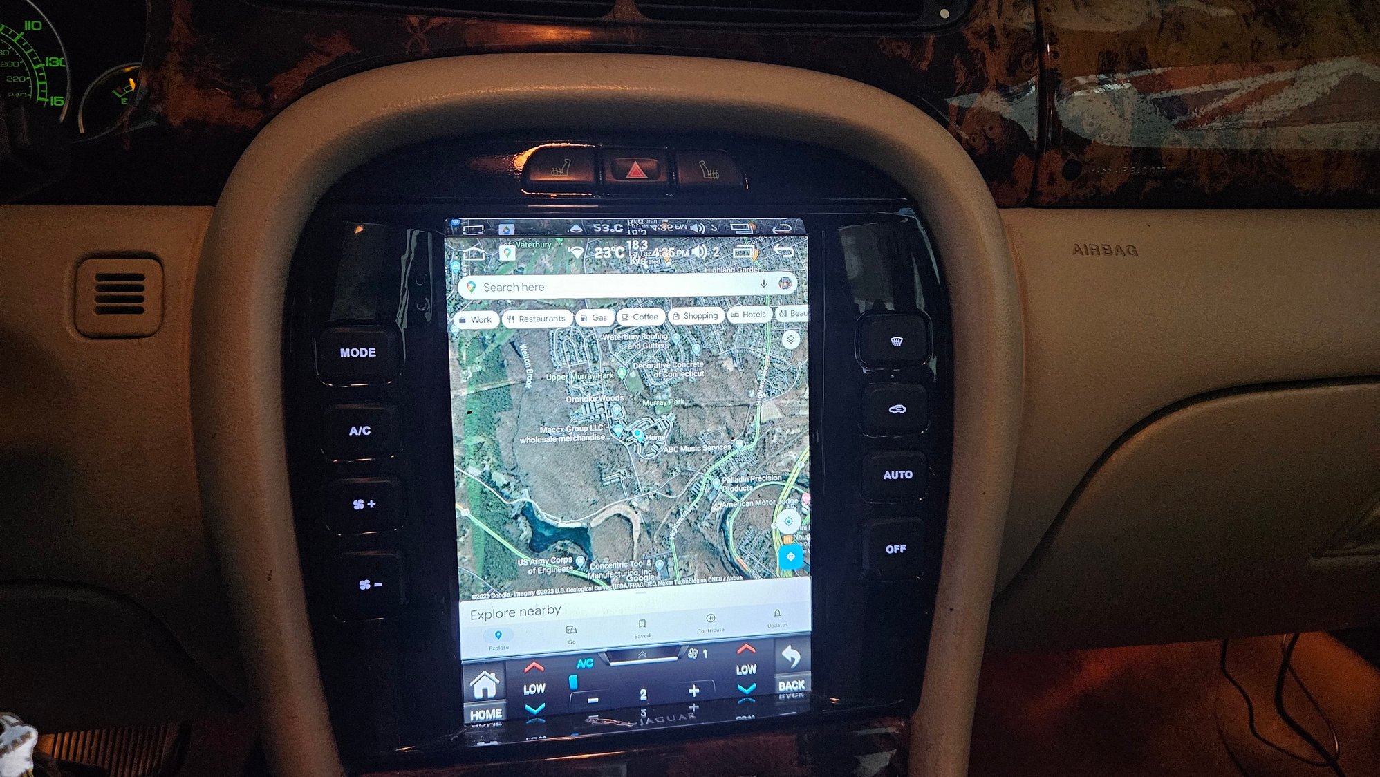

So I'm more of a Oem look enthusiasts but my headunit took a dive, so i updated to this i had Jagdroid and that died so this is the only one that works for me here's a video of it in action
buttons look stock so it's not that bad looking

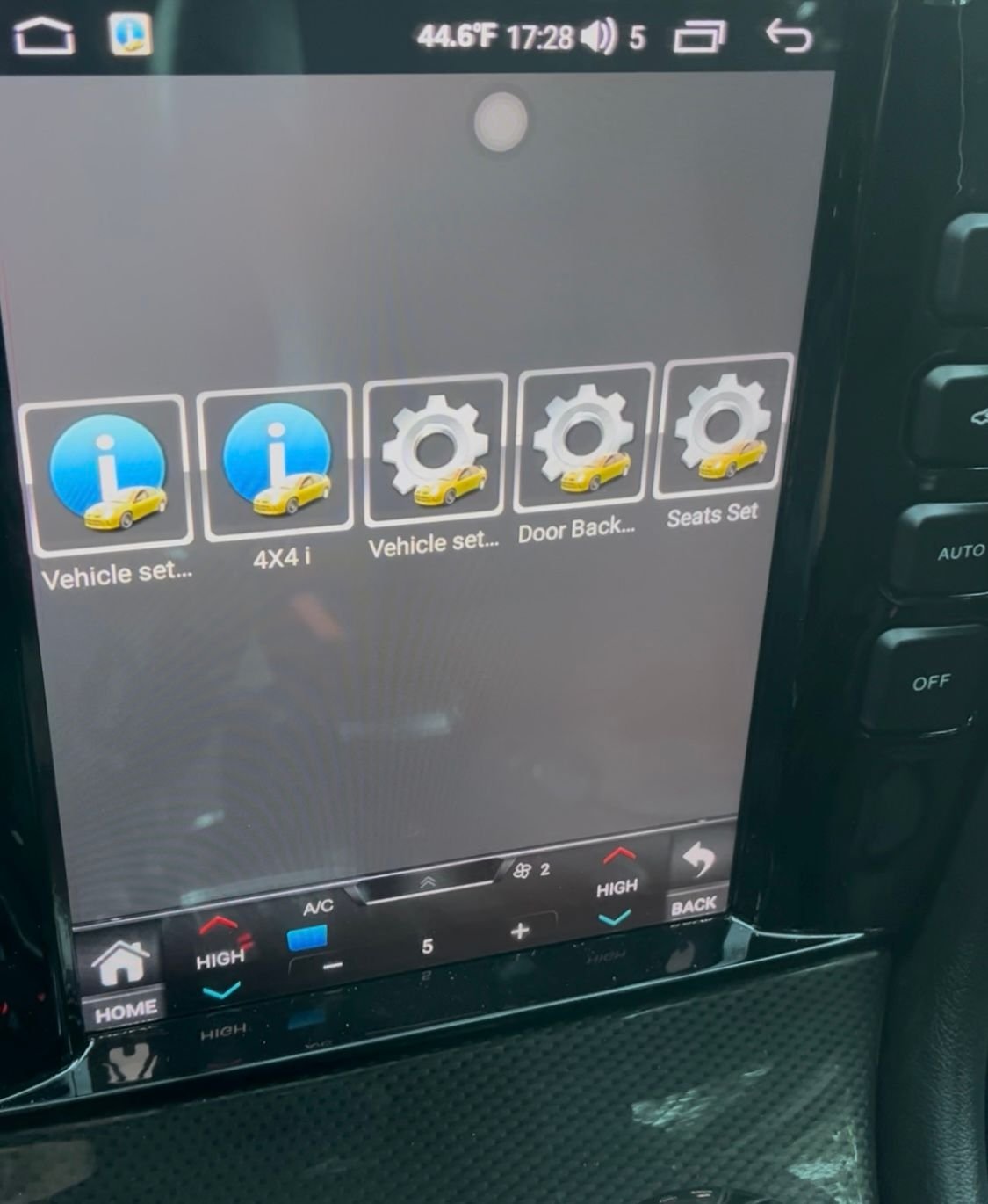

may i ask you a technical question which i think only you can answer?.
maybe 40% of the times i turn the unit on i get the screen you see below, there seems no pattern as to when it boots to this screen or the regular home screen.
i have been texting with the suppliers tech team who have been helpful with other issues, but after several texts on this issue they are now saying this is normal. that doesnt fly with me at all, especially due to the random nature.
its not the end if the world but it is irritating for such an expensive item...any input?...

just heard back from them, they say next time it happens there is a "trash" icon and i should attempt to delete that background application.
i just tried but of course it booted up normal lol.

The reason that comes up is due to low battery voltage, especially if you do small trips
and the alternator didn't get chance to fully charge your battery

thanks dennis, i have a brand new battery in the parts car, i'll swap them over and see if that helps

You got it my friend, if you can fully charge to around 12.6 Volts or drive for 30 mins to top it of
should help in these cold months, to get Canbus network in line
