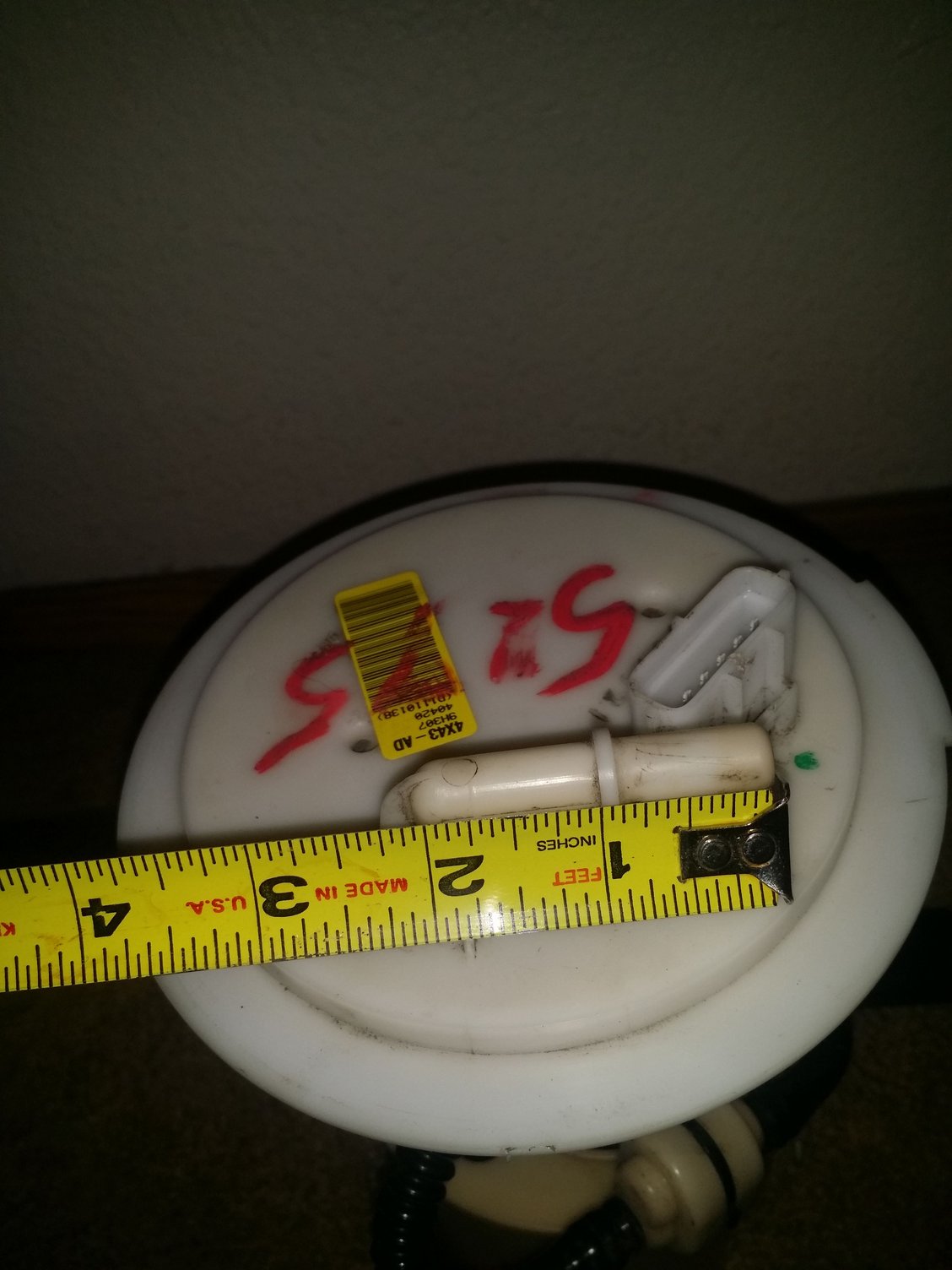

Hello fellow X-Typers.

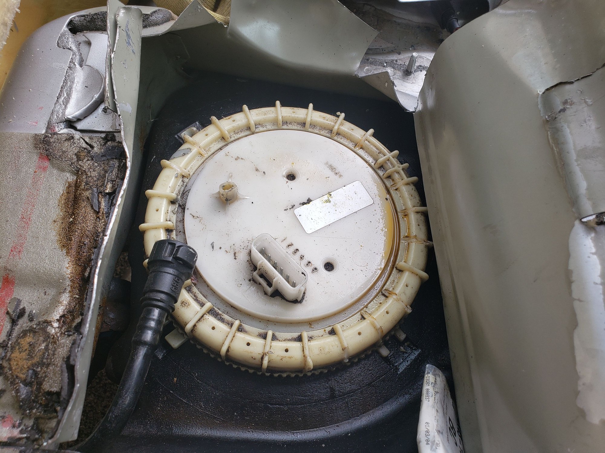

Last week i went over a hump in a friends yard and broke the plastic tube coming from the top of the fuel pump casing that quick connects to the tube that leads to the tank side of the fuel filter. see picture.
does anyone have / or know where to just order the exterior casing? - my fuel pump itself work fine .
Thanks in advance
Comer..

That's not the exterior casing, that's the "pump" insert.

Absolutely. But I believe it's a solid piece on the top under the plastic ring. I was wondering I it's possible to only purchase the top only ? Can't find that part only anywhere

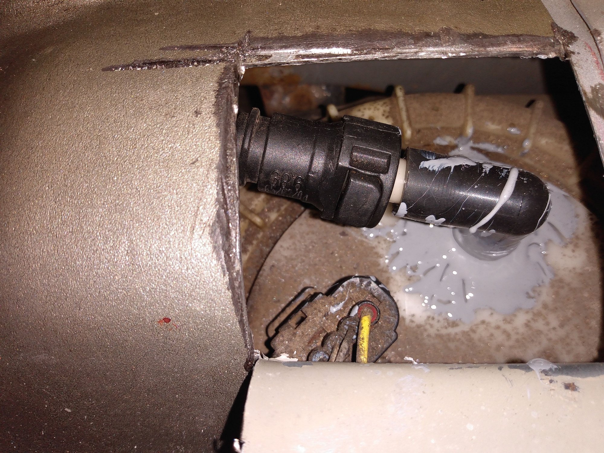

I was finally able to get to the issue this weekend. the elbow was broken exactly at the elbow. I was able to sand down most of the pertruding edges of the lower part and placed a PCV elbow and some Permatek Motoseal ( petrol resistant) to seal. see below.
What do you think?

Interesting solution. I hope it works for you. I just replaced my fuel pump for about $55.00 on ebay. You posted part of this, the pic in your first post in that thread. It looks like you already have done the work around to get access, if that doesn't hold, replace the pump. Your mostly there.

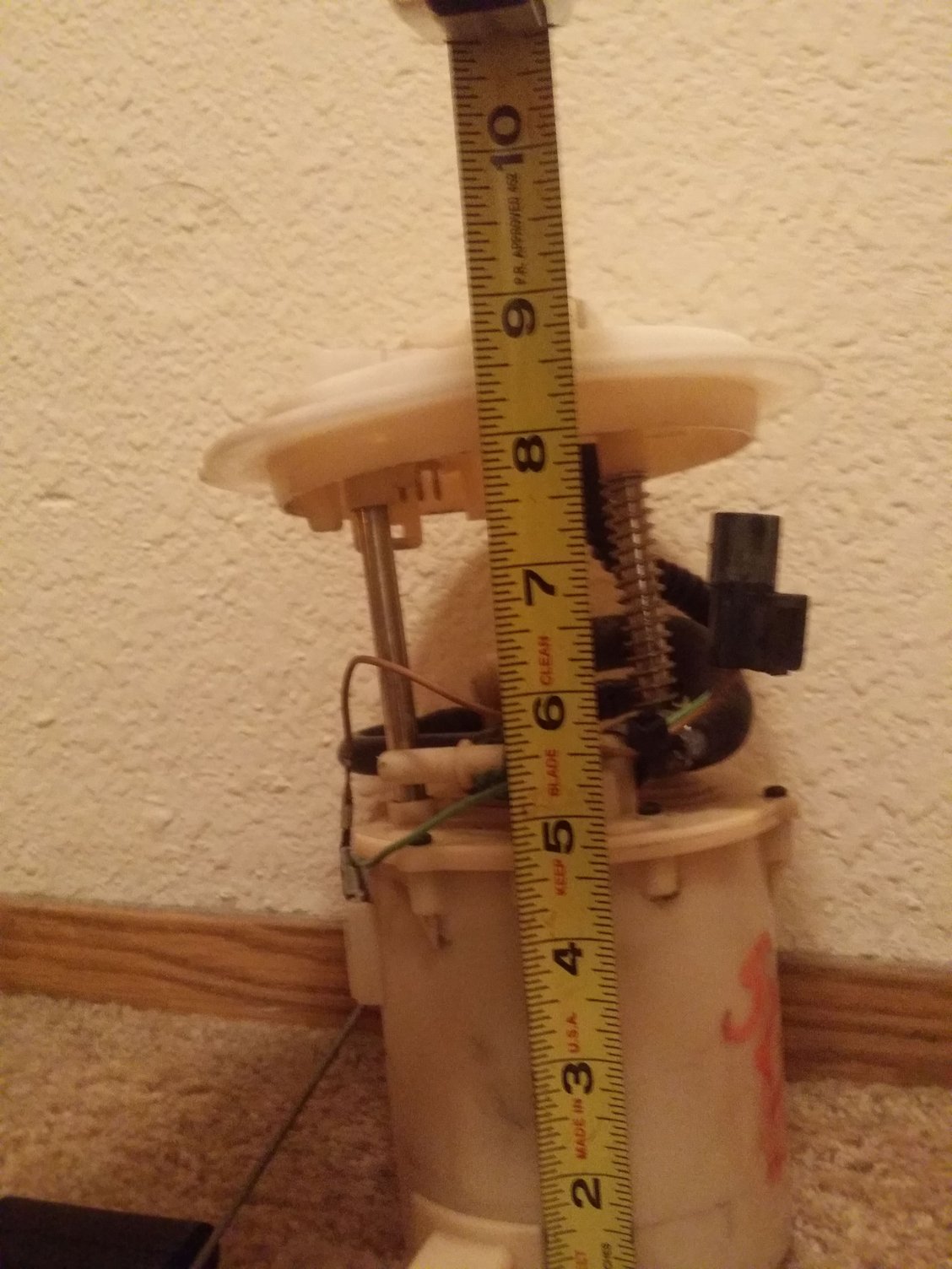

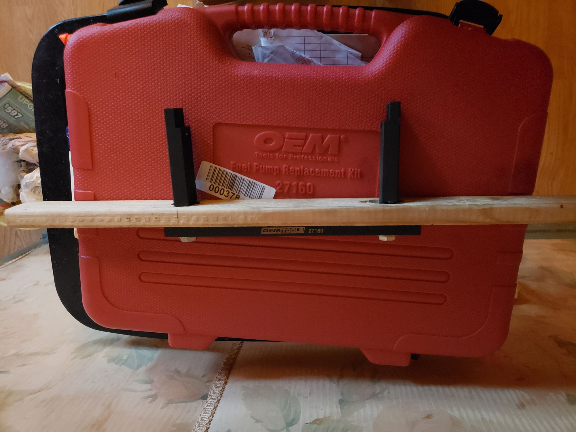

And a mighty fine thanks to Dr.Dome for offering a second canister w. Pump at a more than fair offer and shipping was super fast...

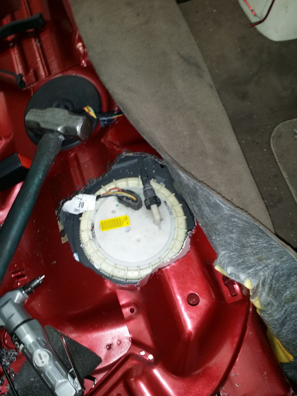

So after oscillating sawing the opening and a few quick wha is with a punch n hammer the ring came off nicely..
Not the best tool to use...
the seal seemed to be in great shape sooo. I'm reusing it..

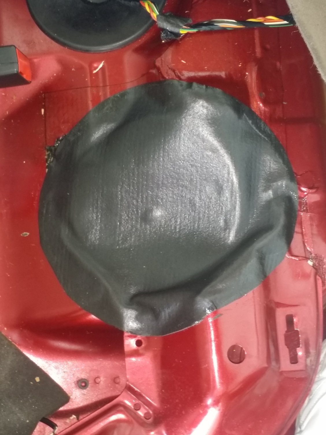

Old Jan 1, 2020 | 08:28 PM

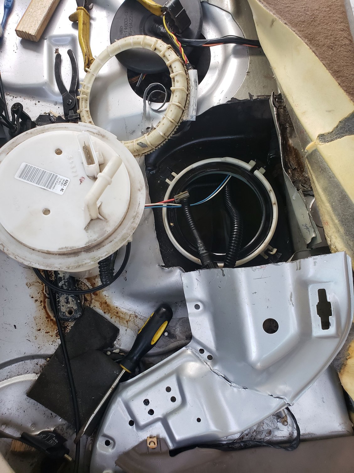

I always wanted the fuel pump access from inside the car but Jaguar did not offer that option. (like the X200 and X350)
We always had to drop the tank assy.
If it was my car I would likely do it that way but customers don't always want the car cut and 'modified'.
Glad you found a solution.

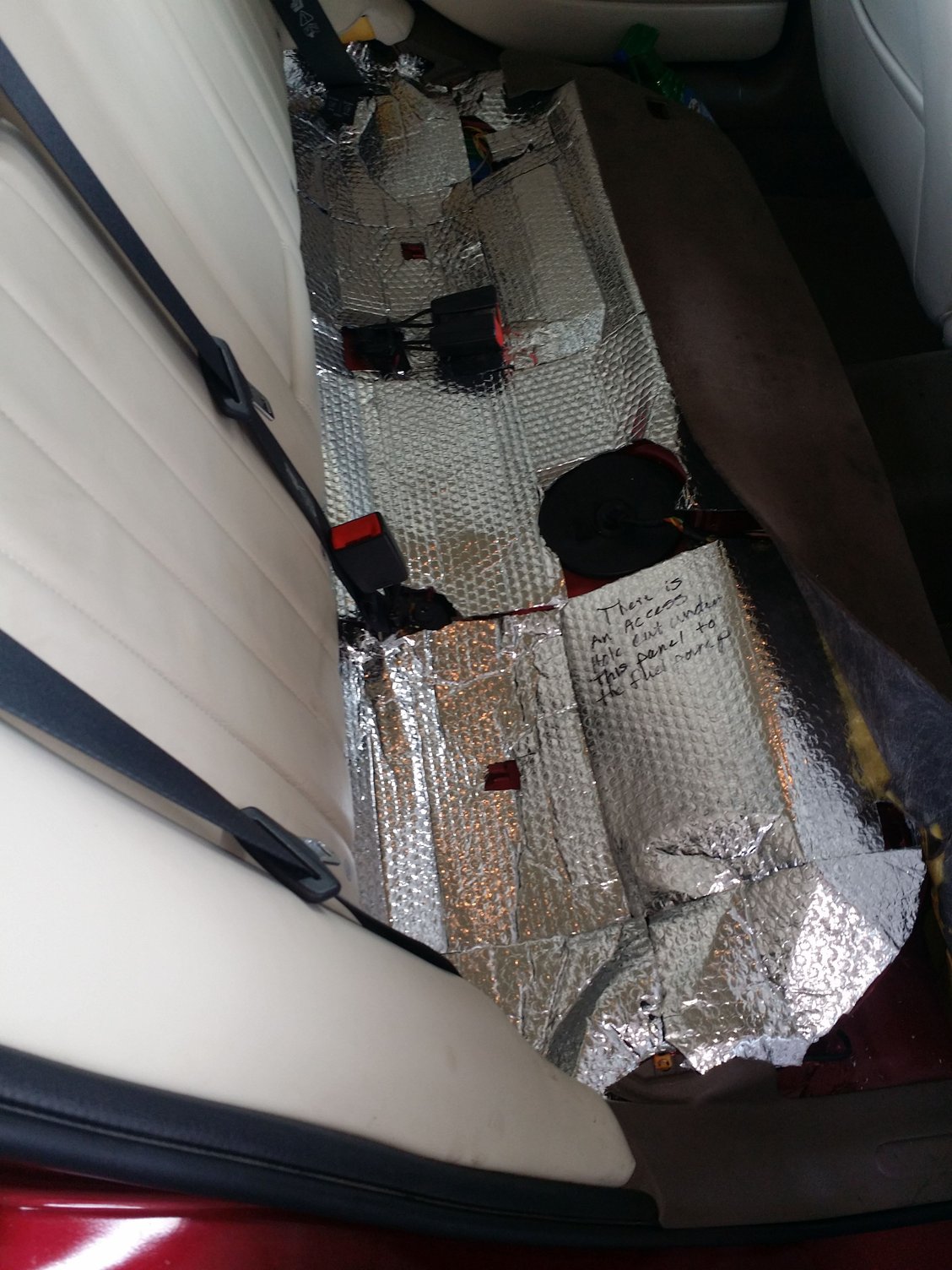

That's how I did it. Before and after pics =
