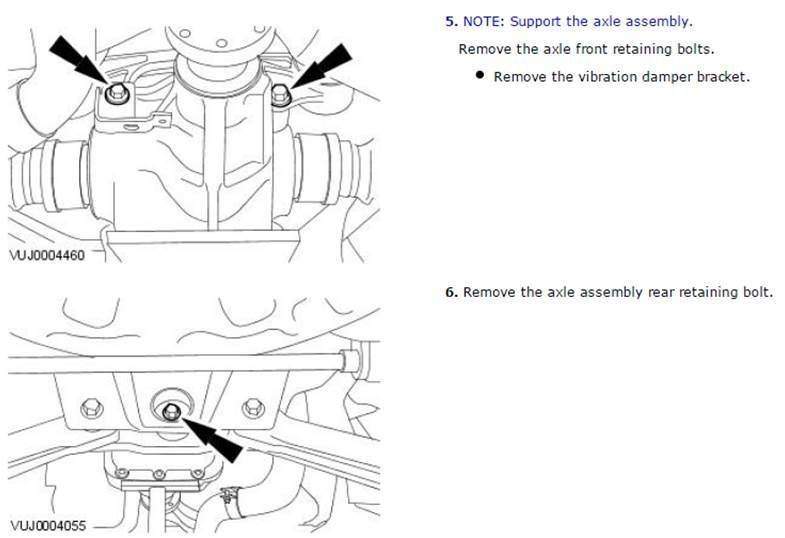

The JagBits link you have is for a dog bone shaped metal bracket that bolts to the frame and to the differential. It is used so will likely come with used bushings. There are 2 bushings in that part where it bolts up to the unibody, Jag part number C2S17304 that are available. I would call that the "rear differential front mount".

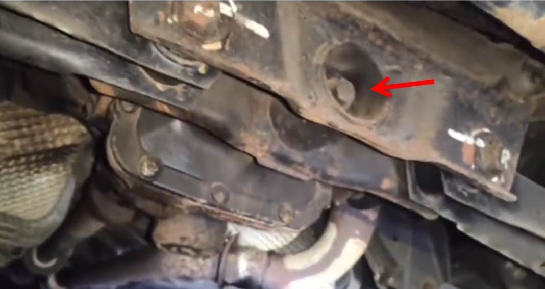

There is another mount in the rear center of the diff that bolts to the unibody. This is what I would call the "rear differential rear mount". I can't find that bushing in any parts diagram. No idea about substituting another bushing in there.

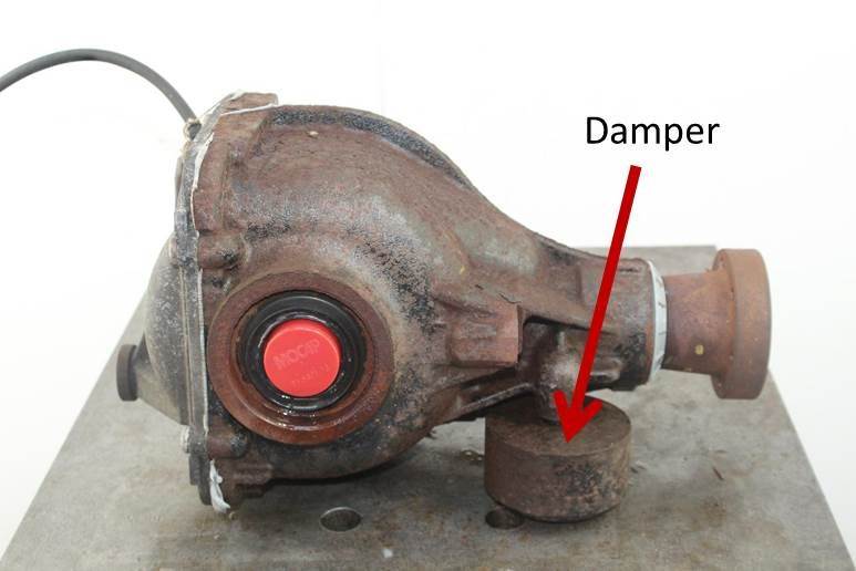

Thanks. I'm not sure what the difference is between a "damper" and an "insulator" might be:
https://parts.jaguarcary.com/oem-par...lator-c2s17304
https://parts.jaguarcary.com/oem-par...amper-c2s23949
Is one on the top and the other to the rear of the differential housing?

The "damper" is just a slug of steel that hangs off the differential. The size and location cause it to damp out some unwanted vibration. That "insulator" could be what you need. Can the Jag dealer parts department confirm it is the "rear differential rear mount"?
