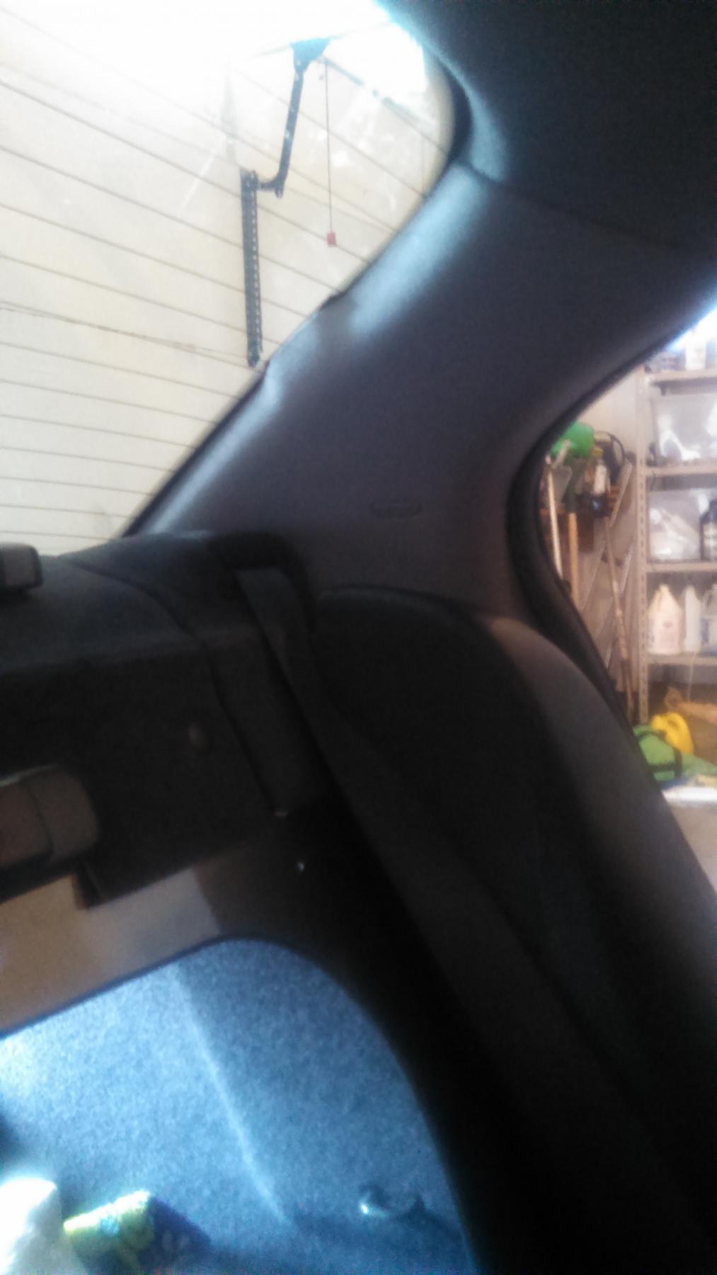

THis pic shows the back rest down looking into the trunk from inside the car. I don't have a picture of the pull latch in the trunk.
If your back seat rest is "fixed" then you will need to remove the bottom cushion and then remove the screws that mount the back rest to the frame to remove it.
